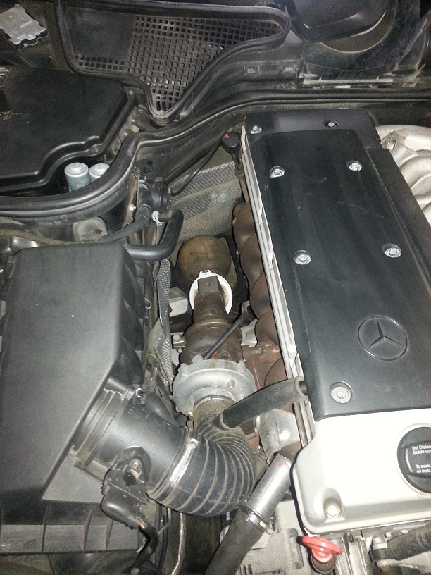

is putting a turbo just bolt on ? for a Holset HX35 turbo do I need change the exhaust manifold? this car is stock, should i do the super chip to it?
i think i would like 350 hp what else will have to be changed?
thanks, sendo

The stock turbo and exhaust manifold mate to one another with a unique triangular flange with 3 bolts/studs. The hx35 (and most other turbos) use a rectangular 4 bolt flange so it is not bolt-on.
I don't have experience with the chip tunes but I know the stock exhaust manifold will perform poorly (high back pressure and EGT).
My opinion is to try to improve the efficiency of the intake charge air with bigger/better intercooler, chip tune, EDC maxed out, water/meth injection, etc. before swapping out turbos & custom manifolds.
The modest increase you'll get might satisfy your desire for more power but it'll definitely be cheaper than custom manifolds.
