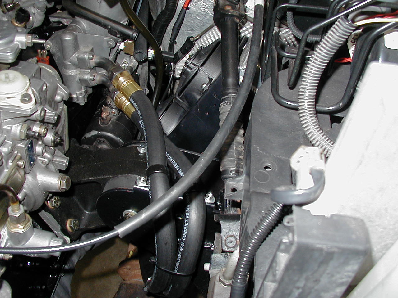

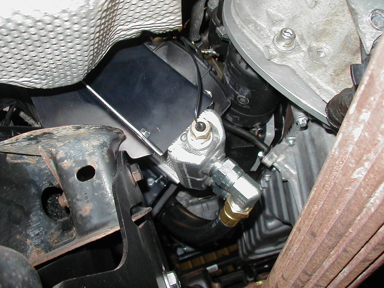

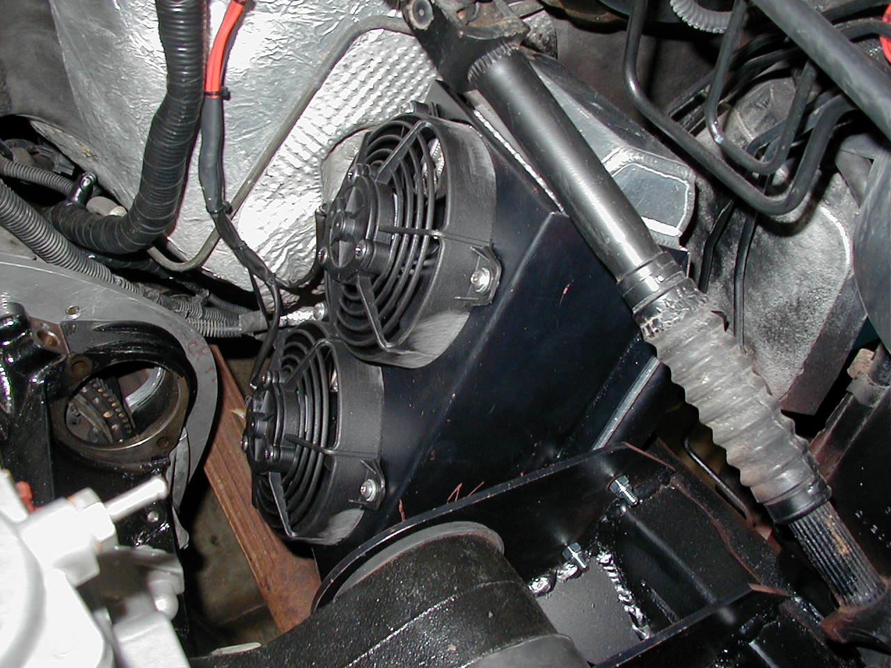

11-15-2016, 11:25 PM #15
(11-15-2016, 06:05 AM)50harleyrider Hey Zeeman, I see your cooler hoses curl back under the MM's. Got any photos and descriptions of the setup you used and where you located it? My F150 is getting really busy up front with radiator, ps cooler, tranny cooler, AC condensing unit and intercooler + boost piping so I need to look at some alternate locations for the engine oil cooler. What's your feel for the water to oil coolers like post #2 in this thread? I could then tee into the heater hose and wouldn't have to worry about a thermostat or location of the cooler in the outside air stream.
I don't like the style in #2, I don't feel they cool  enough and they are hard to convert off the block. Enclosed are some pictures of the one I installed on the 07 Jeep JK I did. There was no room in the front so I put it to the back of the wheel well so it could get air via the electric fans. They are controlled by a temp sender in the cooler.
