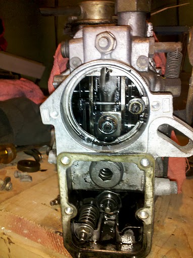

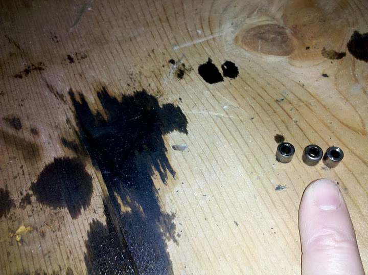

Whats this in my M pump? - winmutt - 02-04-2011 Poop. I've been getting ready for a few months to swap the pumps out tomorrow. Looks like I will simply be adjusting the timing for now if it needs it. What do you guys think these are? I was getting ready to "touch" my pump and I spied one of these puppies on top of the banana looking thing in the governor. I found 2 more in there. Everything seems to function ok on the pump. I was able to turn it without issue. Going to see if the seller will ship me another one. This is my pinky for comparison. Also the washer behind 2k in this image was loose. Check out the loose pin right above 2k : RE: Whats this in my M pump? - E300TSC - 02-05-2011 They look like the wheels that ride on the cam... Maybe? Put a mic on them and see if they're slightly different in diameter. Are they bearings? RE: Whats this in my M pump? - ForcedInduction - 02-05-2011 2K will only have tension when the engine is running. RE: Whats this in my M pump? - winmutt - 02-05-2011 (02-05-2011, 06:49 AM)E300TSC They look like the wheels that ride on the cam... Maybe? Put a mic on them and see if they're slightly different in diameter. Are they bearings? They do seem to be slightly different in size, I could see that with my eye. RE: Whats this in my M pump? - dude99 - 02-16-2011 did you ever figure this out? You had me curious.. RE: Whats this in my M pump? - winmutt - 02-16-2011 Waiting for replacement. |
