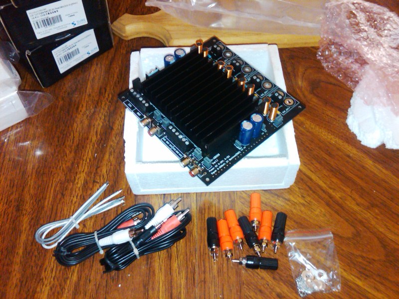

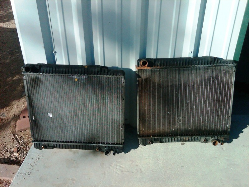

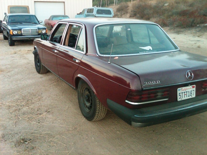

08-24-2010, 01:35 AM #74

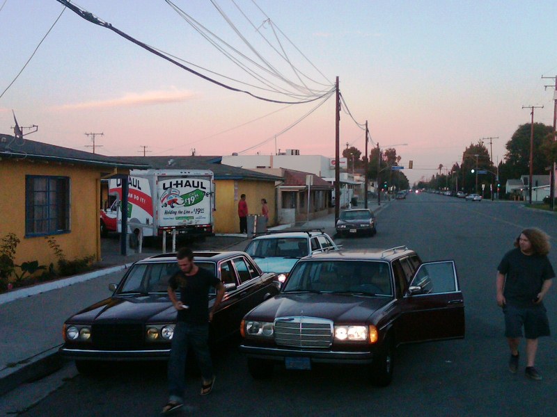

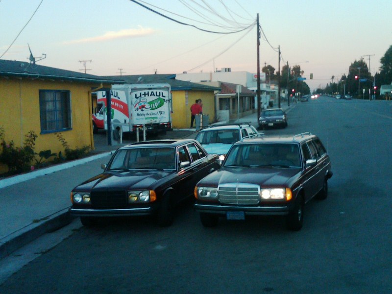

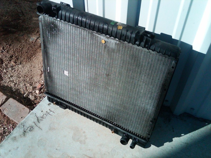

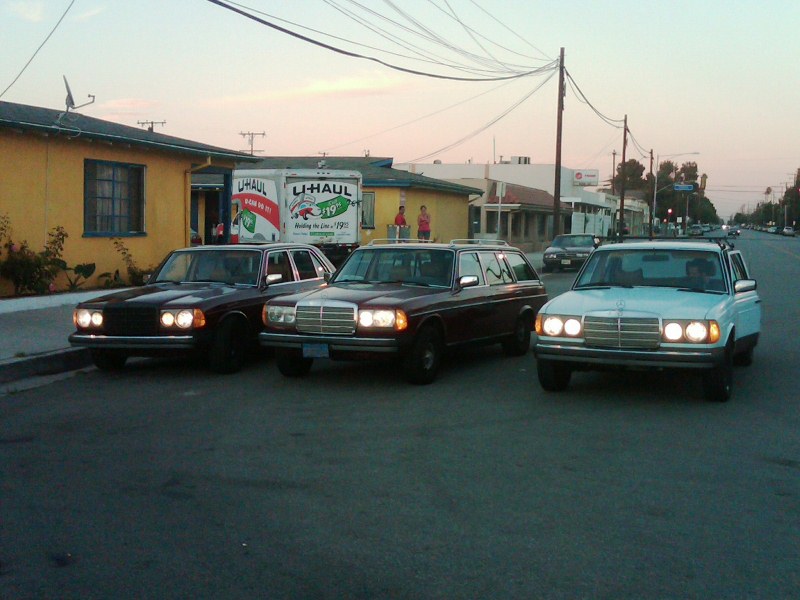

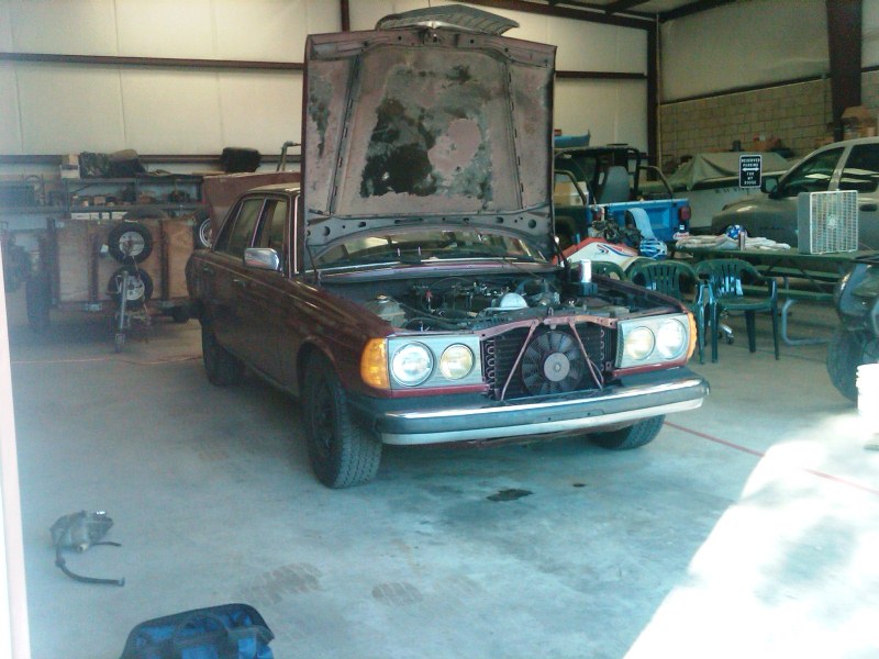

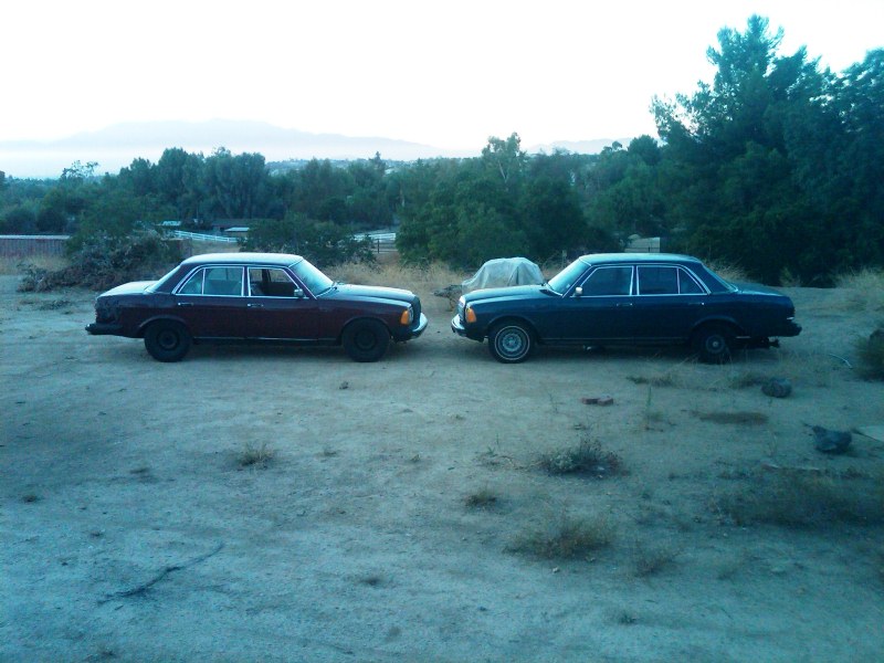

Did some crap over the weekend...
The Tank and the Parts Car (Blue Thunder) meet. The parts car makes the tank look like a car that could win a best in show award.

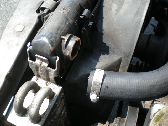

Took the radiator from the parts car and swapped it into the tank because there was a leak where the plastic was attached to the alum. core.
Did NOT &*@$^@% get the bad ground figured out.
Blew one of the heater hoses doing 80mph on the freeway which pegged the temp gauge within seconds.
Switched the feed and return fuel line which resulted in more power and less smoke.
Finally changed the oil and filter.
Met up with Garage and Stan Because we all missed the cruise on Saturday. (non of us would have mad it anyway). We are like the three freaking stooges.... Garage and I met up with Stan to drop off a couple wheels from the parts car because he keep popping tires. So we get there and he puts the tire on. Garage's battery is dead so he's not starting, And my ground is no good so I'm not starting either. Stan starts Garage and then they both team up to start me lol. Then while Garage and I are on the way home my hose blows so we pull off the freeway to figure out whats up and while waiting for AAA, Garage shuts his car off. The battery is now beyond dead so we have to bump start. Guess he gets the alt from the parts car lol... What a mess we all were!
Garage on left, Stan on right.
Got This Sweet little 4 channel x 100 watt amp I'll be using for the front and rear speakers; Plus a digital voltage meter and two temp meters. Each meter has two sensors so I plan to use them to read water and air temps (before and after cooler) when the A/W Intercooler is done.
This post was last modified: 08-24-2010, 01:43 AM by Captain America.

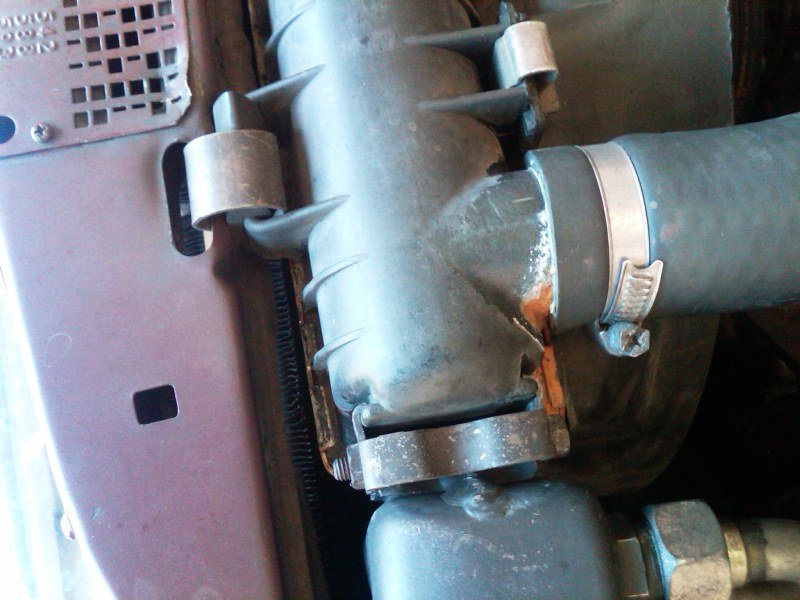

08-24-2010, 07:19 AM #75
hahaha, You guys are funny.
The only thing that would have improved that would be if garage and stan swapped batteries while the cars were running for a nice charge up on stans wagon.
You all remind me of myself getting various unroadworthy craigslist purchases back to my place.
I like those two guys in the background, you can almost read their minds. "WTF are these guys doing?"
You should switch to some wider hose clamps on the radiator, lots of people have had problems with the narrow MB clamps causing neck failures on the radiators. (although mine failed with a wide clamp 300 miles after I put it on, but the radiator was tired anyway. might just be age related)
This post was last modified: 08-24-2010, 07:20 AM by JB3.

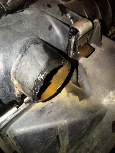

this is what I mean by neck failure. The old plastic gets really crumbly and saturated looking after 30 years. Mine looked more like graham cracker than plastic-

(08-24-2010, 11:20 AM)dropnosky this is what I mean by neck failure. The old plastic gets really crumbly and saturated looking after 30 years. Mine looked more like graham cracker than plastic-
Holy crud! That's no good. The newly installed radiator looks to be somewhat new, so I'm hoping that doesn't happen anytime soon.

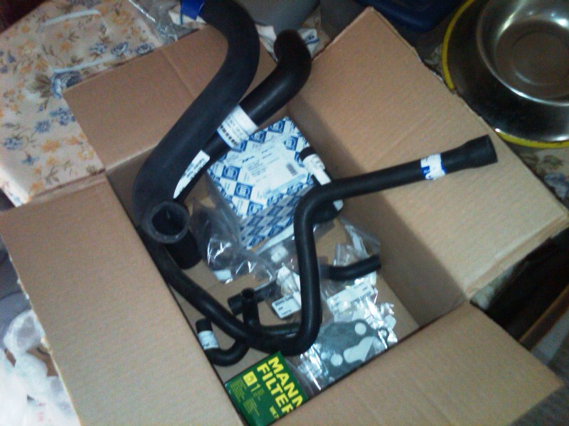

08-24-2010, 10:35 PM #79
I love Parts Geek! Ordered yesterday and my stuff arrived today. Big Grin
While I'm replacing all the hoses I want to replace all the freeze plugs. Anyone know how many there are? I only see four. And the two that are leaking are behind the oil filter housing and the injection pump Dodgy I got a new oil filter housing gasket to do that one, but i guess the question I have is how difficult is it to pull the injection pump and re-install it? Are there any adjustments that I should make while its out? Any tricks you guys can share? Rudolf??? I know you have done yours a couple times...

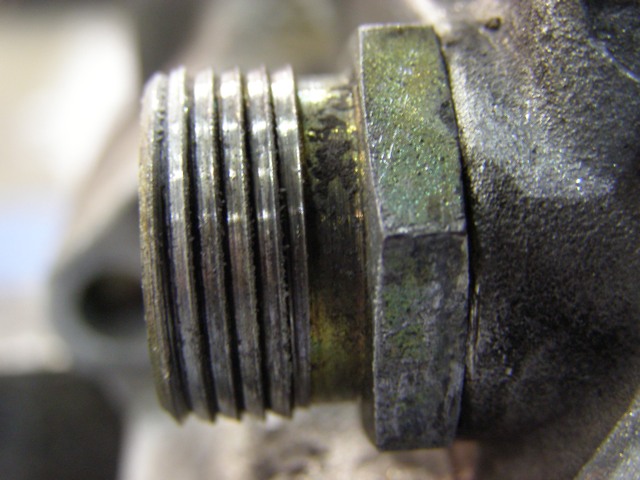

The problem with the oil cooler lines is that (iirc) they are only 15ftlb to tighten. Everyone, my self included, over torques them.

(08-26-2010, 09:08 AM)winmutt The problem with the oil cooler lines is that (iirc) they are only 15ftlb to tighten. Everyone, my self included, over torques them.
Gotcha, Things like that are easily over torqued....

And don't forget that lube (antiseize) increases the torque value with less effort.

(08-26-2010, 05:20 PM)ForcedInduction And don't forget that lube (antiseize) increases the torque value with less effort.
Yup. my hope with that is the lub/antiseize with keep the threads from galling like that even with a tad more torque.
Dude, you nailed it!!! Looks like this radiator has already been victimized.

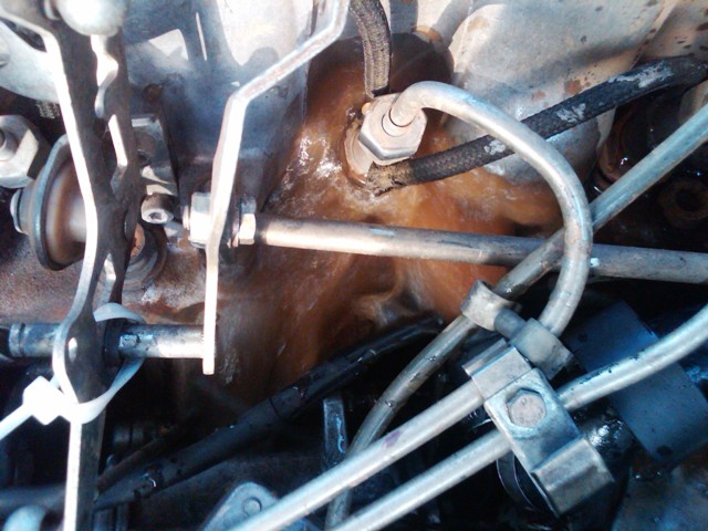

And this is a pic of the tail end of the flush...
YUCK!
