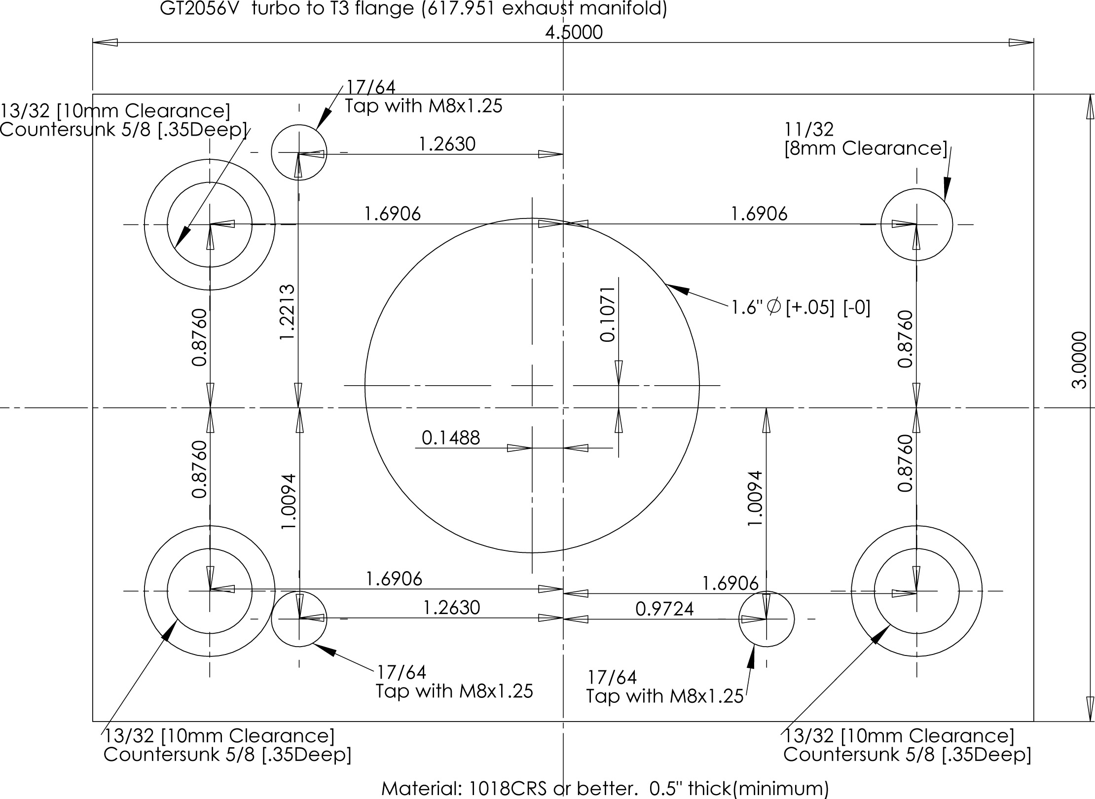

I've made up an adapter using Bryan's dimensions(Friendly hint:It's easier for machinists if you dimension everything outwards from the center of the block)

Simpler=Better I've made up an adapter using Bryan's dimensions(Friendly hint:It's easier for machinists if you dimension everything outwards from the center of the block)Threaded. I had to put the studs in a vise and turn the manifold.

It's all good. If I get bored at work one of these days I'll post "formal" drawings of all the parts
EDIT: I've attached a drawing with dimensions from the center of the T3 stud holes. Yeah I was kinda bored :roll:

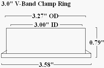

(09-25-2009, 03:53 AM)Kiwibacon Did I mention I have solidworks and a whole collection of turbo adapter designs already?Could you make a T3 to 3" V-band?
It's pretty quick to crank out another if you guys provide some measurements.

(09-25-2009, 10:26 AM)Tymbrymi(09-25-2009, 03:53 AM)Kiwibacon Did I mention I have solidworks and a whole collection of turbo adapter designs already?Could you make a T3 to 3" V-band?
It's pretty quick to crank out another if you guys provide some measurements.![]()

(09-29-2009, 09:12 AM)Tymbrymi(09-25-2009, 05:18 PM)Kiwibacon Which end of the T3?
Going from the T3 on the exhaust manifold to a v-band for the 6.0L Powerstroke turbo.

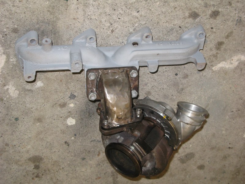

Nice work on the GT22 adapter!

(09-29-2009, 02:03 PM)Kiwibacon Get me the measurements for the V band flange and I'll see what I can do.

(10-05-2009, 11:32 AM)Tymbrymi The adapter would need to make a 45 degree angle upwards in order for the turbo to fit (I think)... Coming out from the manifold a bit is cool too. Thanks!

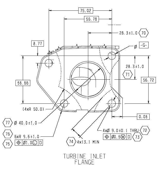

(01-22-2010, 01:07 PM)cell has anyone worked on an adapter flange for the electronically actuated 2256v? or has anyone found dimensions for it anywhere?I started working on one and got as far as having a CAD file for it, never found a place to get it made for a reasonable price tho. I know theres a few other people that have/are working on one...

are you interested in sharing that CAD file?
