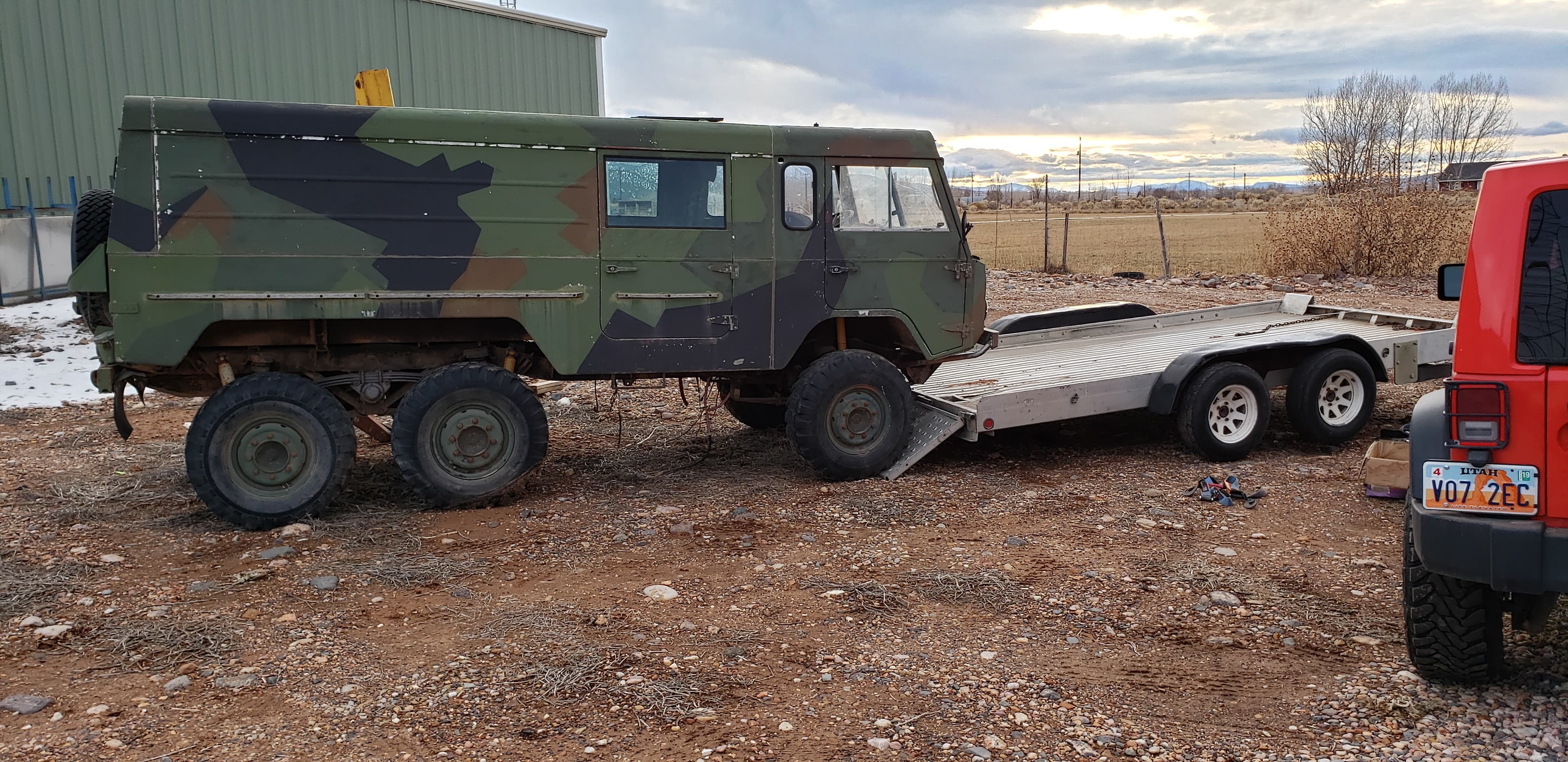

Here is my new OM648 swap candidate!  How has everything turned out with the w123?  Would love to see a few more pics and vids!!
