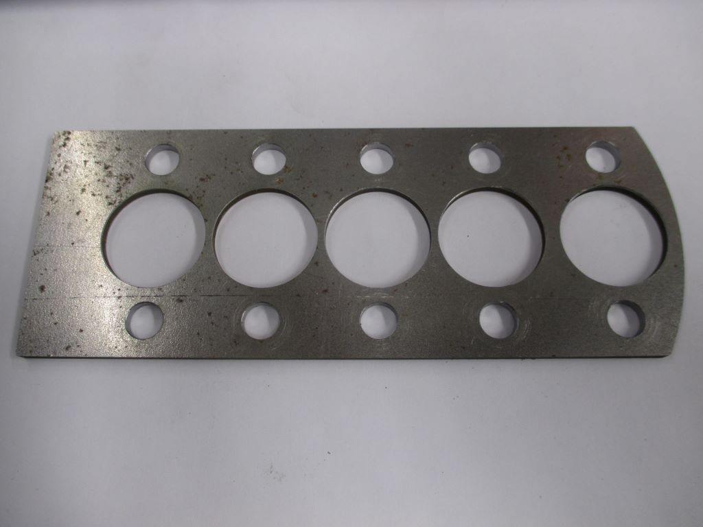

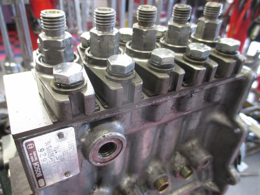

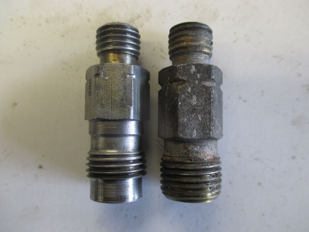

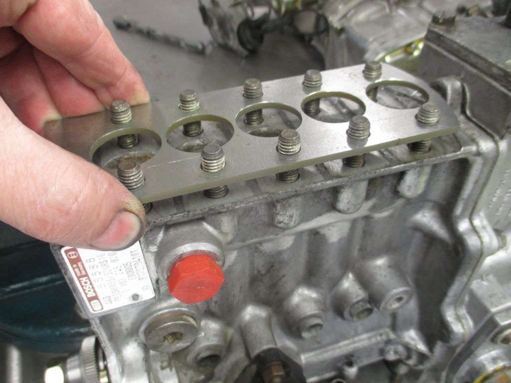

Update, So far, this is what I have.
30pc 8mm MW element ready for machining.
25 gasket kits PES5MW RVW on its way
20 watercut 3mm rust free plates,"top plates" on its way
Deliveryvalves from OM603
Special size O-ring is sorted
Struggling a bit with the deliveryvalve holders, Next week I shall try one idea that I have in my head.
First up will be a serie of 7 MW pumps 8mm 120cc.
dieselmeken
04-26-2014, 04:29 AM #65

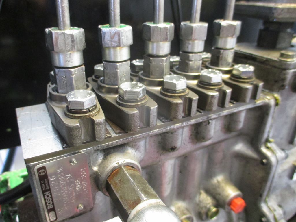

dieselmeken
407
05-28-2014, 01:33 AM #82
I did some machining on the DV holders, like this.
AND TOMORROW THE PROTOYPE IS FITTED IN nORWAY CapSLock
This post was last modified: 05-28-2014, 01:36 AM by dieselmeken.
dieselmeken

dieselmeken
407
05-28-2014, 08:20 AM #85
(05-28-2014, 08:17 AM)rcmarti Goran,
What abouth the delivery valves? Why did you end up using the 603´s rather than the original ones?
Thanks
In this pump the original valves was worn out, New one is expensive, therefore I used the 603 valve. To the rest Im planning to use the original valve from 617A, that is if its OK.
dieselmeken
Thanks
