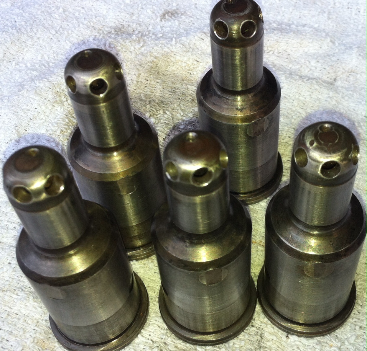

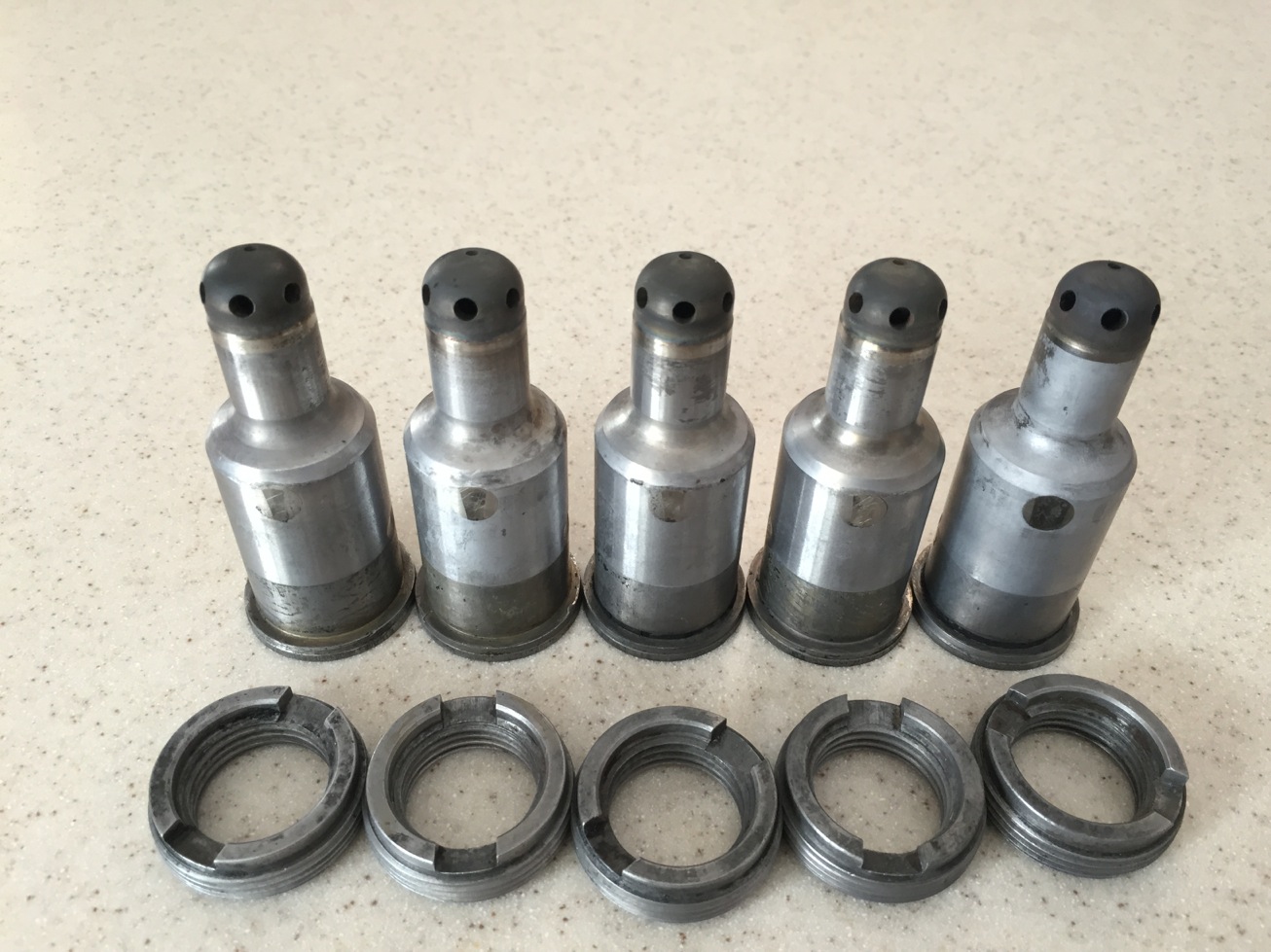

I have five prechambers headed to the machine shop this coming week. Going to open up the three front larger holes to .150 and the back two .125 and the bottom one larger than what it is but less than .125. What is the point of opening the injector seat? Wouldn't the heat shield hole size be the limiting factor here? I can give the engine plenty of fuel with my Myna pump. I'm still running the stock turbo but have a small IC atop it which goes directly into the intake manifold. Minimal cooling compared to other set-ups but also no long piping to which increases lag. I might install the long runner intake I have but that would require a new air intake plumbing plan. Any thoughts on this plan?

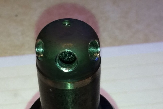

My first one is complete- on a 617-95X

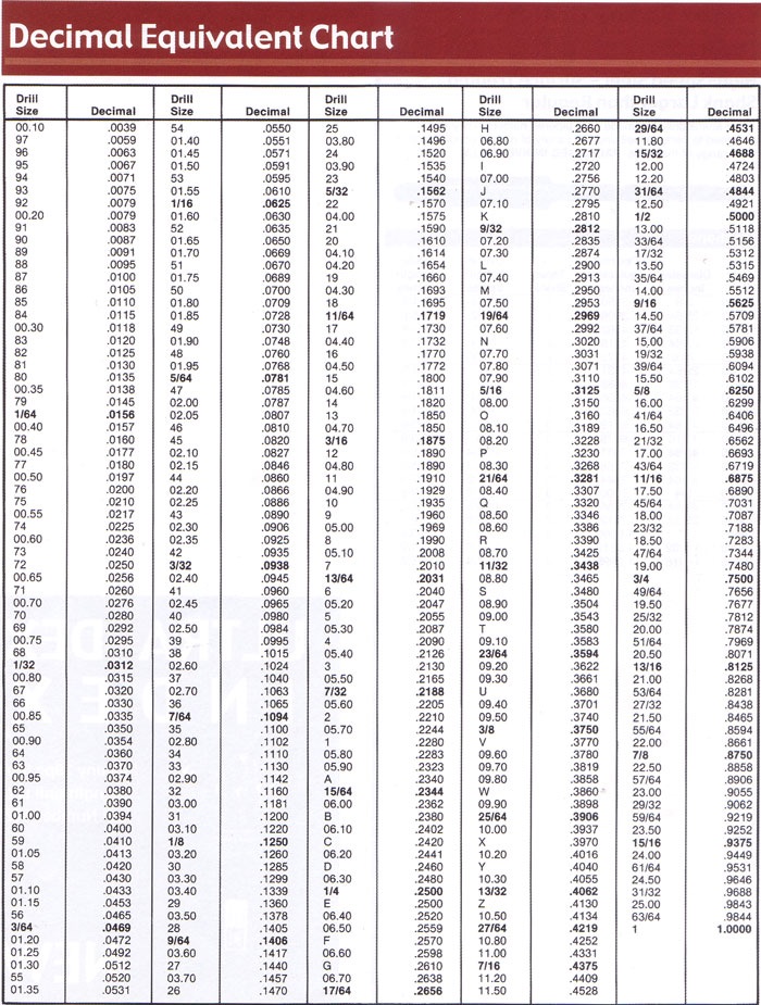

Measurements in drill bits sizes. I used a "Rigid" coldfire set from a local store. The bottom hole did not fit a 5/64, I drilled it to 5/64. The back two were slightly smaller than a 3/32, I drilled them to 1/8. The front two on either side were 1/8, I drilled them to 11/64. The front center was only slightly larger than the other two at +1/8, I drilled it to 11/64. Hand drilled with the PC in a vice. The bits were new and I put whatever sized fit into the hole and positioned the PC so it was straight; (and then removed it) that way I enlarged the holes in the same orientation. No oil used. I then used a countersink to smooth the edges slightly of all the holes except the bottom. It was easier than I thought. I hope to get the other four done tomorrow and installed within a week.
Excellent let us know if there's more oomph
My 11/32 drill bit got dull after 6 holes- I went to Lowes and bought a DeWalt DW1311 Titanium speed tip bit for maybe $4. Cut right thru the next hole with ease; five more to go. After the first the first PC I started using some oil on the drill bit, since the PC in a vice and I'm drilling by hand I don't use much oil however. I also used 220 grit emery cloth afterwards on the drilled areas to smooth the edges out.
EDIT: Ha! that drill bit cut three holes and was dull. The cobalt version of the DeWalt (DW1211) was 10 cents more and it lasted longer.

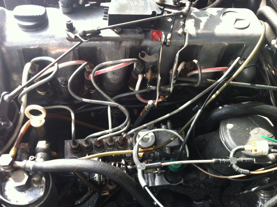

The injectors are the two stage AAZ with 265 nozzles set at 150 bar- and they are amazingly clean as well as all areas around which makes me happy. Wow my iphone pics are large and even when I crop them they are big. Sorry

Well the work is done with the prechamber mods and the end result is just short of "WOW!" I did not change the timing as it was already advanced so there is perhaps some room there for future gains. Now for the report after 40 miles: not as much low end increase as I thought, but there was improvement from idle to 1500 rpm; maybe 5%. It did climb thru the rpm range to get to 2000 RPM measurably faster- and from 2000-3000 the power difference is very noticeable. There was a perhaps 80% decrease in smoke at all rpms except idle where there was and is just a slight bit. That is ultimately important because I have a MYNA pump and it's turned low due to too much smoke for a daily driver when I get on it. Now I can turn the pump up and the car ought to really fly. The 2000+ rpm response is instant and stronger. It really makes a difference at the mid and top end by seeming to breathe freely. The engine is louder and sounds more like a Cummins, but I'm very happy. I certainly cannot say what the long term effect is on enlarging the PC holes, but the short term result is "oh yeah!" I'm going to sleep tonight with a big smile- I think this was a very good mod.
If you are open to tuning suggestions.. I would recommend that before you turn up the max fuel, that you instead turn up the Torque Control, but I have no idea on a M pump how to balance the Idle out. Once you have the Torque Control as far as you can, and you still want more fuel, then that is the time to increase the max delivery, IMOP.
Also, advancing the timing will increase the bottom end, as well as the wrest of the curve. Depending on the condition of the engine (compression) and quality of the injection, (how fine a fuel mist or if your nozzles are like a garden hose) you will be able to advance the injection timing farther than the stock prechambers would allow, providing that the compression and injection are good.

(02-08-2015, 11:08 AM)led-panzer Here is my theory.Were you able to fit the 5/64's drill bit into your bottom hole? I could not and that's what I drilled it with. Otherwise you are saying you are going to enlarge them less than what I did, save the bottom hole. I also enlarged all three front holes to the same size. My total is .8411- slightly less than your plan, due to your larger bottom hole. I could fit a 1/8 into the two "front" holes- which makes them .125.
Stock Holes:
Middle hole = .132
Either side of middle hole = .120
Back holes = .092
Bottom hole = .078
The area of all stock holes = .05432
25% Enlargement:
Middle hole = .165
Ether side of middle hole = .150
Back holes = .115
Bottom hole = .097
The area of 25% enlarged holes = .08483
The area of the 8mm burn tube = .07787
By exceeding the area of the burn tube, you've eliminated the holes as a restriction, because they flow more than the burn tube.
Of course you've achieved the same thing. And it seems it works to great effect. My theory of increasing the hole size but keeping the hole sizes still proportional to each other is to hopefully preserve whatever flow pattern or swirl that mercedes was trying to achieve.
I have not had the chance to do some 0-60 runs, but did have some 60-90mph full throttle runs- but I was driving alone. No times and no video as I won't be driving that fast while working the iphone. I sure do get to 90 awfully quick. Boost was as high as 19 and EGT's to 1250 briefly, then back down to 650 where they were pegged while doing 70 mph. This is while the fuel setting is still not on full. I'll see what EGT's are at 75 tomorrow while cruising- but I don't like to cruise at 80- I don't want the ticket.
0-60 mph test runs averaged just under 9 seconds. Held the brakes until about 2000. First run easily spun the rear tires which was new. Video posting to come. Far less smoke than previous full fuel runs; but that might be due to my better launching technique. I don't think previously I held the brakes till 2K. I downloaded a iphone Horsepower app "pocket dyno"- I couldn't get it to work by myself.

hello fine people,
unfortunately i can´t reporn any gains with a increased hole pre cup. this was for a 605 engine.
at least a large increase did not work for me.
