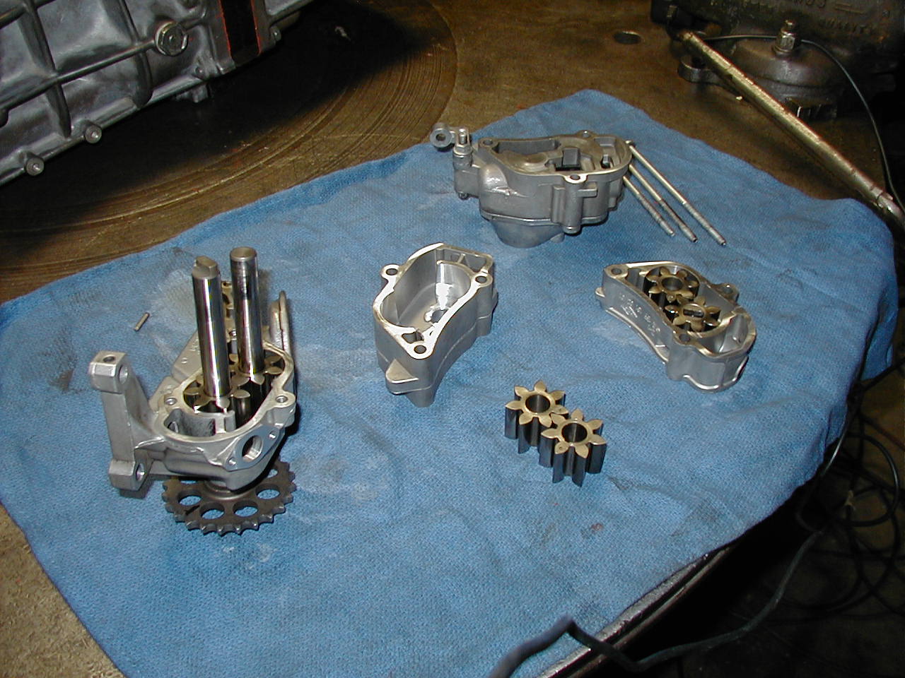

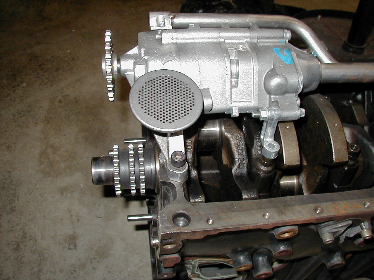

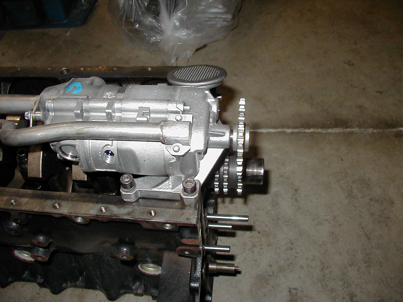

Whats the deal with the mesh near the front that looks like a front pickup? And the secondary tube that goes part way back? ...is that a secondary pump that pulls oil from the front and dumps it in the sump?
Figures the solution would be discovered only after I fabricate a dry sump setup. Dodgy

(07-23-2014, 11:13 PM)vica153 Whats the deal with the mesh near the front that looks like a front pickup? And the secondary tube that goes part way back? ...is that a secondary pump that pulls oil from the front and dumps it in the sump?
No idea what it is, but the 648 pump has an extra section in the main pump body making it overall longer. I don't really want to disect that pump unless I could find another cheap 648 pump?
The port at the front with the mesh is the outlet. Drops the oil onto the front of the sump which aids cooling i guess.
Secondary tube at a guess - overpressure bypass?

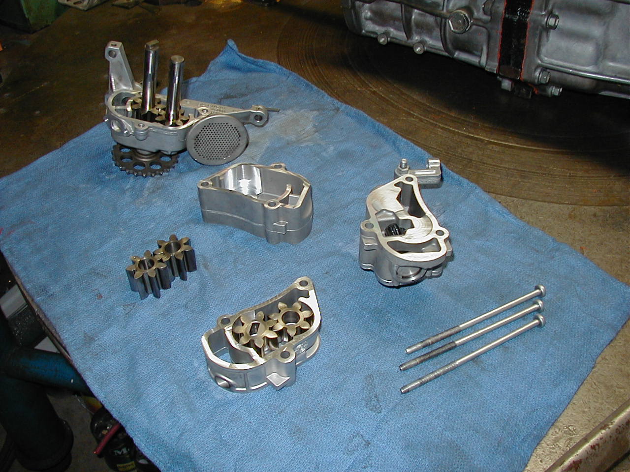

(07-22-2014, 04:50 PM)ho55 I thought that Zeeman had confirmed that the 648 pump was a drop in fit. Zeeman did you really check for this offset?
Haven't been on forum for a while and getting up to speed. Enclosed are some pictures of the 648 pump on the 606 block. Everything lines up perfect.

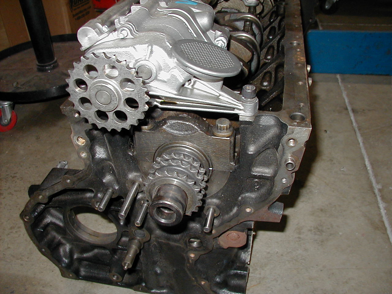

(07-24-2014, 05:26 PM)ho55
Simon if you find the bolt part numbers could you post them please? And to be sure is this the 605 or 606 you are talking about. Shame they are different lengths i was just hoping to swap 4 over. I presume these can just be removed and re-torqued without upsetting the bearing shells?
I just looked closer at the 606 main cap bolts, the head is threaded for a 6mm x 1.00 bolt. Just need three bolts to hold oil pickup tube and oil pump to the main caps.

Now the original pump has a square output aperture which mates against a square port on the engine, and i dont think an gasket was there. Which seems a bit strange.
The 648 pump has a round output with a recess, so it looks like an o-ring should go in there, which makes more sense.
Can one of you guys (Zeeman, Simon) confirm that it needs an o-ring?

(08-13-2014, 01:10 PM)ho55 Now the original pump has a square output aperture which mates against a square port on the engine, and i dont think an gasket was there. Which seems a bit strange.
Yep you need an o-ring, one of my pumps came with it, the other didn't. I'm sure the oil hole in the block was round, can't remember now and a bit hard to check as I dropped my engine in for trial fitting a few evenings ago!

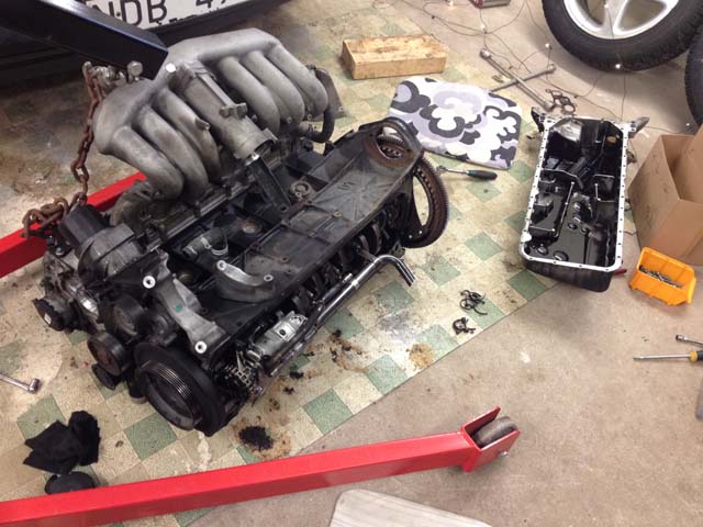

OK got some photos of the OM605 and OM647 sumps side by side, the six cylinder is very similar, just longer!
[Image: 100_7605_zpsae46916a.jpg]
[Image: 100_7606_zps24b7d20c.jpg]
[Image: 100_7607_zpsc54f2ebe.jpg]
[Image: 100_7608_zps0287c8e2.jpg]
[Image: 100_7610_zps6ca6a652.jpg]
[Image: 100_7612_zps68e9fae6.jpg]
[Image: 100_7613_zps2bf77794.jpg]
[Image: 100_7614_zps19e70c5a.jpg]
[Image: 100_7615_zps4a2db1c3.jpg]
[Image: 100_7617_zps8c0e1a37.jpg]
[Image: 100_7618_zps72143195.jpg]
[Image: 100_7619_zpse30e8def.jpg]
The part number of the OM647 cylinder sump
[Image: 100_7622_zpsaa4ff4aa.jpg]
The part number of the OM648 6 cylinder sump
[Image: 100_7621_zps316054ac.jpg]
These are the two types of main cap bolt that I know of, I cheated and swapped a few between my two engines to fit a windage tray into my OM605
[Image: 100_7547_zpsdb4b510f.jpg]
I do now have my OM605 running in a car with the OM647 sump fitted, not wired up or plumbed in, just sat on the mounts with a can of diesel balanced beside it, so no idea what the oil pressure etc is?
(10-01-2014, 10:14 AM)Hario simonm16p6 would you please furnish us with any information regarding your exhaust manifold made from sheetmetal?? It looks like Orgiami and I love it! Thanks
I'll throw something up later, I guess I have enough to start a proper project thread now Cool
edit
The difference in bellhousing flanges between the OM606 and OM648 sumps that I have
[Image: 100_7643_zpseddc9fde.jpg]
This post was last modified: 10-03-2014, 08:49 AM by simonm16p6.
edit

simonm16p6
43
10-08-2014, 08:43 AM #71
(10-08-2014, 07:28 AM)ho55 Hi Simon.
Yeah i guess i should source the correct OM648 oil guard. A bit hard to find, may have to buy new.
Any thoughts on what to do with the mismatched bolt holes? I am wondering whether to just leave it as there is most of the support done by the GB to engine bolts. Or to get a plate welded onto the GB. Or to make a set of small link brackets. Either one requires some machining work.
I made my own windage tray to fit around the OM648 oil pump and sump.
[Image: 100_7639_zps34b27802.jpg]
[Image: 100_7640_zpsf0e77b4d.jpg]
For the bellhousing I will be making a steel ring adapter plate because it's going onto a different gearbox, but maybe weld some bosses into the sump to suit, as the bellhousing bolts sit within the sump? I reckon my engine is already flexing the bellhousing by attaching on the upper bolts only.
Also you will need a dipstick, I'm yet to check what the correct oil levels are meant to be then set the dipstick to suit that, or buy a CDI dipstick....

112
12-02-2014, 04:44 AM #74
Thanks for all the pictures and measurements !
i have now bought a w211 320 cdi engine to take the parts from!
This post was last modified: 12-02-2014, 04:45 AM by MrHope.

zeeman
444
02-04-2015, 08:05 PM #79
(01-30-2015, 06:30 PM)ho55
(01-22-2015, 02:26 AM)MrHope Would be an easy task for someone who has EPC.
i dont sorry.
Anyone? Please.
My OM 648 doesn't have on either. The Om 606 has one to direct the oil forward to the front sump, instead of splashing around in the pan. The natural oil flow would be backwards to the rear sump hence the Om 648 does not have a splash guard. You also have to take in consideration the engine is usually slanted down to the rear making a splash guard even more important to a front sump.

Does anyone have a part no. for the crankshaft cap bolts with the internal thread for the rear bowl oil pump?
matfield
10-10-2016, 09:28 AM #93

(10-10-2016, 09:28 AM)matfield Does anyone have a part no. for the crankshaft cap bolts with the internal thread for the rear bowl oil  pump?
Should already be in there Matt and not need changing.
I've just been trying to look back through my pictures and can just about make out the bolt heads on the pick up tube bracket, so they're definitely in there. (that and there is no way I'd have just left it flapping in the breeze!)

10-10-2016, 10:59 AM #95
Can't speak for the 605 but the 606.962 main bolts are already threaded for the CDI pickup tube support. I can verify you are correct, Ross. I recently put the rear sump on my F150 conversion so it's still fresh in my head. Zeeman should move to the east coast.

Ok... good news. The local main dealers didn't have a clue what I was talking about, or anyida where to find them, even with engine numbers etc.
So when I pull off my old sump, the cap bolts for the new pump bracket are already threaded...?
I want to be certain before I ring him in the morning and tell him to stop looking.

(10-10-2016, 10:59 AM)50harleyrider Can't speak for the 605 but the 606.962 main bolts are already threaded for the CDI pickup tube support. I can verify you are correct, Ross. I recently put the rear sump on my F150 conversion so it's still fresh in my head. Zeeman should move to the east coast.
It is to dam cold on the east coast. Someone was asking what the 648 pump looked like inside. Enclosed are some pics. They have two gear sets, three pickups.
Zeeman

10-11-2016, 03:37 AM #98
(10-10-2016, 02:12 PM)matfield Ok... good news. The local main dealers didn't have a clue what I was talking about, or anyida where to find them, even with engine numbers etc.
Thanks again!
Mat
Harleyrider has confirmed my memory that they will already be threaded.
