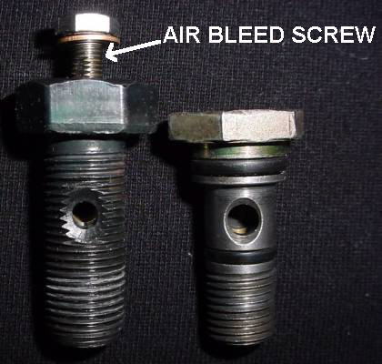

06-19-2010, 02:21 PM #56
(06-19-2010, 01:39 PM)blowfish Just came into my head the other day, diesels have a return line, which suppose to cool down the injectors heat.
No the return system is primarily for automatic air bleeding. Big vehicles (such as the city buses I work on) have no return circuit and do totally fine without, even with high heat generating systems such as common-rail injection.
Quote:that way the new fuel will be preheated by the return line
The hottest it would ever be is 230*f from contact with the injection pump's lubricating/cooling oil, if you looped the return so it maintains contact long enough to get hot. The Lift pump moves so much excess fuel through the system it doesn't hang around long.

09-12-2010, 09:57 AM #66
(09-12-2010, 08:06 AM)dropnosky Just as long as you have some way to unloop it for air issues.
Drill and tap 1/8NPT into the return line banjo for a bleed screw.
(From the Baldwin filter upgrade)
