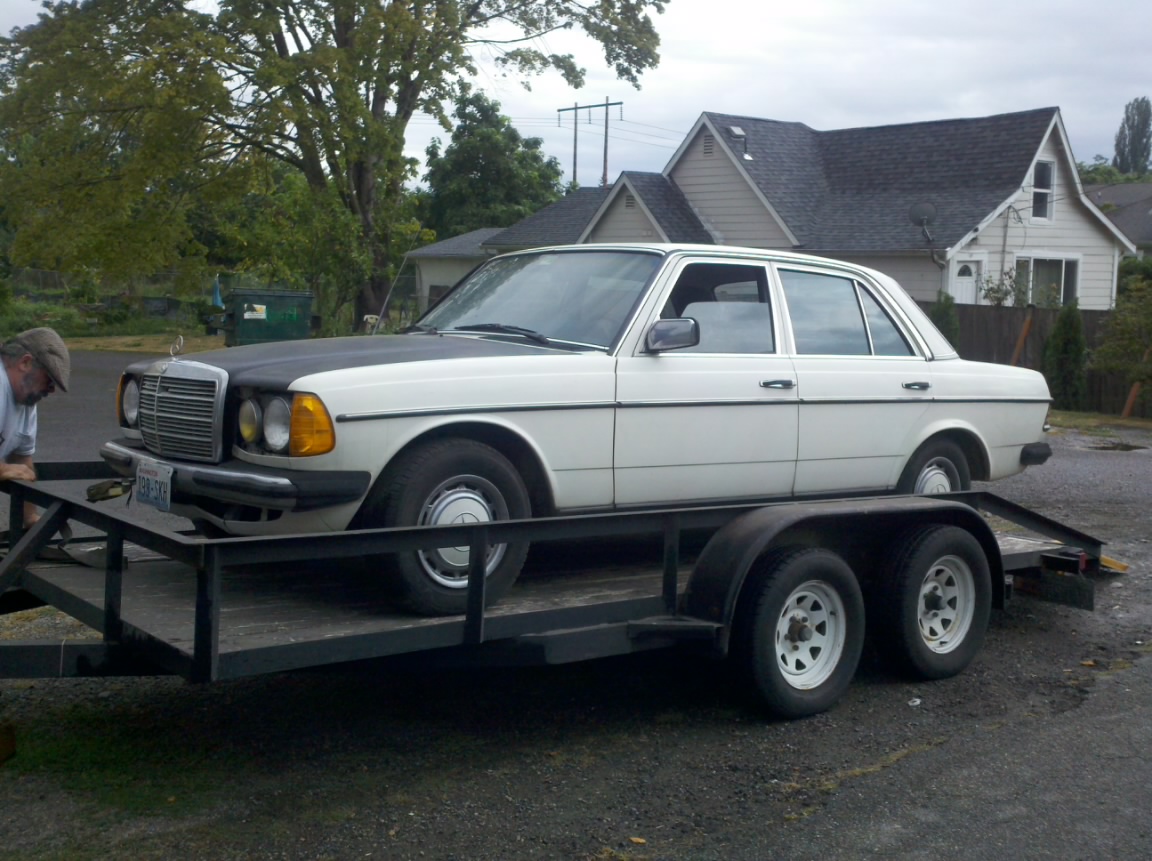

So my brother, C12H23, sold the 300D and picked up a 83 240D 4 speed in its place. The car is all and all in really clean shape. He swapped over the non-egr intake off my 77 240D project car and got some tune-up stuff done. The car is a bit slow though... So while I was rumaging through a junk yard, I found chevy small block header. Hmmm... a little measuring later and it came home with me. The exhaust pattern is pretty close to the 240D pattern.
[attachment=4319]
We're going to cut off the chevy flange, add about 5-6 inches of straight to space it off the starter and all that and see about mounting this bad boy to his 240D! Big Grin Wont be a ton of power, but so what! He'll have a cool looking header at least!
