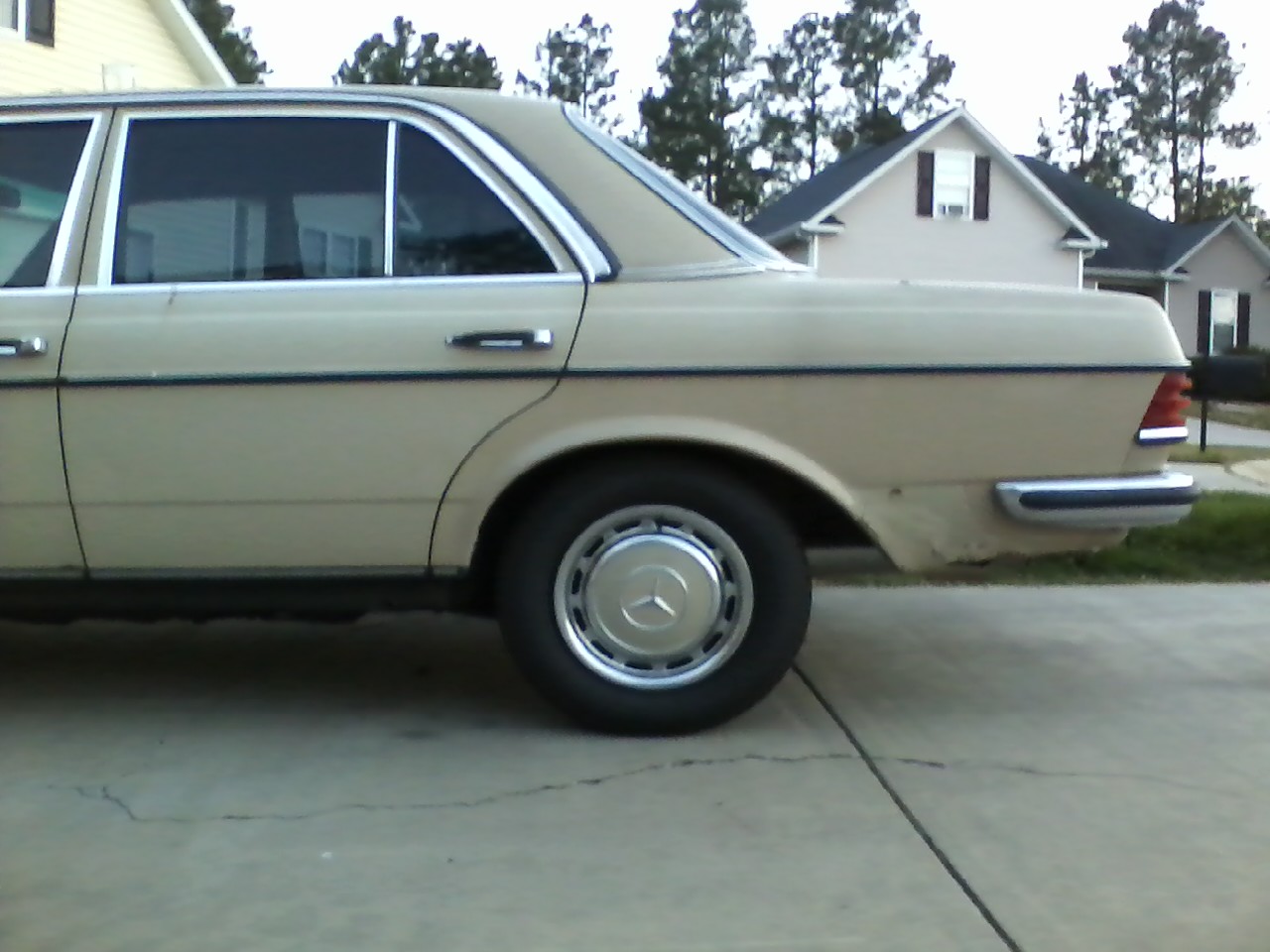

Look what I did to my poor car. It's all jacked up ...
New Bilsteins in the rear and new Propigskin SLS delete springs in the rear with 19mm shims as well. Hope it settles down. Or, maybe front new springs and new Bilsteins will make it look level ? Just higher ... poop.
Does anyone know if I went with the 10mm shims versus the 19mm shims if that will make any real difference ???? Thank goodness this is a really easy operation, takes slightly over an hour, so any changes are no big deal.
05-06-2014, 10:22 AM #123

05-06-2014, 11:30 AM #124
Wow! You're ready for some 32" mud tires! Looks like you might have to cut some coils

05-06-2014, 01:30 PM #125
What is the reason for going Propigskin springs? They are a taller and thicker wire diameter spring for wagon weight.
I going to bet the only way to get it down (and it's not going to be a lot) is to get a firmer spring up front. You are probably running 240 springs since this was a 240 right?

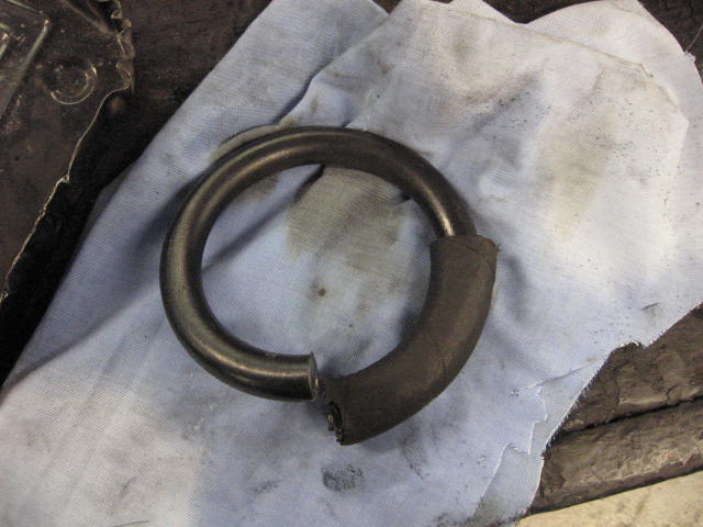

I am going with the 9.5 rear pads and 300TD front springs from a 1983 wagon. This weekend's project.
Not overly thrilled with the new look

05-06-2014, 10:09 PM #129
Sorry I lol'd. That ass is wayyy up there! In pretty much the exact opposite situation, I used 240D front springs in my wagon, which gave the front end a inch or so drop, and improved the overall, dare I say, "stance" of the wagon. It was much improved in my opinion.

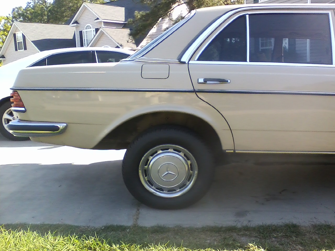

05-08-2014, 07:35 PM #135
I ended up cutting one coil, which I believe is too much. I wish I cut 1/2 coil and then fine tuned it from there. Probably 3/4 of a coil would have been perfect. Odd thing, driver side's spring was tight when the spring compressor was removed and the passenger side was loose enough where another 1/4" would have been needed to make it tight like the driver's side. I measured a number of times and both coil springs are exact, within an amount which is not perceptible to the eye. So, not upset but not 100% either. On the ground, the car is the same height on both sides. I will measure again tomorrow to see if anything changed.
Drove it home, and made sure I drove it aggressively around the corners, et cet. Got a number of "t w a n g s" so to speak, but cornering is really really nice. Overall, the only thing I regret or would have done differently is cut 1/2" coil, drove it around for a day or two, and then decide to cut some more or not. The 18mm rear springs are definitely an improvement over 15.9mm 240D springs. Again, wish I only cut 1/2 coil, and then maybe another 1/4 of a coil at most. I currently got 19mm rubber pads, so I am pretty much stuck with what I got.

05-08-2014, 08:11 PM #136
I think it looks good. Its funny you mention the drivers side being harder than the passenger's side, I just experienced that on the fronts.

05-08-2014, 09:37 PM #137
Thanks Jake ...
I wish I only cut 1/2 coil and then I could play with the 9.5mm pad. Now, I am stuck with the 12" spring and 19mm pad. I should have used my better judgment.

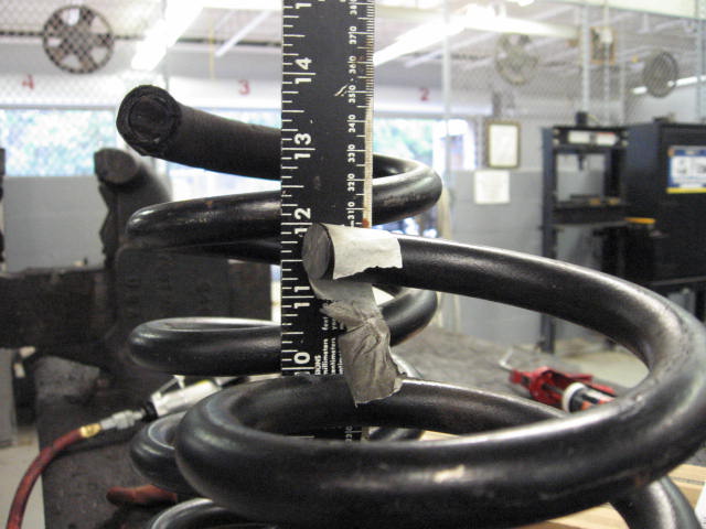

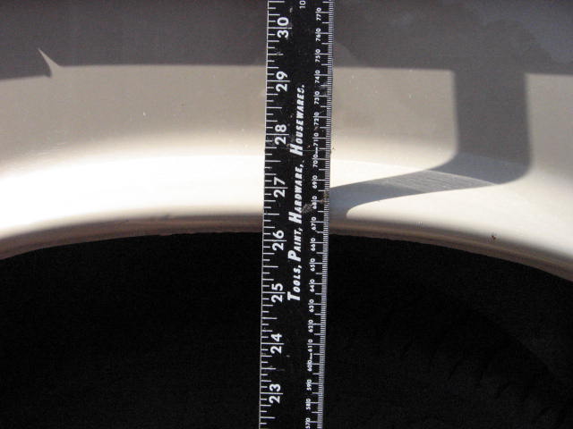

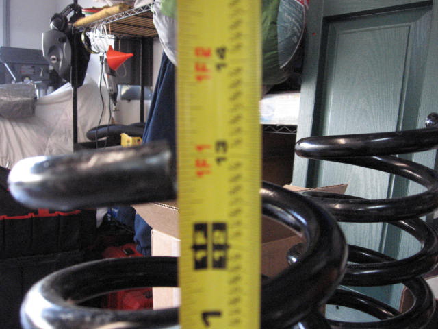

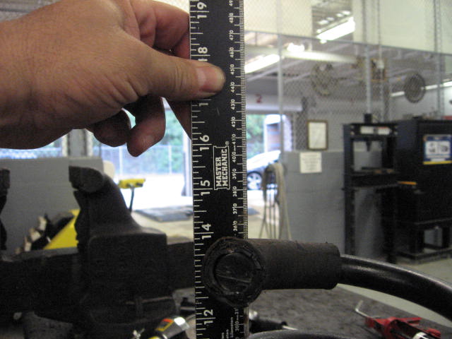

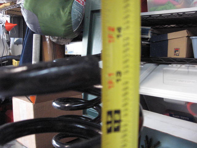

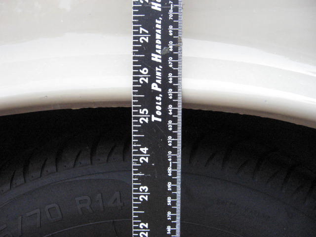

05-21-2014, 09:36 AM #142
THREE'S A CHARM
This AM, I went ahead and swapped out the springs for a third time, and success. I got the exact look I wanted. It was like the three bears, one was too high, one too low, and now right where I want it.
The springs come from http://slsconversion.com/How_To_Install.html
The SLS wagon flavor are a hair over 14" in height. I cut one entire coil, and ended up with 12". The 14" with 19mm pads was way too high. The 14" with 9.5 pads were still way too high. The 12" with 19mm pads were too low IMO.
So, I ended up getting the same 18mm springs from ProPigSkins (ATTN: Erik) at 13+" I want to say 13 1/4"-ish. I ended up using new OEM MB 9.5mm pads. My car now sits around 30mm higher in the rear which is just about perfect for my tastes.
I drove the car right afterwards. I took some really sharp corners, going uphill and downhill in the cornering and was very aggressive and I can say those springs are "WOW". Very very tight steering, no splashy rear end, and an overall 2 thumbs up for the 18mm springs.
Word of caution. The 12" spring height with 19mm pads is barely high enough to create tension in the rear spring pocket; however, once you install the shocks and put "some" weight on it, they ride just fine, just too low for me. I still got an occasional twang when driving aggressively, BUT the twangs were going away since I am thinking those springs finally seated.
So, for a rear suspension upgrade, this is best way to go until I tinker with the 6.9 M100 W116 hydropnuematic four corners system down the road. However, for an hour or two job ... YOU CANNOT BEAT THIS ONE !
Erik at the company provides 100% customer service. You cannot beat his attentiveness and concern with the hobby.

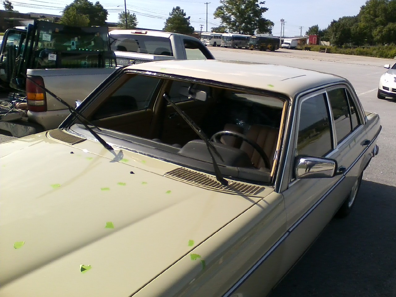

06-03-2014, 11:36 AM #143
Slight change in the repairs - restoration project.
Finally got my windshield damage fixed, although the damage occured last July. Gotta love my insurance company of 28 years. In any event, I got a NEW Mercedes windshield gasket and aftermarket windshield. Cleanest windshied I've had in a while ... lol
The guys who fixed this knew their stuff -- only took about an hour.
06-03-2014, 11:58 AM #144
exceeeeeeeeelllennntttttt
06-03-2014, 02:36 PM #145
I love new windshield's they are so nice! whats with all of the green tape on the hood?
1,278
06-03-2014, 03:03 PM #146
A way to ID the hail storm dings. We got hammered around two weeks ago. My wife's Camry had $3K worth of hail damage. My front clip was perfect and pristine, but the metal must be thicker than a Camry's (or any other newer car) since some of the dings were faint and hard to keep track of. I have between 44 to 60 dings. Trying to get my estimate for the work now. The problem is my insurance company will total the car if the hail damage exceeds 40% of the car's value. My insurance company will just give me a low ball value for the car, e.g. $2,000 if I am lucky, and then claim it has $1K+ worth of damage. Then, they avoid paying the claim, they low balled the value, and then I am stuck either totaling the car or abandoning the claim altogether. Been with USAA for around 28 years and they are HORRIBLE. Looking for a new insurance company by 30 JUNE 2014. I really hate USAA. They loved me for the first 24 years since I never had a claim and they got my premiums for all those years. Now, I learned the hard way. They totaled my first MB and lowballed the value.

how hard would is it to pull those dents, can it be repaired like it was?
After all that work!! holy crap

Anything can be fixed or repaired.
Right now I am very cautious with the estimate business since USAA has demonstrated its only motivation and that's avoiding proper claims. I suspect the damage could be in the same ball park as my wife's Camry or could be as low as a $500-$1,000. Who knows. I am now looking for a roofer since my entire roof needs replacing, siding around 50% of my house, a new HVAC unit, a few windows, and some other odds and ends. That brief 2 hours of hail and wind and rain a few weeks ago has gobbled up a lot of my time and it does suck knowing that your insurance company is not in your corner at all.
