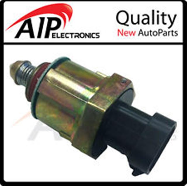

Quote: [OM616] Then to take it a step further, a stepper motor such as an IAC from an old throttle body injection unit could be used to replace the ALDA so that it’s function could be controlled by computer as well.
(11-24-2012, 09:50 AM)raysorenson This could be wonderful. Steppers do not need a position sensor to monitor movement so they can work in open loop, simplifying programming and circuit design. I haven't played with steppers yet, but I've researched installing them on my lathe for an NC conversion. A NEMA stepper in the 20kg/cm can be had for around $25.
MAP would be the only input needed, correct? The way the pump is designed, RPM need not be monitored for alda operation.
The issue of fitting the motor to the pump so that it can survive the vibrations would likely be the most complicated part.
Like I said, there are automotive stepper motors with enough travel to do the job. I would have a TPS as well, that way when you stab the peddle to get out of the way, the computer will lift the ALDA rod sooner, (pre boost) so you will get power sooner to get moving faster.
I modded a governor before where I eliminated the TC and Max speed governors, it was a lot of fun, very much like a good gas engine

Quote:Like I said, there are automotive stepper motors with enough travel to do the job.
Yes, I noticed that the first time you mentioned it and I thought it was a bad idea. What are the pro's of using junkyard IAC stuff?

(11-24-2012, 07:27 PM)raysorenson Yes, I noticed that the first time you mentioned it and I thought it was a bad idea. What are the pro's of using junkyard IAC stuff?
LOL, junkyard?? nah.... these things can be had new for cheap, and as for the pros, they are designed to be used in "under the hood" conditions, that includes vibration, temperatures, and fuel.
I prefer to use known parts instead of getting something from Mouser and hoping that it will tolerate the environment, but that is me. Smile
I most likely would not bother with controlling the ALDA via computer, but if done properly, it would be a nice tuneability feature.

(11-25-2012, 07:57 PM)raysorenson You still sound like you don't know what you're talking about with this stepper motor stuff. Weather pack is what GM calls a sealed connector. I liken calling a sealed connector "weather pack" to someone calling nitrous oxide "NOS". Additionally, the uncrimped pins can be had from pretty much any sealed connector system and if not, wires can be soldered and heat shrinked. And finally, you'd need a very strange bird of a stepper for ALDA control if you want to avoid gear reduction, which is a deal breaker for me. I'd be surprised if you could find if you could find the ideal stepper under a hood.
You caught me... 12 year GM R&D. I have no idea what you are thinking in regards to what you think I am taking about, "gear reduction" ?? I have attached a pic of what I have used for other apps with good success. The tip unscrews, which allows for other things to be attached.
Here is a quick pic of one I found on e-bay. No reduction needed, it moves in and out in small controllable steps (or in GM terms "counts") and holds its position with out power required.
(11-25-2012, 07:57 PM)raysorenson On a more substantive note, why even use a stepper when you only want a small amount of linear motion? A solenoid would work faster, require no gearing and use only 2 wires with the price of needing position feedback. How much force is required of the ALDA?
I really do not think you understand what I am talking about, but it sounds like you have a good plan, feel free to use what ever you what on your set up.
There is no arguing with anyone that thinks the other is an idiot, so I will leave this up to you... given you think I am full of shit, (not entirely impossible, I have never seen my insides to know for sure), would you prefer that I not post over here any more? I have no problem being called out, but at least know what the hell I am talking about, or provide some proof to support your claims.

Ahh, we're on the same page, you've just got the nomenclature mixed up. Unless you know something I don't, the picture you've posted is of a solenoid, not a stepper. Steppers rotate and require more than 2 wires.
While a stepper motor could get the job done, gearing would be required to change motion from rotational to linear. Since the linear motion required is very little, gear reduction might be necessary to allow a stepper motor to finely adjust ALDA position, unless you've got a stepper motor than can move in very small increments without detents, then you can just use a rack and pinion or worm gear to go from rotation to linear motion. The nice thing about stepper motors is that position does not need to be measured with a potentiometer so closed loop PID control isn't necessary. I don't like messing with PID control.
The best known automotive use of a variable position solenoid is an IAC valve and I see now why you mentioned IAC earlier. Steppers were used for IAC control in the 80's on some CFI setups but those gave way to solenoids. To my knowledge, all variable position solenoids in production automotive powertrain controls are used in closed loop and I don't see how ALDA control would be an exception. This sucks. You'll need a linear potentiometer ("string pot", as someone with your experience would know them;-) ) somehow rigged up to measure movement and, of course, fcvkin PID control.
It's starting to look like the M pump would be the best candidate for electronic ALDA control since a stepper could be more easily adapted.

(11-26-2012, 08:58 AM)raysorenson Ahh, we're on the same page, you've just got the nomenclature mixed up. Unless you know something I don't, the picture you've posted is of a solenoid, not a stepper. Steppers rotate and require more than 2 wires.
(11-26-2012, 08:58 AM)raysorenson I haven't played with steppers yet, but I've researched installing them on my lathe for an NC conversion.
Keep reading about stepper motors and you will eventually get to some that that are linear in action, such as the one pictured above. It is obvious that you have never had one in you hand or worked with this one, or one like it before, probably before your time, and as you said, these are new to you.
How this one works, the shaft has a key way the full length of the shaft. This key way allows a tab in the body to keep the shaft from rotating, yet allowing it to move in and out.
Inside the housing is a specially designed stepper motor. Inside the housing, the shaft is threaded on the OD, and the motor has threads on the ID of the Armature, so as the armature rotates, the shaft moves in or out depending on the direction of armature rotation. There are actually 4 pins in the connector to be clear. How you were able to see any from that pic is beyond me.
So to recap, we are not on the "same Page". The pictured item is not a solenoid, it is a liner stepper motor, the shaft does not rotate, but moves in and out in very small steps that are controlled my how many steps the motor turns. This unit has a very nice "Weather Pack" "4 pin" connector and is designed for use in under the hood conditions. This unit also has a threaded end so it can be easily attached to an adaptor to the pump.
Tmadia nailed it!!! Now stop embarrassing yourself and polluting my thread.

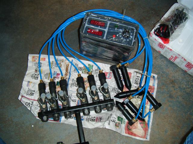

I actually got around to opening up the boxes with the master injectors and stroke counter today. It is like Christmas, only I paid for the presents.
The variable frequency drive is the last major component left, and it is not cheep either, nothing seems to be lol.

01-20-2013, 11:53 PM #175
(01-20-2013, 11:21 PM)sassparilla_kid What kind of gauges do you need?
I am going to use 5, 3inch face, 2inch range dial indicators. Don't bother to say "what?", it will all be clear you see some pics of it all together. lol I do it a little different than everyone elseWink

Here is a pic from Dieselmeken after i asked him to put the pump straight into the bench to see how close my DIY element swap was.
[Image: attachment.php?thumbnail=5154]
LEAVE IT TO THE EXPERTS.
