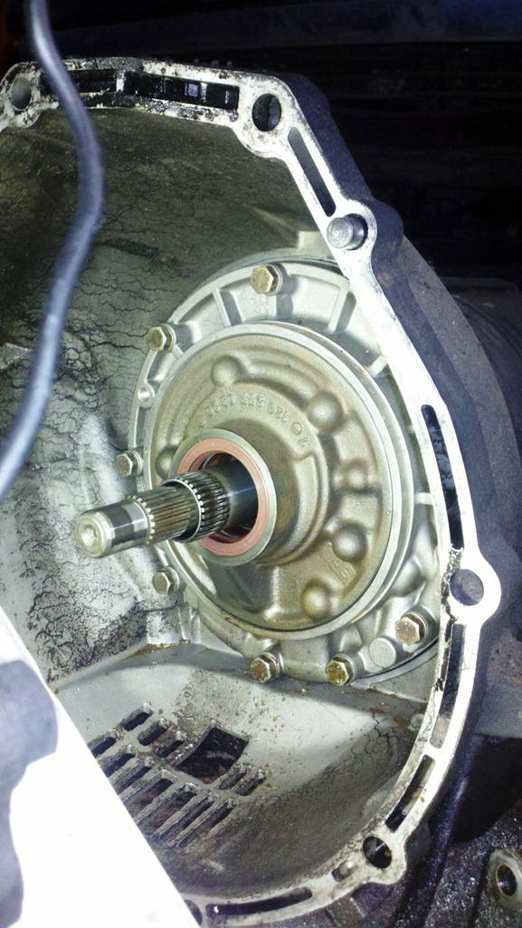

06-21-2011, 10:26 PM #261
I just put the the SD back together. I dont see a way of converting it to a mechanical speedo...

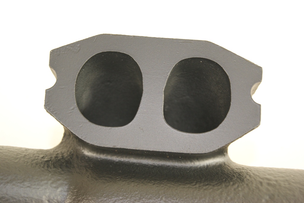

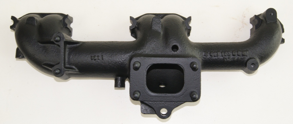

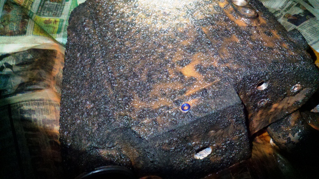

07-06-2011, 03:33 PM #264

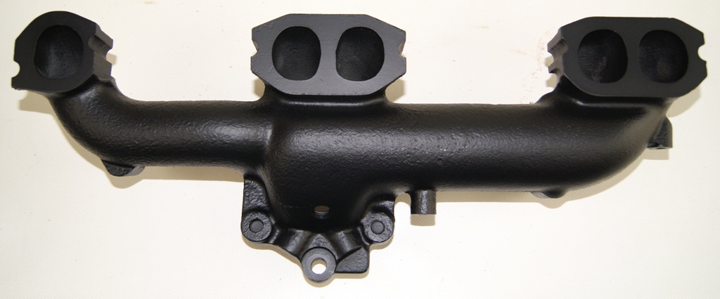

Ohhhhh Baby! $80 coating job for free!

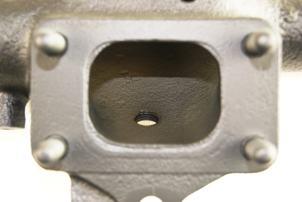

Thanks to the guys @ Engineered Apps http://engineeredapps.com/
Its got the standard ceramic covered with the high temp black ceramic. The silver ceramic does the corrosion resistance and the black takes care of the high temps. The Black is very thin, that is why they shoot the thicker silver underneath to keep the corrosion resistance in case the black is scratched off.

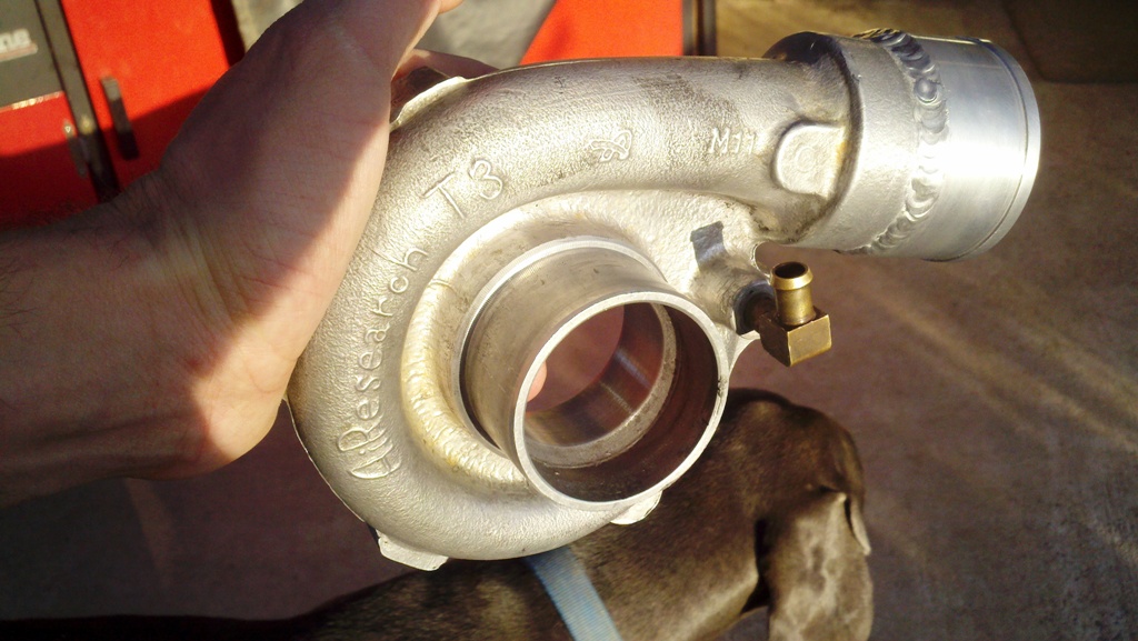

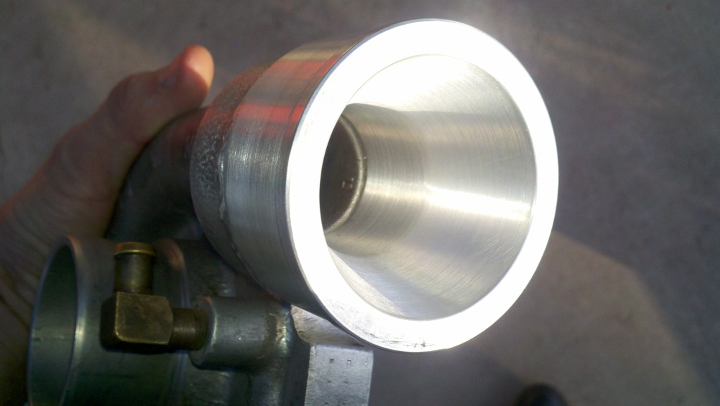

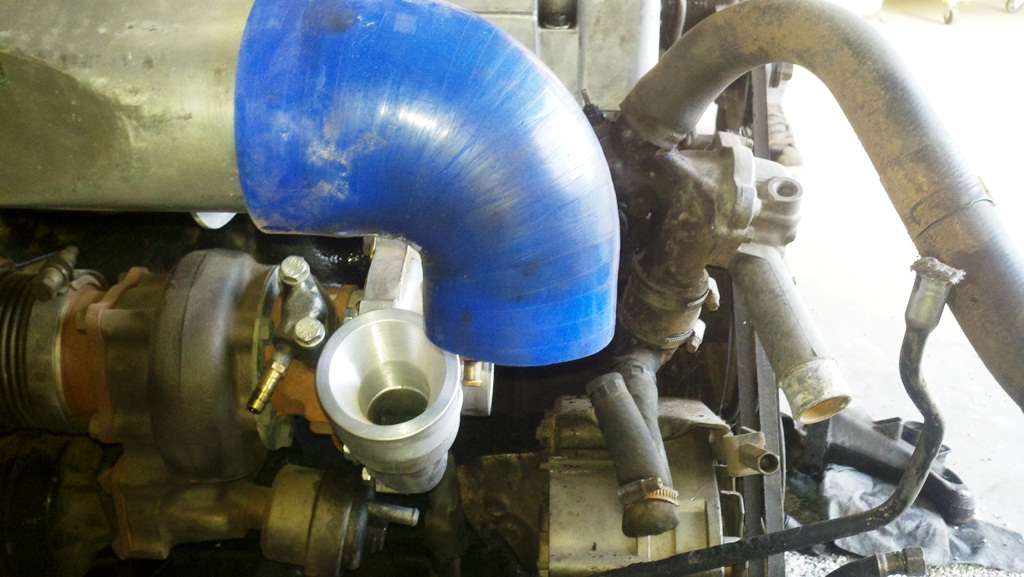

07-12-2011, 03:02 PM #266

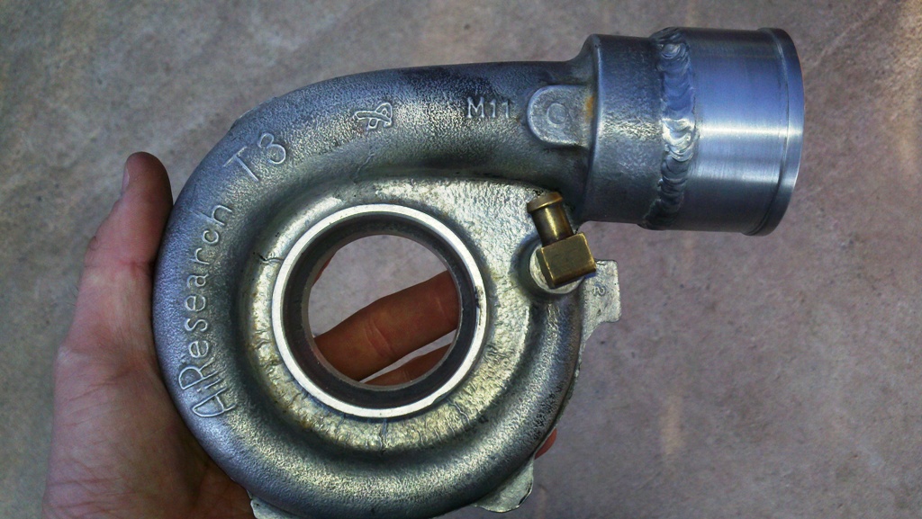

Got My compressor housing from Rudolf...

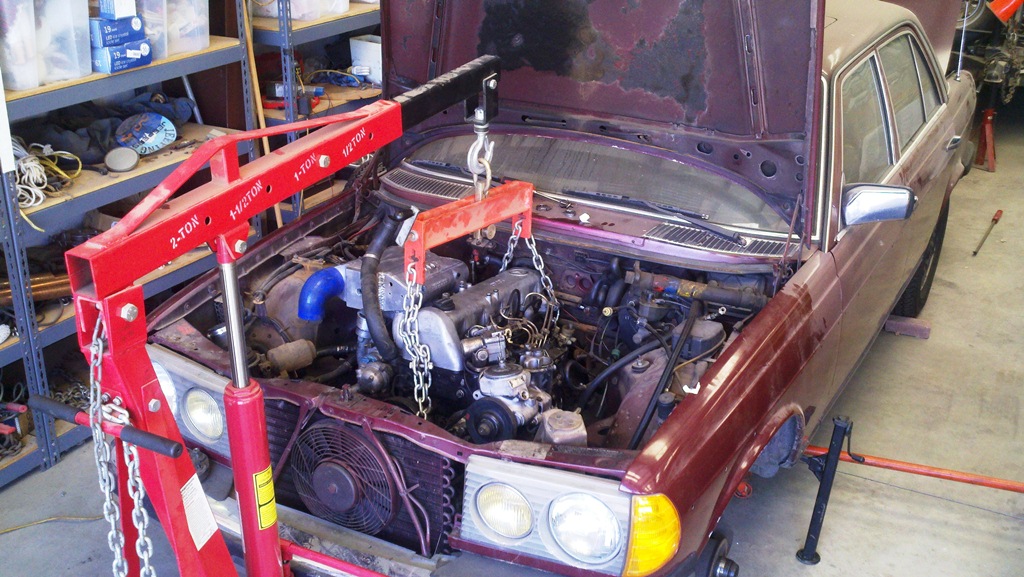

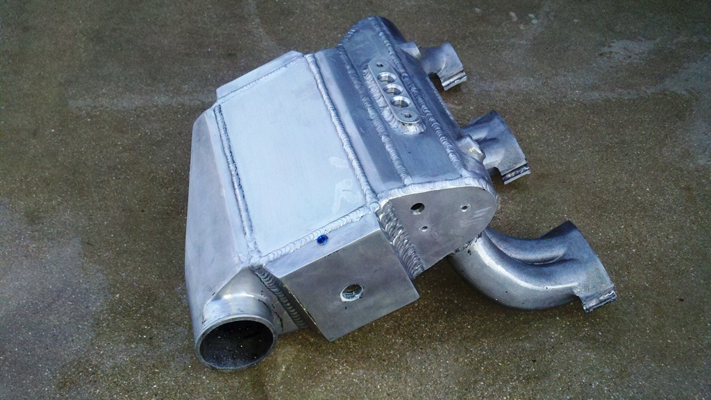

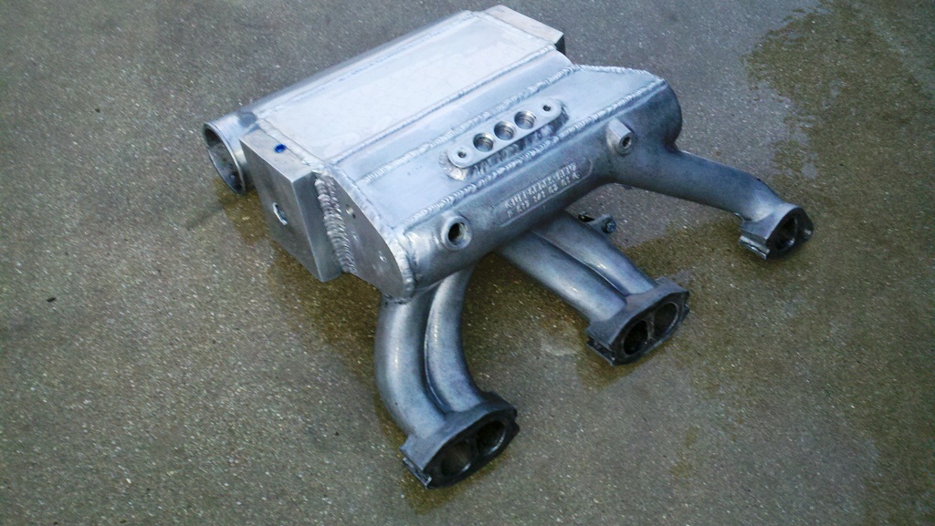

08-25-2011, 12:42 AM #267

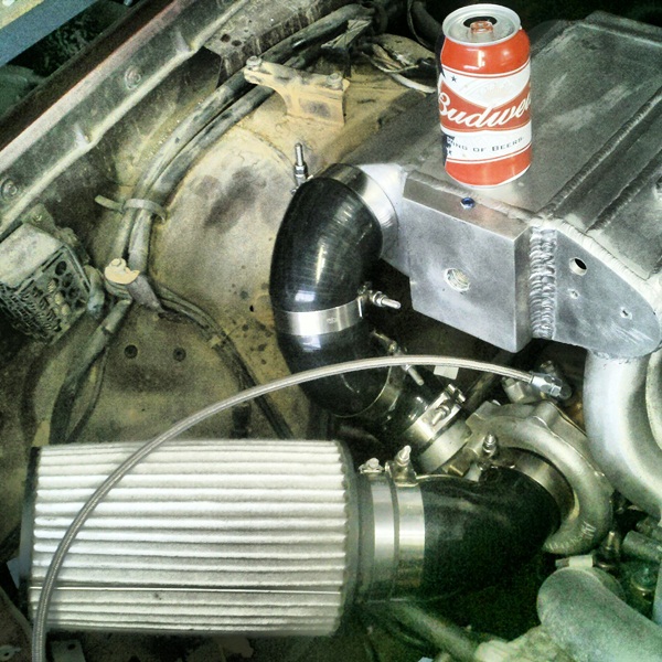

FINALLY got time to start work on the Benz again. Stripped most of the paint of the intake
iheartboost
422
08-25-2011, 09:32 PM #268
Is that the same one in earlier posts? Thats custom right? Water to air intercooler I presume.
00 Mustang gt drift car
iheartboost
08-25-2011, 10:24 PM #269
(08-25-2011, 09:32 PM)iheartboost Is that the same one in earlier posts? Thats custom right? Water to air intercooler I presume.
Yes, yes, and yes lol

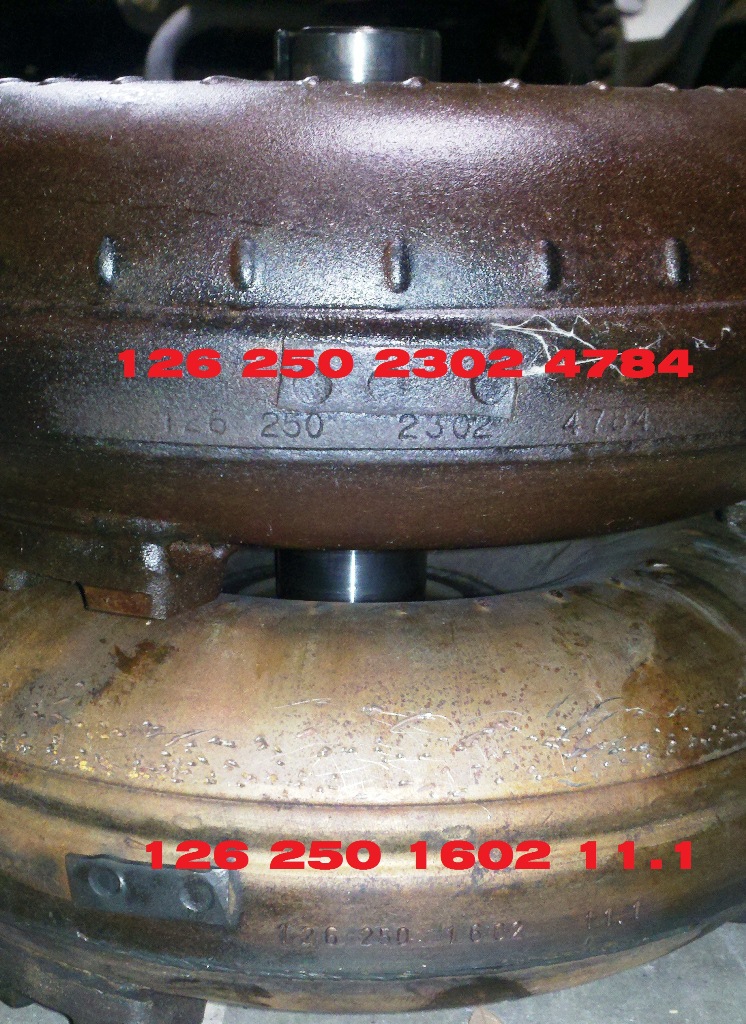

05-22-2012, 09:13 PM #276
Hey man, I thought it took me a long ass time to get all of my shit finished, but jeeeez, your project has been in the works for way longer than mine and it still isn't done! Hurry up, I want to see how well that IC works out for you, to motivate me to get one goin lol
05-22-2012, 09:29 PM #277
(05-22-2012, 09:13 PM)sassparilla_kid Hey man, I thought it took me a long ass time to get all of my shit finished, but jeeeez, your project has been in the works for way longer than mine and it still isn't done! Hurry up, I want to see how well that IC works out for you, to motivate me to get one goin lol
[Image: chillout.jpg]
I have a ton of interests. You guys only have the diesel benz interest. I have the Sprint, a Jeep, a Buell, and the Benz. They all get equal love.

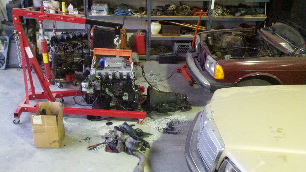

I have been working on it, just haven't updated. Got all the lines for the remote oil filter housing, brazed the turbo oil inlet to accept a -4AN
[Image: photo.php?fbid=415818911786230&l=2f7a7a39ec]
https://www.facebook.com/photo.php?fbid=...2f7a7a39ec
... Other stuff here and there. Installing the high stall torque converter tonight, then dropping the motor/trans in.

05-23-2012, 02:23 AM #279
Haha. Here are some pics of tonight.
Dirty shop lol
Nice to see the trans was clean behind the converter
Original on botton (dunno what all the pitting is from Huh) High Stall converter on top, Thanks to Mr. Dropnosky

05-23-2012, 02:42 AM #280
Awesome. What's the high stall converter from?
05-23-2012, 02:53 AM #281
'85 300D If I remember correctly. The thread on it is here: http://www.superturbodiesel.com/std/thre...+converter
05-29-2012, 03:37 AM #282
Got a good amount done this weekend.
Engine is back in the Tank.
Things to do:
  • Mount oil filter housing
  • Make oil lines from block to filter housing
  • Make oil feed to turbo line
  • Make oil cooler lines from housing to cooler
  • install drive shaft and trans linkage
  • throttle linkage
  • cooling system install
  • Plumbing from turbo to intercooler
  • IC cooling system plumbing
Im sure I am forgetting something, but that should get me rollin'.

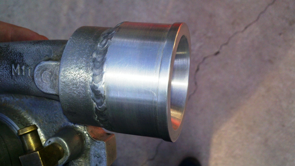

10-28-2012, 11:12 PM #290

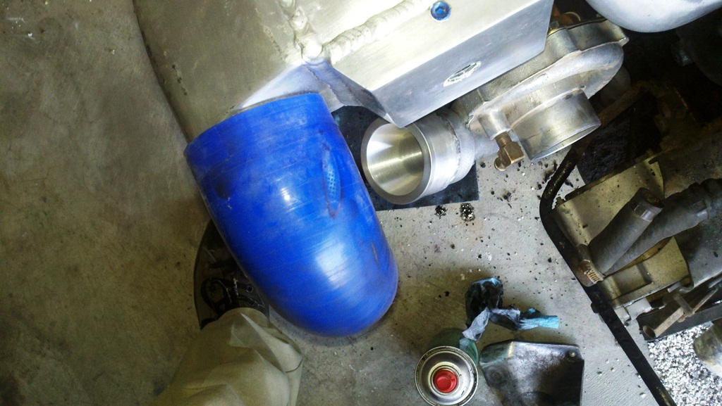

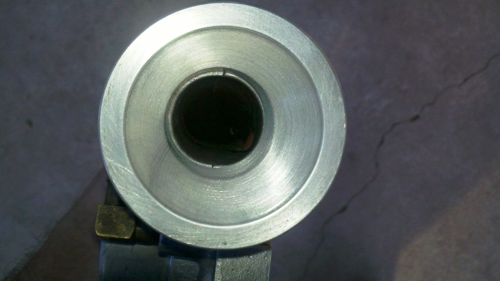

So I got all my plumbing in last week and fab'd up the charge tubing.. Using an AEM dry filter
And Just for fun
This post was last modified: 10-28-2012, 11:13 PM by Captain America.

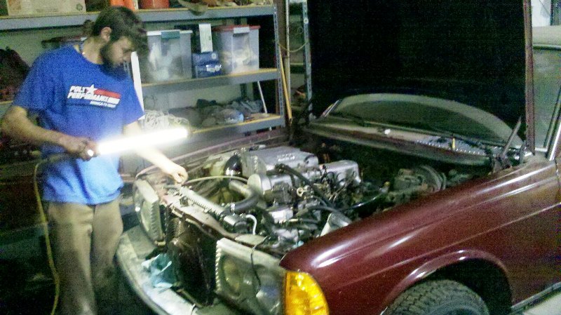

So I got the her running last weekend. Oh man she sounds so good. Peppy as f*ck too! Then started her up cold today, little under 60°, about half a revolution and she was purring along. Just need to get fans mounted to radiator, trans linkage and drive shaft hooked up, then throttle linkage and she should be rollin!
I'll get you more pics too Greazzer
And here I was checking around for leaks as she was coming up to temp..
On a side note, I love backing out the rack damper which causes the motor to lope at idle like my buddies tuned LBZ Duramax Tongue
This post was last modified: 12-04-2012, 02:20 AM by Captain America.
