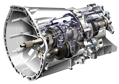

Anyone have any documentation of the 00-02 c230 6 speed going into a w124 om603. Im interested in trying this however i cant seem to figure out what model tranny. 716.633? 716.668? 716.622? which is the toughest.

They are all rated for ~200ftlb. Anyone guess how much they will take, they arn't really modded much. Dual mass flywheel setup isn't cheap. But I like the idea of a 6 speed.

Im willing to try it if i can figure out which model I need. I heard the shift linkage will be a pain.

Yeah the linkage needs to be shortend for W201/W124.

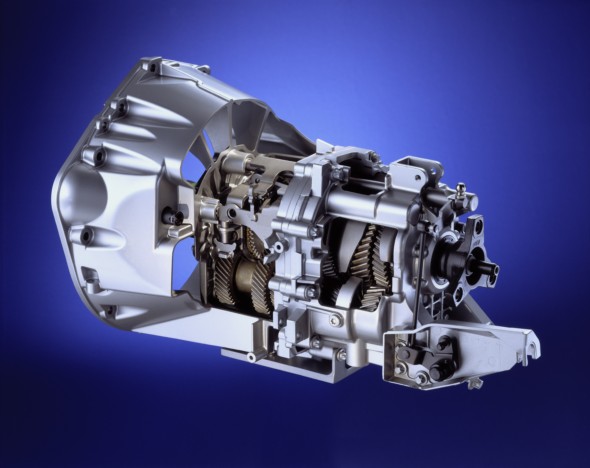

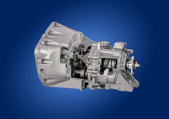

I found some pics of the internals
