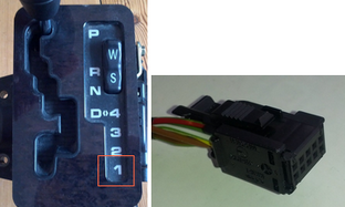

I was reading your document on the controller and the part related to the gear lever,
"Gear Lever and plug (it has to be the one with a “1” see red squre on picture)
And the plug is a 10 pin, and have 8 wire out, thats the one we need
If you are in the Marked for a GearLever, be aware that the GB (RHD), ones is also mirrord, compared to the LHD ones, an other thing is that the one from W210 is longer then the W202, and R129 it is the short that fits the W124 and older G class, "
So, if I find a gear lever set up from a W202 or R129 with the "1" it will bolt in to my W124?

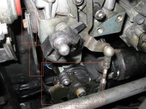

The throttle position sensor from a w210 is needed for the conversion, how did you implement that into your car? I am curious to see how it receives throttle position and then the injection pump also gets input from the cable.
Yes i have heard that the W202 Gearlever should fit in an W124, but to be 100% shure, visit a scrap yard and have the W124 original and a W202 in you hands to compare, meaby someone here knows for sure ?
Regarding TPS sensor.
Think as it this way. the throttle cable is moving the lever on the Injection pump all mechanically. but at the same time throttle cable has to move an TPS sensor, as i need that signal to know the momentum of the engine Hard/soft shift.

Take a good look at this picture, The TPS sensor is mountet below the Crouse controller, by an homemade bracket, but if it not has cruise controle, there is a lot more space to make something special

I see what you did there. You mounted it to the cruise control actuator. Smart!

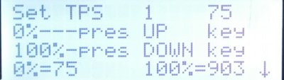

Almost any Potentiometer would work, also linear
1 - 3,5 volt is fine, actually there is a setup TPS menu.
Where you press the joystick up width 0% trottle.
And then flor it and press the joystick down,
Then the controller know the 2 points and transform to 0 - 100% trottle
it do not accept 5 - 0 volt, but just switch the 0 and 5V :-)
This is settings for the MB sensor
0%=75 is 75/1024*5 = 0.37 Volt
100%=903 is 903/1024*5 = 4.41 Volt

I though I saw that you can find a shifter where the tiptronic works to shift. I grabbed a w220 shifter but it has an 8 pin plug and not the 10. Anyone know what shifter I need or if I can get this one to work?
87 300SDL OM606 swapped HE351VE 722.633 swapped, Crower cams, KM valvesprings
76 300TD custom lots of stuff
06 Mercedes CL65 AMG 619 WHP, http://TurboTims.com
TurboTim
12-19-2014, 09:31 AM #98
olefejer
197
12-19-2014, 12:32 PM #99
(12-19-2014, 09:31 AM)TurboTim I though I saw that you can find a shifter where the tiptronic works to shift. I grabbed a w220 shifter but it has an 8 pin plug and not the 10. Anyone know what shifter I need or if I can get this one to work?
Hi Tim
The Only one working rigth away is the PRND4321 type, this has a 10 pin plug where i get information on the position.
But if you set up the Controller to NO GearLever, then the controller can still find out if you are in P/N OR R/D, that is just enogth to have a working system.
Then you can take the GearLever apart and mount 2 microswitches 1 for + upshift and 1 for - downshift, and then connect them to the manual input on controller, that can work, but a bit difficult.
I my oppinion paddle make more sence ;-)
This post was last modified: 12-19-2014, 12:33 PM by olefejer.
1996 MB SL320 Now OM606 7 mm pump elements (myna), KKD manifold, HE341VE, 3,5" downpipe, 3" exhaust, big IC, 722.6 gearbox controller, also controls (Turbo VNT, EGT, BOOST, EGP.)
Hi Tim
Eric78
198
12-19-2014, 06:02 PM #100
What do we do if our gear shifter doesn't have the plug? On nearly all the ones for sale on ebay the plug is just cut off.
Eric78
