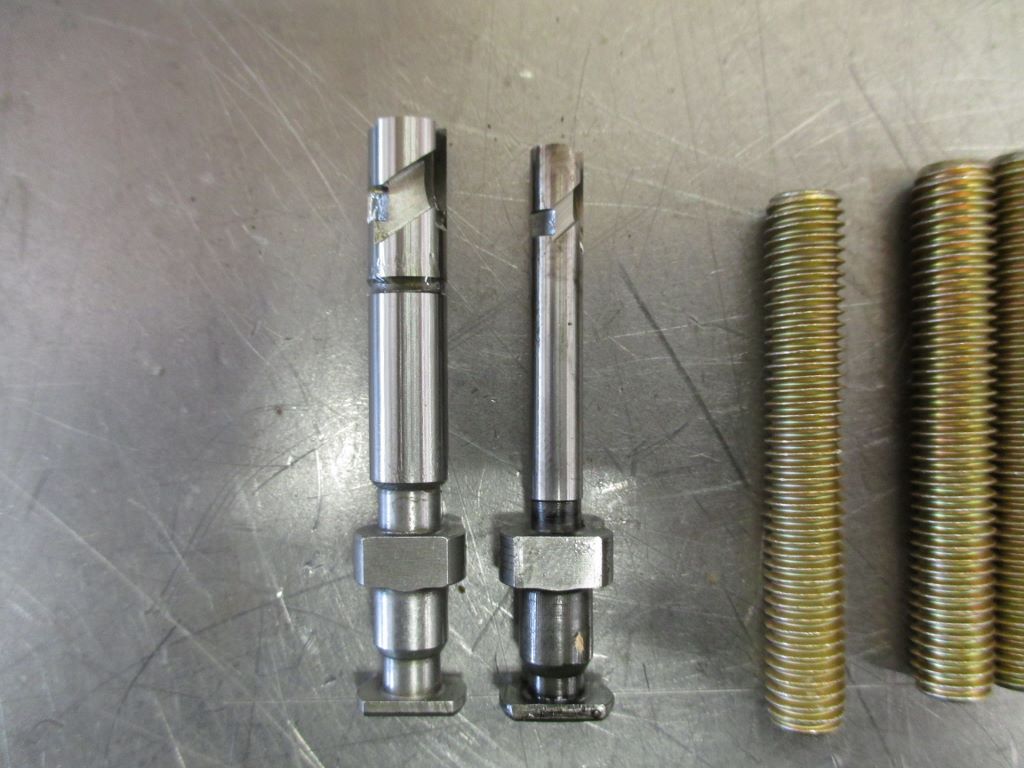

08-08-2014, 08:10 AM #105
Goran
One last question, did you modify the helix groove on the new plungers or used them as they came?
Thanks,

dieselmeken
407
08-08-2014, 11:21 AM #106
I use them as they are. Max 16 mm rack and it works ok. I now have all parts To go ahed and build up a few of these 8 mm mw pumps.

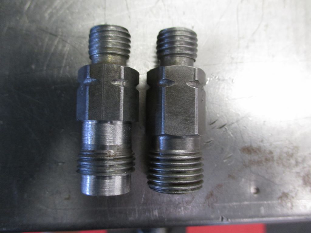

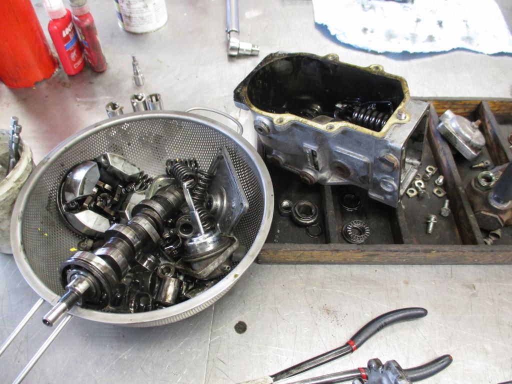

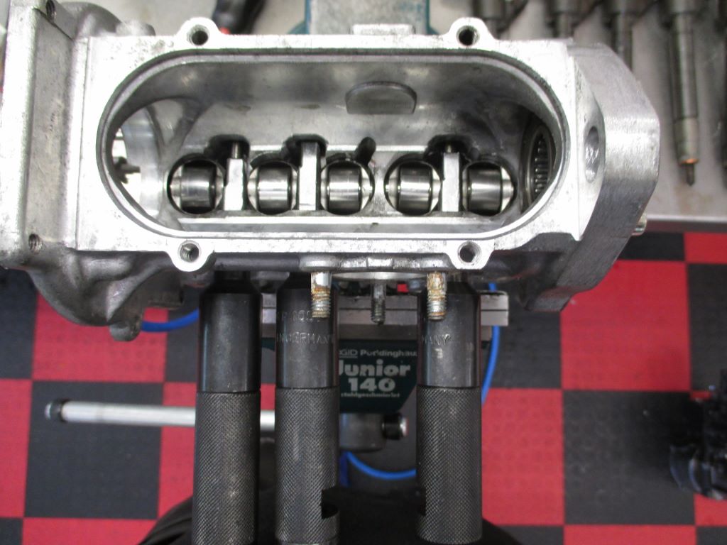

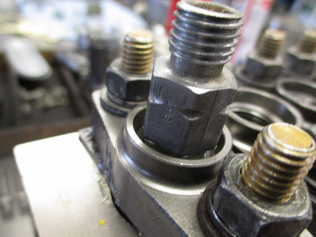

dieselmeken
407

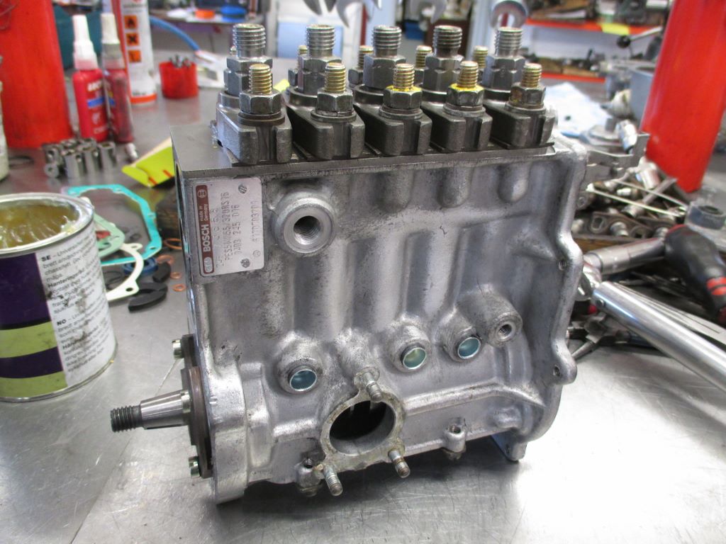

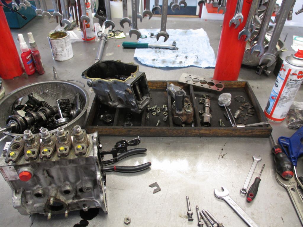

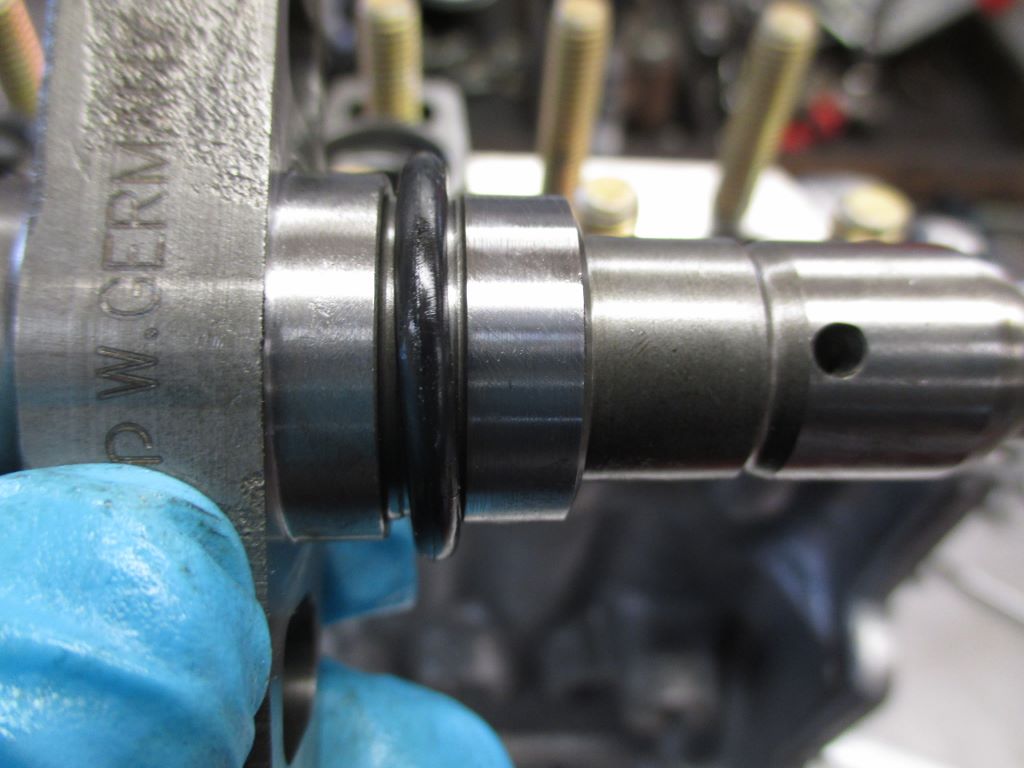

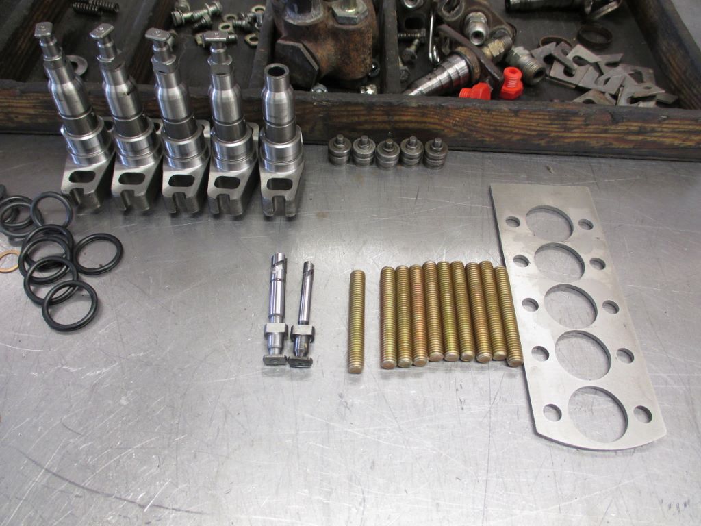

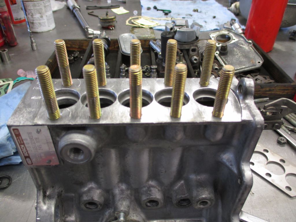

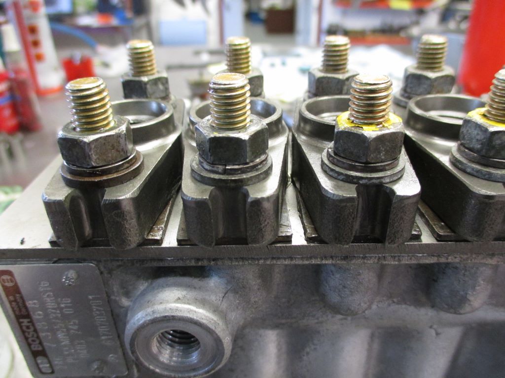

08-14-2014, 12:51 AM #107
I am now at pump #2, Have done some changes to the better I think, Pump will go up in testbench in 1 or 2 weeks, remember, this is a side project.

That thing looks sexy.

And, they say that size doesn't matter.....
