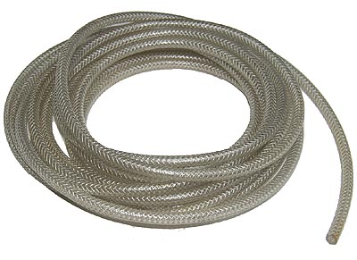

01-22-2010, 09:51 PM #5
Some of the old 80s bmw washer pumps make good pressure I had a 1980 530i and when the nozzle got plugged it made one of the clear reinforced lines bulge up and explode sounded like a gun wet off when it let go!!! must have had good pressure!!!
here's a pic of the hose type not the cheap kind!!!

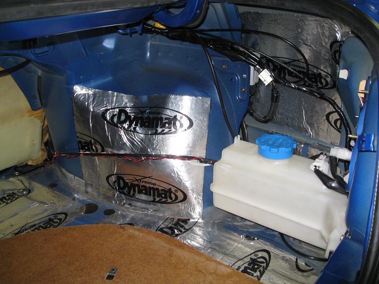

01-22-2010, 10:50 PM #6
The subaru wrx has the tank in the trunk and i believe it doubles as the windshield spray. Id love to do this in my w124 along with a battery relocate. Try and even out the wieght distribution.
