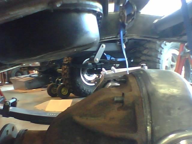

05-24-2011, 08:48 PM #17
(05-21-2011, 08:34 AM)saburai Hi Mr. Manny!
What 4x4 are you putting the om617 in to?
early toyota landcruiser Smile
[Image: merc-05.jpg]

06-08-2011, 02:22 AM #23
[Image: 5811235870_306093d72b_m.jpg]
still no pic of installation. i only get about 3" max up travel before disaster.
i'll need to monitor the heft of the stock bump stops or replace with something more burly.

06-08-2011, 07:41 AM #24
(06-08-2011, 02:22 AM)fj four o [Image: 5811235870_306093d72b_m.jpg]
nice cruiser manny!
thanks Smile
crushing your oil-pan would definitely = disaster
