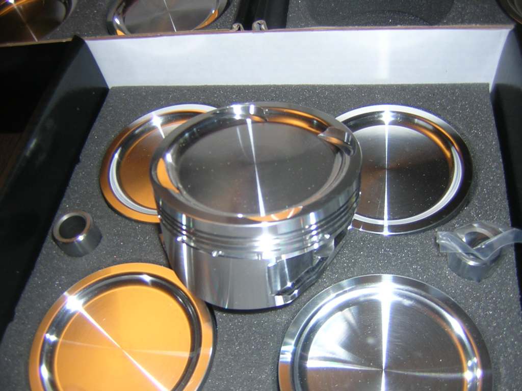

08-03-2010, 04:18 PM #16
WOW, possibly the sexiest pistons I've ever seen!
08-03-2010, 04:51 PM #17
(08-03-2010, 11:24 AM)Graminal95 The 616 is happy to have a turbo, I can't remember when I put my turbo on something like 125K and I now have 175K+ (Odo Stopped). I have had not issues with it so far and it still runs like the day I got it.
On the piston squirter front, I would not use the MB squirter as its a lot of machining to make it work. Instead I would do this
http://www.rallyrace.net/jvab/spgm/index...ional_Mods
and just make sure that they were aligned with the oil hole in the piston.
What kind of turbo did you use on the 616?
Do you have any photos of the setup??Big Grin

Quote:WOW, possibly the sexiest pistons I've ever seen!
Those are the custom ones my friend had made up for Volvo's, that and longer rods reduced reciprocating mass by something like 3-4kg.
The Turbo is a TD04HL and is to big. Came from a Volvo 850 T5.
The set up you can see here.
Falcon radiator and Cosworth intercooler.
