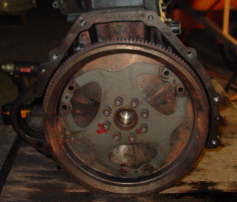

Attached is a picture taken by the seller of the junk NA OM606 engine I'm probably going to buy. The OM606 has the bellhousing cast right into the block...it also has an interesting flywheel/flexplate combo.
Cheers,

10-06-2010, 02:43 PM #17
If you can get me the front part of a bellhousing, I can probe it out and get a good housing pattern.
Would be up to you to get the exact crank position though.

10-06-2010, 02:57 PM #18
(10-06-2010, 02:43 PM)300D50 If you can get me the front part of a bellhousing, I can probe it out and get a good housing pattern.
Thanks for the offer! Do you have access to a CMM setup?
I was thinking of using a vertical mill with a DRO to come up with some measurements.

10-06-2010, 03:34 PM #19
I currently have access to a CMM, just need something that's clean and easily fixtured.
A DRO and an edge finder would work as well, would just need to do the math to get a center point for each hole. Autocad can import points from a spreadsheet in that case, and you can best-fit most of the holes. The critical ones are the dowels, so those should be pinned for diameter/measured with micrometers as well. You can do a good estimate of the crank using only the housing pattern, it's just a bit difficult to explain.
I'd do the probe for nothing since I'm interested in adapting a 60x to my Mitsubishi trans at some point, you'd need to pick up the tab on shipping though. Wink
It all boils down to what is easiest for you.
