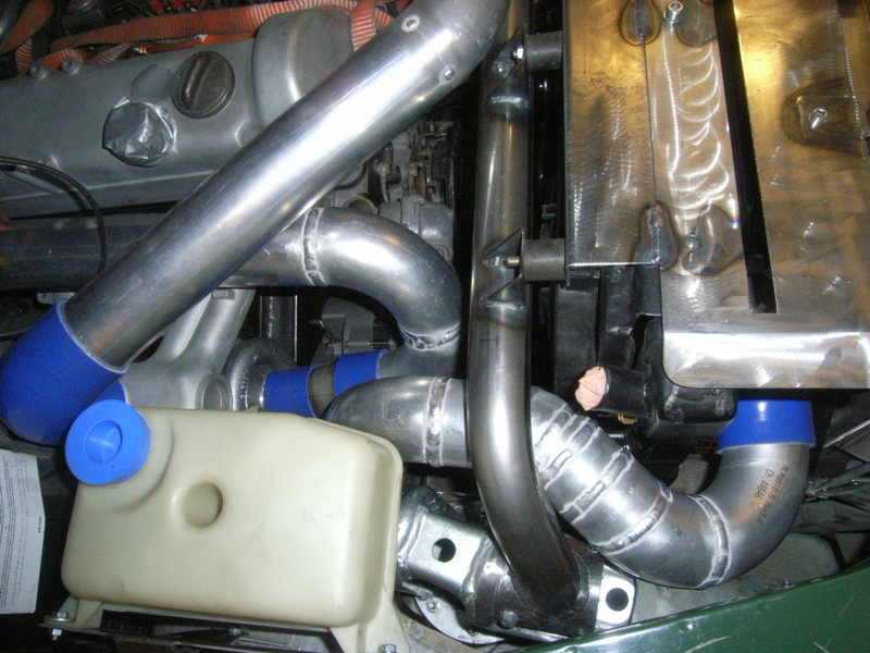

Hi.
Im been building a 617.952 for my Land Rover. This is the second Land Rover I have built with this engine. The first Land Rover was based on a 617.912 but turbo converted by me. I use this engine because of its reability.
The truck was built by me from zero to running.
Hope you find it intresting, please ask if something is unclear.
/Sam

OOOO More pictures! This is pretty interesting. Have any pictures of the VNT control?

01-06-2009, 01:30 PM #3
(01-06-2009, 11:34 AM)winmutt
(01-06-2009, 11:21 AM)sweden Hi.
/Sam

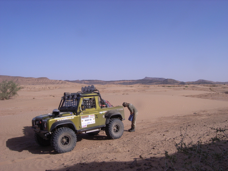

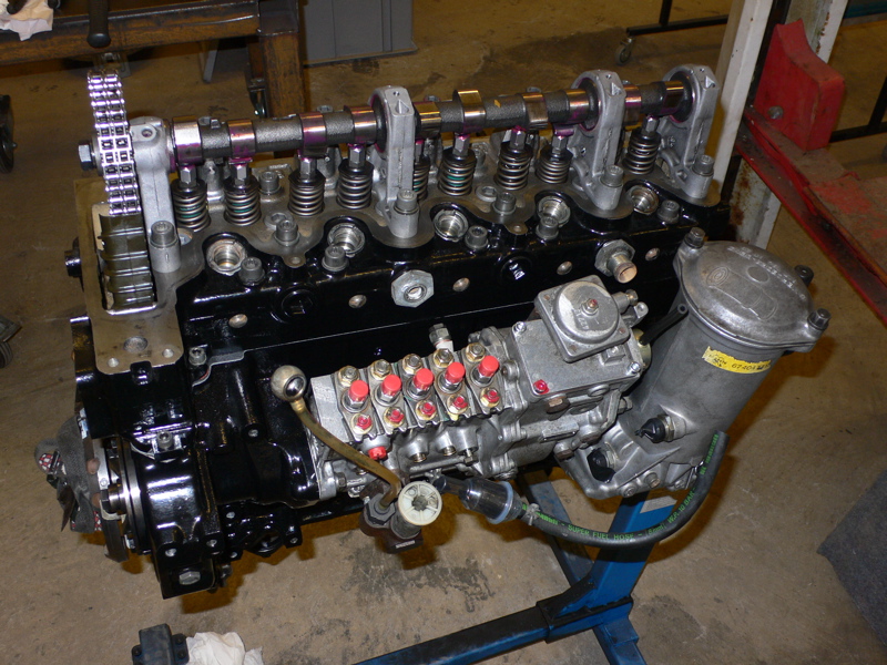

Here is more pics, I dont have a good pic on the VNT control, but will make some pics when changing the pump in a couple of weeks.And a pic from the Morocco desert this spring, competing in Outback Challenge Morocco
/Sam

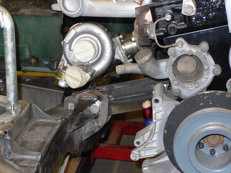

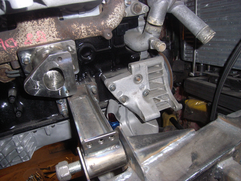

01-06-2009, 11:05 PM #4
Very nice looking work on the turbo adaptor and engine mounts!

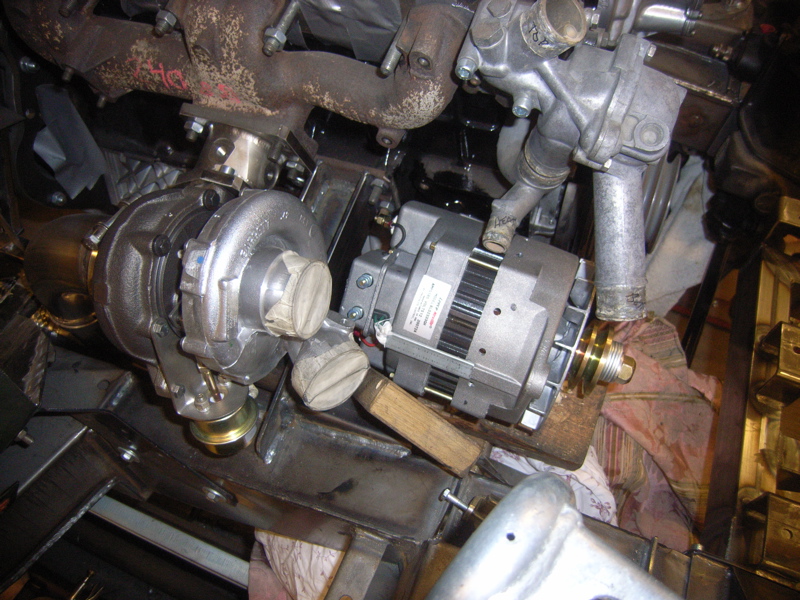

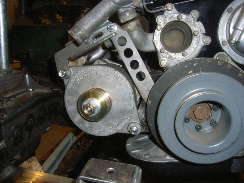

01-07-2009, 04:14 AM #5
Whats going on with that alternator, how many amps does it put out?

01-07-2009, 10:00 AM #6
(01-07-2009, 04:14 AM)ForcedInduction Whats going on with that alternator, how many amps does it put out?
It puts out 185 amps, its brushless, its army proven, and its made in US. 800 Euros.
I do need to change the belts get bigger ones with better friction. I have 2 electric winches on the truck, one in front with twin engines, one winch in the rear with a single engine. 3 batteries total 2400 cranking amps, batteries sits at the rear of the truck to keep weight distrubution as good as possible. All batterie cables are 70 mm2.

01-13-2009, 10:36 AM #7
The alternator is a Leece Neville. It's what they use on class 8 semi trucks for power. Good work on the Rover! It would be awesome to take one of my offroad rigs to Africa to complete! What transmission are you putting behind the 617? Is there something that just bolts up?
