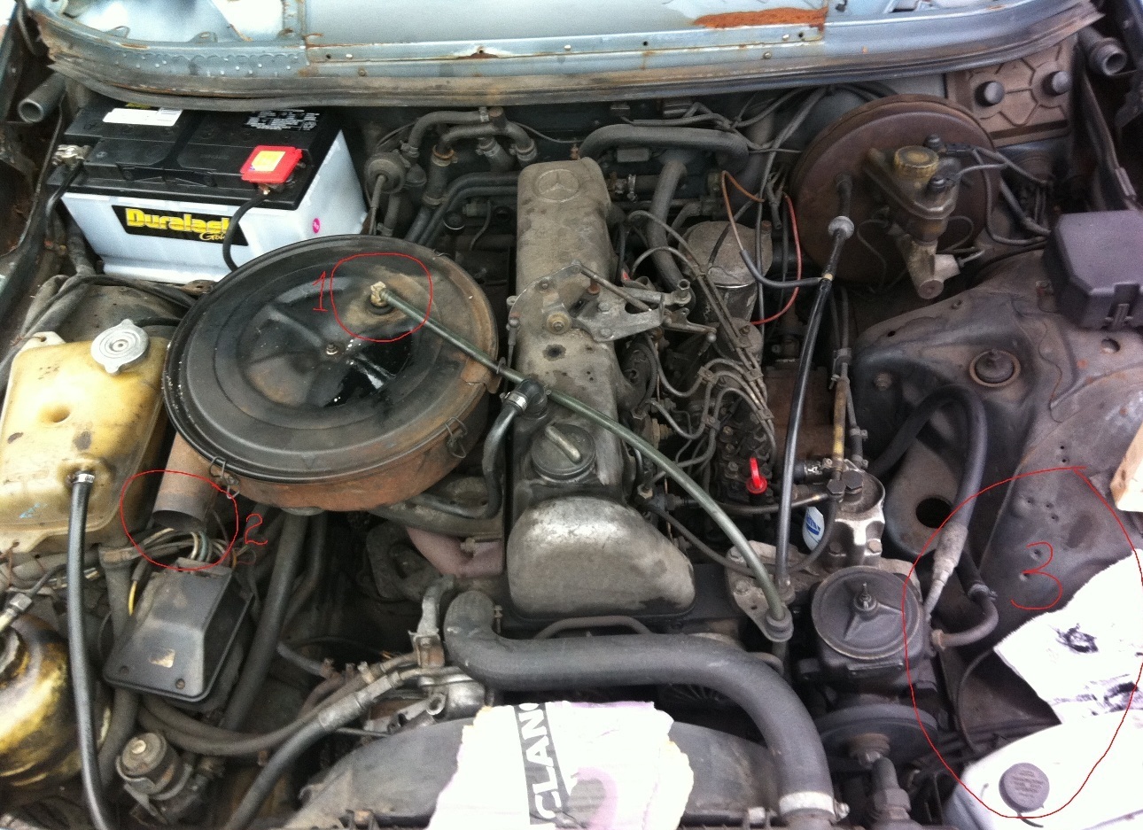

Hi everyone, checking in your forums with my 79 300TD non turbo 617 engine. Previous owners butchered this car, including missing interior, wires instead of door handles, cut hoses capped eith screws, 5" nail locking gas door etc. Please tell me what's missing from this bay and what is that hose at #1? I don't know this engine.

the #1 hose is filtered air from the air filter it goes to the vacuum pump to run almost all accessories like locks,heater and the on off switch to
The #2 is the air inlet in to the air filter there should be a cheap plastic hose connecting it to a small scoop on the rad support above the headlight to get cold air

11-27-2010, 12:59 PM #3
Hmm....
It doesnt look That incomplete!
Nos 1 pipe is the air outlet from the vac. pump. Not all were vented into the crank-case, but passed through a pipe to the air-filter. This is quite normal and nothing to worry about.
Nos 2 as had been said, should have a short plastic concertina-tube --like on a vac. cleaner, attached to a plastic moulded scoop that sits on the front panel above the headlight.
Nos 3 looks like someone's replaced the windscreen washer-bottle with a plastic oil-bottle...Difficult to see in the pic....
Dunno,--But it looks like the accel-cable and part of the accel. linkage is missing, maybe wrong, not used to looking at a LHD car....

11-27-2010, 01:41 PM #4
(11-27-2010, 12:59 PM)Alastair E Dunno,--But it looks like the accel-cable and part of the accel. linkage is missing, maybe wrong, not used to looking at a LHD car....
its probably correct, I had that same setup on an old 79 NA I owned. The linkage for some reason goes clear over to the passenger side low on the firewall, then pivots low near the manifolds with a spring loaded bracket, then up and over like in the pic. Its a weird routing with what seems like a LOT of unnecessary connections.
Maybe its a throwback to when there was a kind of throttle plate setup on the older motors and the linkage moved it? On mine, the linkage did nothing other than move the injection pump lever. Maybe it can be dispensed with and simplified with a 300D turbo linkage?

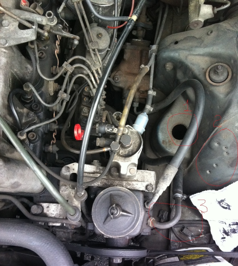

11-28-2010, 09:59 AM #5
Thank you all for the replies. You guys really know this stuff. Here are some shots of the halves of the engine to see better.
On this shot, what's missing or are the holes normal?
On this one, is oil normal to be found on top of that filter cover? Is it comming from that vacuum hose? The hose looks kinda of dirty for just carring air. Also, the connection where hose enters air filter cover is non-existent, that rubber gasket/connector it's so worn out that it does not stay in.
Also, on the last pic, somebody used this threaded rod for something, I think the belt. Is that "ear" piece underneath the nut supposed to be bent like that?

11-28-2010, 10:13 AM #6
1 and 2 are quite normal. The large hole is the centre of the spring-perch to allow a spring-compressor to safely compress road-spring.
The small holes dotted around the inner wheel-house are provisions for mounting various items on different models like the gasser etc. They all used the same inner wings...Quite normal.
Your alternator adjustment bracket has been bent out of shape, prob by adjustment without slackening the alt mount through-bolts first...
Looks like you have a few spare wires, possibly for the windscreen washer thats been replaced by the oil-bottle....

11-28-2010, 11:08 AM #7
or it could be the electric cooling fan for the ac in front of the rad!
