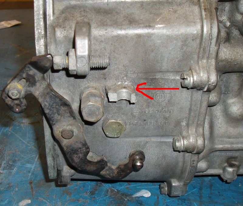

02-24-2011, 06:22 PM #6
Its on the engine side of the injection pump. 14mm lock nut and flatblade screwdriver to adjust. Do not over tighten or you can break off the mount like on this pump.

02-26-2011, 12:55 PM #8
(02-24-2011, 06:23 PM)W116Lorinser
(02-24-2011, 04:05 PM)Captain America
(02-24-2011, 02:05 PM)winmutt Just look with a light. its like a 1" long nut.
You talking about the rack damper?
Someone confirm all this please before i start touching the IP which is something i dont wanna mess with.
Forced showed you in the picture, its the same piece. Except in the picture its just broken off.
