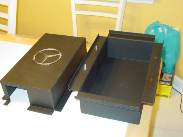

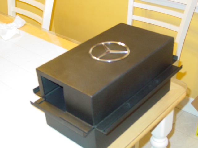

Here the battery box that will be going into my trunk tomorrow. It is 14 gauge mild steel. I will be relocating the battery to the trunk tomorrow. This will clear out a bunch of space in my engine bay, making room for my heat exchanger and other items needed to burn WVO. I got tired of the heat exchanger stuffed into the small pocket next to the washer fluid reservoir. I will post some more pictures of the wire, and the box installed with battery. The next project will be relocating the washer fluid reservoir into the trunk, opposite of the battery box. I want a 3 gallon container so that I can run a water-methanol system. That is my next project.

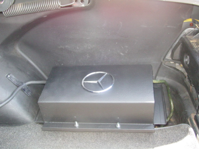

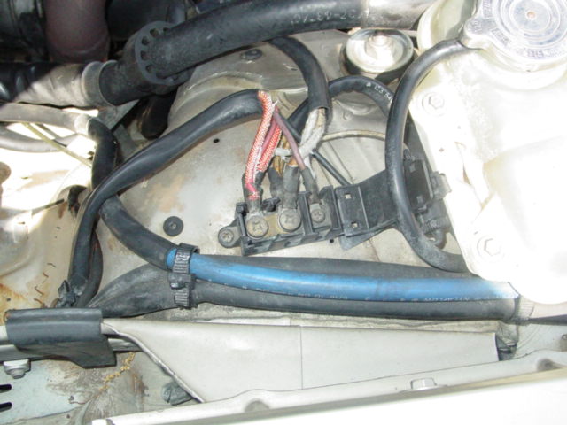

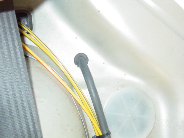

The battery box is in. Here are some pictures that show how I ran the wire, and the final product.
Does anyone know whether or not I need the junction box which I believe is used to remotely turn the engine? If not, I would like to remove it. Please let me know. Thanks.

Looks good in your trunk. My car leaks a bunch of rain on both of those side compartments Sad

Yeah look nice. Mine fill up too. And I'm a tad scared to put the battery there because when I got rear ended, that part got all smashed up!

Thanks. Mine does not leak -- yet. However, in the event it should, I made the box so that it would block out moisture. The box is water tight except for the two openings for the positive and negative battery cables. I plan on putting rubber flaps on both sides where the battery cable exits the cutouts. Other than possibly removing the battery junction box in the engine bay, I think I am done this project.

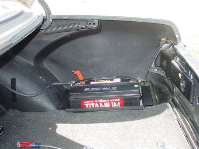

Atleast you kept the spare. Was that a correct size battery or smaller?

It is the correct sized MB battery for the W123. I think they call it a #49 sized battery ??? I think it probably weighs 49 pounds. BTW: I would never get rid of my spare tire.

Interesting, Lance swore a correct one would not fit there.

The box's dimensions are
14" long
8" wide
7 3/4" high
This does not include the flanges that are on all sides of the box
I will double check tonight. I can say that the battery tray only had about 1/2" free space on the "front" and sides, so it must be the "correct" sized battery. I will measure tonight, however.

Group 49 15L 6 7/8W 7 3/16H

I was wrong.The box's dimensions are
14 1/2" x 8" x 7 3/4" and not 14" x 8" x 7 3/4".
I measured the battery and it is 13 3/4" x 6 1/2" x 7"
I also measured the factory battery tray and its OD (to include the curled up part) is 14 1/2" x 8 1/8" (I thought I copied the 2 dimensions for the most part). So, the maximum size for any battery that could fit into this tray would be 14 1/2" x 8 1/8".
I also took a picture of my battery and the label says 49-1. The lower part of the 9 is rubbed off. The picture is horrible --trying to hold a flashlight and taking a picture was tough at night.

I wouldsuggest running a dedicated negative cable in addition to the body/frame ground. Steel is not as good of a cunductor & with the age & corrosion, it would be safer.

I'd go directly to the engine, preferably the starter bolt. The engine ground cable should take care of it from there.

Not owning a Merc at the moment, I would start with checking all ground straps (frame, body & engine), clean with stainless or brass wire brush, possibly replace all external star washers, clean attatchment points & use silicone dielectric grease on all connections.
For your aplication, I would run #2 or #4 from the alternator to the starter mounting bolt, to the main part of the body & then back to the battery. Again, clean all attatchment points & use new star washers with dielectric grease.
Now, you can use regular bearing grease & it should work fine, as all it needs to do is keep oxygen from comming in contact to the metal surfaces ( that way no oxidation can happen to deter current flow).
Also, the bond from the alternator case to the starter mounting bolt can be omitted, but I always just do it.
I don't know the sizing & fusing of your alternator positive wire, but personally, I would upgrade it along with a fuse or fusable link that is compatible with the amperage of the alternator ( or possible alternator upgrade).
The engineers use specific charts to size the wiring as to ampacity & legnth to save on materials & weight. I would just use the commonly found wire ampacity charts for 100 foot legnths to reduce possible resistance.

I went through the firewall where the AC lines would normally be, up the back of the seat under the window deck and the batt is where the spare would be. Maybe I used 15'? IDK haha I followed FI's thread...
