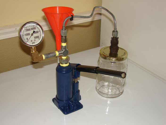

11-15-2008, 03:27 PM #15
I got the nozzles and built a pop tester. So far I have rebuilt 2 of the injectors. I think I will offer a pop test/balancing/spray pattern check for members here. $50/set. My local Injection shop wanted $120/set for this service.

12-04-2008, 08:40 PM #21
bgkast I got the nozzles and built a pop tester.
bgkast.. thats awfully clever.. is that just a cheap hydraulic bottle jack ?
and you are using diesel as the hydraulic fluid ?
or the jack piston is pushing into a cylinder ( pipe screwed onto top of jack ) ?
I may have to build one of those...

GREASY_BEAST
411
12-05-2008, 12:03 AM #22
I built one of those too, I would recommend ordering high-pressure fittings. The ones from the hardware store are only rated to something like 500psi, if that. McMaster has them for a reasonable price. Since the volumes involved are small, I bet pressure would dissipate quickly in the event of a burst, but I wouldn't want to risk it all the same... The bottle jack works a heck of a lot better than the grease gun!!

oel_brenner
have any other pics ?
Yes, just a $6 2 ton jack from harbor freight. I had a spare delivery valve holder turned down and threaded with NPT thread to fit the metric fuel line. I use filtered B5 to test.
I don't have any other pictures, but if you look on the other board there are several threads on how to build them.
