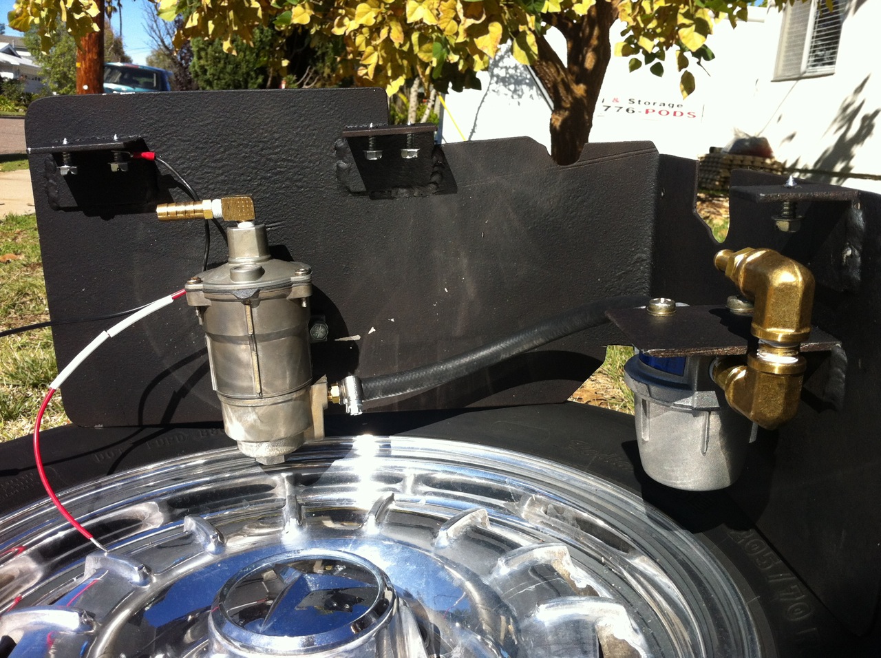

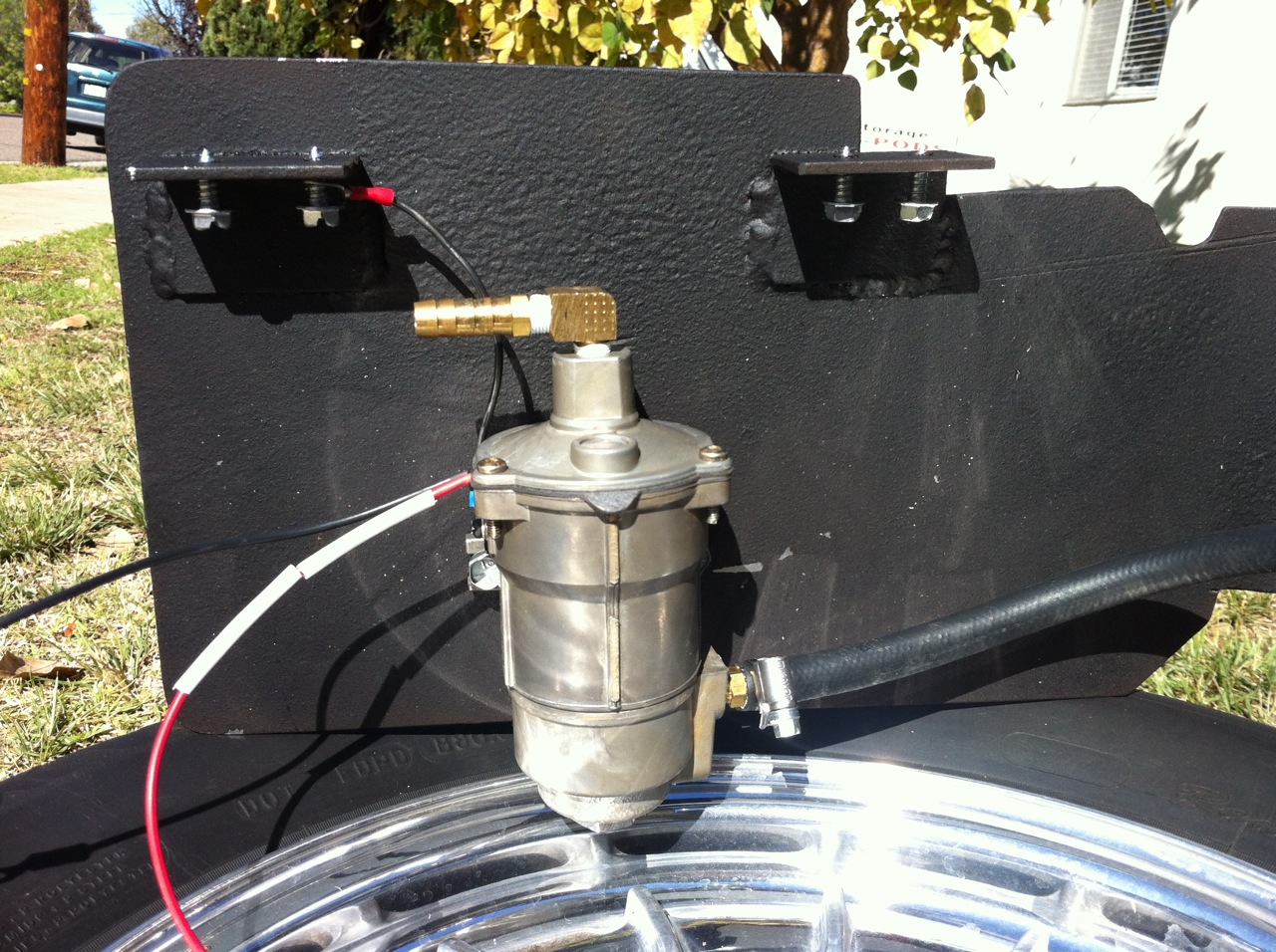

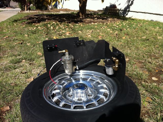

Just finished up installing a new Walbro pump.
Walbro FRC-8 Marine/commercial external fuel pump
60 micron pre-filter
Mercedessource aluminum mounting bracket
I had all the right angle mounting tabs welded on, as well as the one that holds the pre-filter. I then ran a power cable through the interior exiting above the fuel tank and then to the pump. The cable piggybacks off of an ignition powered fuse, (I forgot the # on the fuse box). So it goes on when the key is turned, off when the car is off.
More pictures

what does this fuel pump help to do in this situation?

My mechanical lift pump wasn’t cutting it anymore. At about a 1/4 tank the engine would be starved of fuel, because the pump wasn’t sucking enough.
I have enjoyed the benefits of positive pressure on the LP in my sedan, so I figured it was time to do it too this car also.
In addition, I need an electric pump to run WVO later on.
