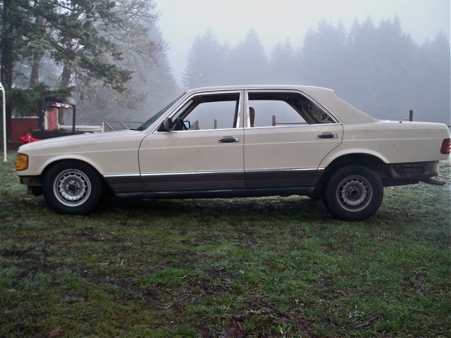

Here's the Benz with the front springs cut. When we dropped it off the jack stands I nearly panicked, did I get the numbers wrong!?!? But it really looks wicked. We're taking it to a friend's shop with a lift to take the back end off, and change the diff fluid at the same time. I'll get better pics uploaded when my computer starts working again.
Top speed is generally 100ish, in the Benz we're probably looking at 85, unless there is a looooooooooong straight. Thanks for the diff info, we're looking into it!

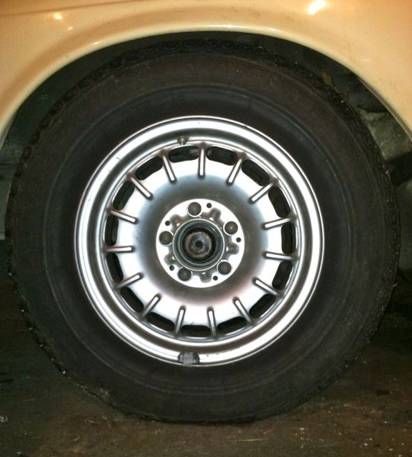

Before and after pictures of the front wheel. We cut 3 springs on a highly lightened car (as in even the sound deadening is gone).

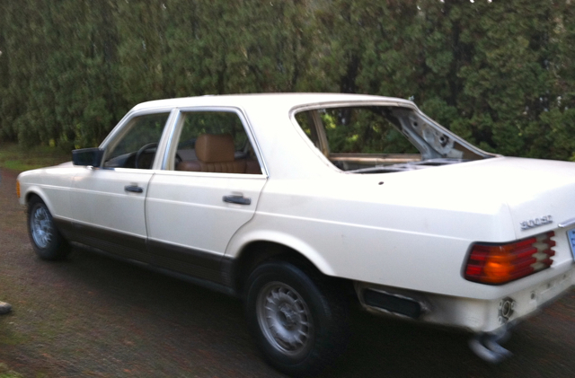

Ok boys, settle down! Yes we have aluminum hood and trunk, so CF would be a negligible weight loss but cool, but too much bling. The judges will see that and look for other cheaty parts, like the oil catch can I'm making out of the AC drier. Smile We're taking it in to get the back half done tomorrow, so I'll have more pics then.
Also, we're looking for added weight loss. Doors are zipped, glass out, sound crap out, we need to keep the DBs at 92, so I don't want to tear off too much exhaust. Any corners that can be stripped that I've missed?
Oh and Garage, Bush Taxi would have been an awesome theme for a chick team! We'll stick with Smokey the Benz for now, but maybe next season!
Here's a better pic we snapped today during our "sunny" weather! Oh an I forgot, we lost a few ounces by (unintentionally) removing the steering wheel bolt. Don't know where the damn thing got to!
