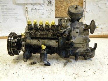

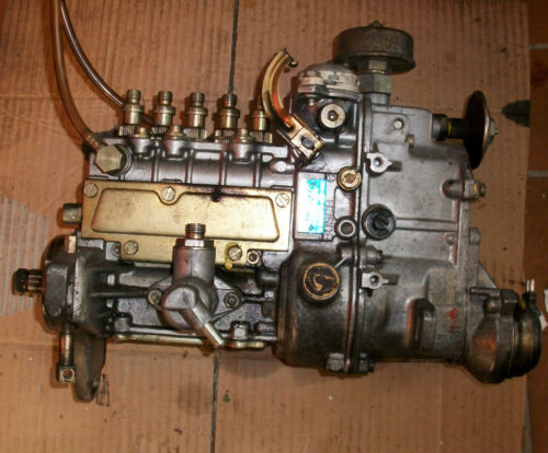

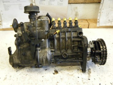

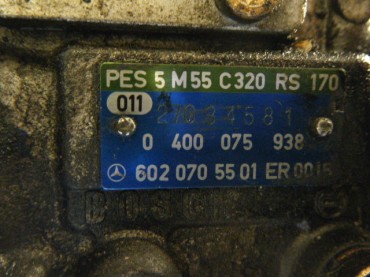

01-30-2012, 03:03 PM #18
quote='tomnik' pid='37941' dateline='1327612577']
Hi,
take any 5 cylinder pump from a 602 engine. Turbo governors have an ALDA which looks similar to n/a ADA but with the difference that the n/a thing has a small tube vertically (whereas the turbo ALDA has an angled small tube that ends horizontally.
Send me the Bosch part number 0 400 75 XXX and I can tell if its a turbo pump.
Tom
[/quote]
hi tom.
i have found a pump on ebay end the guy don't now wich pump it is.
the only number i got is A6020706301.
Bosch Nr 0 400 074 930
[/u]i don't now wich pump i need te bee looking forSad
can you show me an picture of the one i need. for the 605
i found this one in an local shop.
nr. 0400075938
This post was last modified: 01-30-2012, 03:19 PM by jan v deelen.

hi tom.
nr. 0400075938

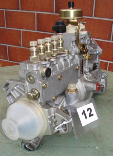

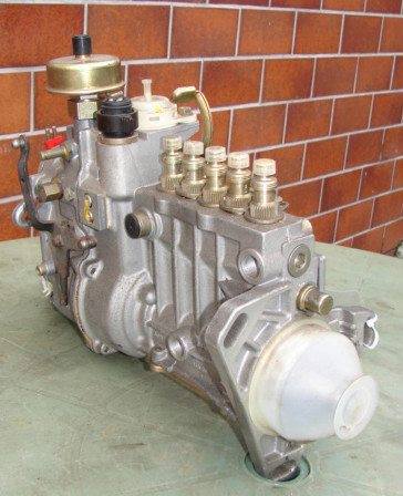

#12 is a turbo IP for auto transmission.
the second one is from a shifter (the thing on the lower backside).
According to the part number it should also be turbo.
Tom
tomnik
01-30-2012, 05:42 PM #19

They both look like NA pumps, based of the ADA instead of ALDA.

(01-30-2012, 06:21 PM)aaa They both look like NA pumps, based of the ADA instead of ALDA.
this is new style ALDA.

01-31-2012, 02:37 PM #22
i found this fuel pump on the internet. bosch nr. 0400075938
it looks like an NA pump.
i want to now what to do whit the electric part on the lower back.?
