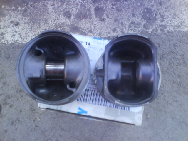

04-28-2009, 02:34 PM #2
Its doable but don't expect it to last as long or hold as much power as a real turbo engine.
The 16valve engine is an OM604, nonexistent in the USA and it would be a great engine to start with compared to the 601/2/3. You're very lucky to live in Norway, those engines are common over there, all we ever find in the yards are 616/7 and the occasional rare 601/2/3.
Here is a comparison of the turbo and non-turbo rod and piston in the om604/5/6.
