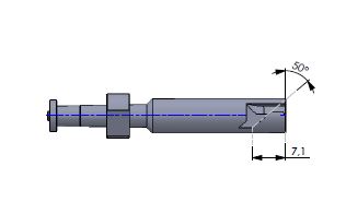

As some of you here on the STD forum knows, I have been struggling with making my own pumpelement for the M-seriepump. I want to reveal some facts what I have done the last year.
Previously I have done pumps with the "old" 7 mm Ford Transit element, Also with the 6 mm original OM606 element. My opinion was that the 7 mm didnt work out well at all, High knock at low idle, high fuelconsumption max 120cc was some of the disadvantages with those.
6 mm was running perfect, good balance nice idle and so on.
After those pumps my customers wanted moore fuel, Myna was running 170cc with there own 7 mm element, However I could not buy those, Myna dont sell element only, they just put them in there own pumps. The explanation I got was that
-It is some difference in quality.
At this moment I have around 10-15 pumps waiting for nice, big element whit a lot of fuel.
Something had to bee done
I started do design the first serie of 7,5 mm element, It took around 3 months for the factory to make them for me.
At this moment I have payed around 8000 euro.
After 4 months the goods arriwed, I was glad for about 4,5 minute, then everything went to ****.
Barrel was too big, didnt even fit in the pumphousing, plunger was 0,15mm to long, The plunger could not go to top in the pump, it was stuck.
This however I could fix, my friend, who has a mechanical workshop helped me.
Barrels was grinded down to right dimensions so that they fitted in the housing, plunger was modified so that I could mount them in the pump.
First pump was 2,5 degrees wrong in phasing, That was no big deal, but it gave me a lot of extra work, changing rollers in the tappet lifter so the balance was OK.
Next thing was fuelquantity, I was expecting a bit over 170cc but no.
140-150 cc was max at 21mm of rack BUT, It had capacity for OVER 200cc
The "only" thing was that the helixangel on the element was to flat, I would need around 25-26 mm of rack to get 100% out of the element.
80 elements where adjusted, 10pc of 140cc pumps was built with good result. I bougt a 250TD with OM605 just for testing the pumpelements properly.
Rest of the elements where shipped back to the factory for modification.
Serie 2 was up on drawingtable, wise from the first serie I know now how it should bee designed, Serie 2 has som benefits that serie 1 dont have.
Here is a small teaser
50 days from today and serie 2 will arriwe for testing. After that gentlemen, I think that I can offer you some nice pumps.
140cc & a bit moore.

Thanks for all of your hard work! And for posting on this forum. I'm excited to see how this works out I'll have to start saving up for a custom pump!
Schttttoked!
(02-28-2012, 01:39 AM)pp d Well... I made a pump with 150 cc delivery for Tom, sent it about a week ago.
No need such thing as 20-21 mm track travel
(02-28-2012, 02:13 AM)dieselmeken(02-28-2012, 01:39 AM)pp d Well... I made a pump with 150 cc delivery for Tom, sent it about a week ago.
Ofcourse you did. You get a element that works in the first place, You can buy element from Tom, How hard can it bee then? You dont design, you just build the pump.
Toms element is nice if you dont need moore fuel that 140-.150cc, My customers building high performance engine, just as the topic says, and then Toms element is not enough
Im trying to explain how difficult this is, I dont need any devaluation.
I think this is going to workout perfect, just you wait and see.

(02-28-2012, 05:26 PM)tomnik ...
Now my new prototype delivers 150 ccm but still respecting the safe range of the Bosch book and standard rack travel and standard governor operation....
Tom
Tom
