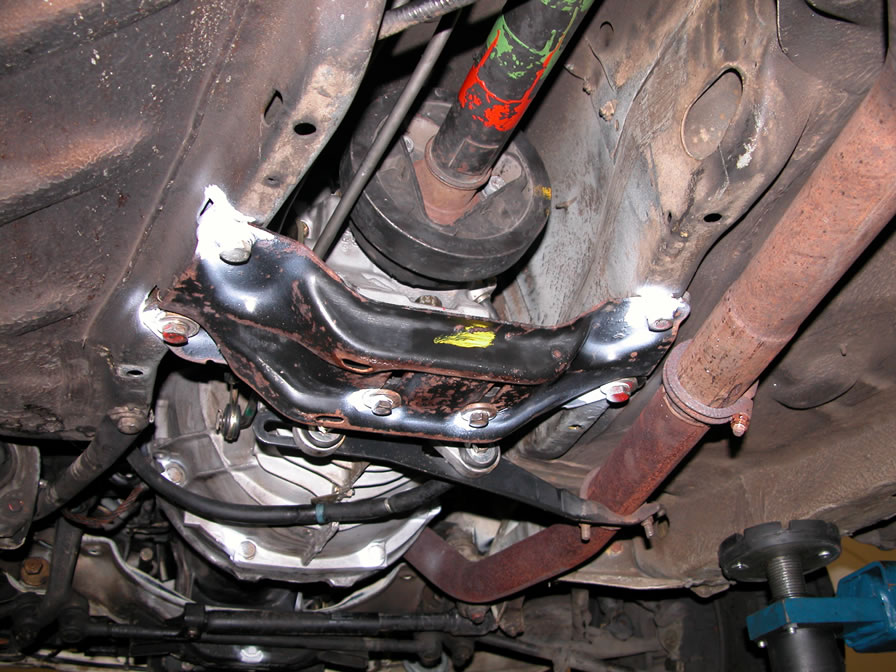

05-27-2009, 12:53 PM #7
The vibration around 1500rpm is actually resonating. MB put a damper on the driveshaft to help solve that problem.
That part is no longer available new (I tried) and the suggested repair by MB is to leave it off. The best solution is to try and not run the engine in that 1000-1500rpm RPM range anyways since its well below its torque peak.

07-12-2009, 02:29 PM #11
(05-27-2009, 12:53 PM)ForcedInduction The vibration around 1500rpm is actually resonating. MB put a damper on the driveshaft to help solve that problem.
Hey FI, is this installed on your car, or did you snag this pic from elsewhere?

07-12-2009, 04:26 PM #12
Its from elsewhere.
I've got a damper from a euro 300D, I'm using the driveshaft from said euro but I didn't have the time to slightly bend the linkages to clear the damper when I was installing the new tranny (I still use modified 240D linkages, not the euro).

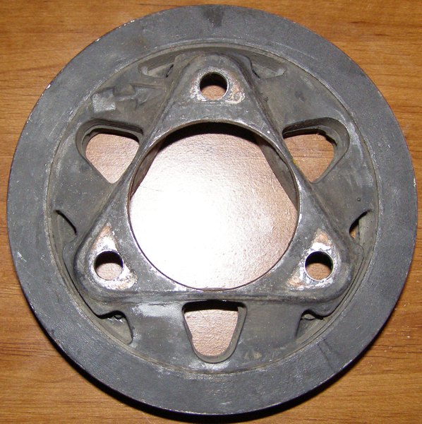

10-26-2009, 06:38 PM #17
(07-12-2009, 04:26 PM)ForcedInduction I've got a damper from a euro 300D, I'm using the driveshaft from said euro but I didn't have the time to slightly bend the linkages to clear the damper when I was installing the new tranny (I still use modified 240D linkages, not the euro).
Hey man, I was just thinking about a place that makes custom polyurethane bushings/motor mounts etc. If you would be willing to send in your damper to them, I bet we could have them reproduce it in poly. They can match the durometer rating and/or make it stiffer or more squishy. They can probably even make one that will clear all the stock linkage stuff, as long as you tell them what needs to be trimmed I bet they can do it. Lemme know if youre intersted in that and Ill either post the dudes contact info and/or give him a call to see if he can do it.
does your damper replace the front flex disc too? I think I remember you posting somewhere that its a totally separate part. Anyway, they could possibly make one that is all one piece as well, if that would be better.

10-26-2009, 07:26 PM #18
Its a different part that bolts onto the back of the tri-flange. The driveshaft has to be pulled out of the slip joint to install it.

10-27-2009, 05:49 AM #19

10-27-2009, 03:18 PM #20
(10-27-2009, 05:49 AM)SurfRodder i emailed the dude and sent him the picture above to see if he thinks it's feasible/what price... if he thinks he can make them for ~100 bux, would you send him the original?
I'll have to track it down. I've got the 280E 5-speed's damper here but I don't have the 300D's at the moment. Its probably buried in one of my toolbox drawers.

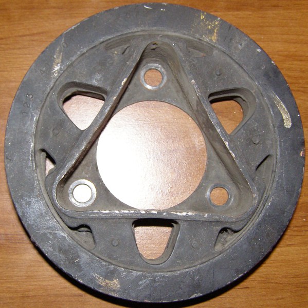

10-27-2009, 10:39 PM #21
(10-27-2009, 03:18 PM)ForcedInduction I'll have to track it down. I've got the 280E 5-speed's damper here but I don't have the 300D's at the moment. Its probably buried in one of my toolbox drawers.
cool.. the dude is on the road for a few days, but he will get back to me when he gets back.
another thing, how is it constructed? Is it just a couple of sleeves going thru the rubber or are they retained by a plate in the middle to keep from walking?

10-28-2009, 12:03 AM #22
The 300D model has a larger OD

10-29-2009, 12:45 PM #23
I never noticed that arrow before!
