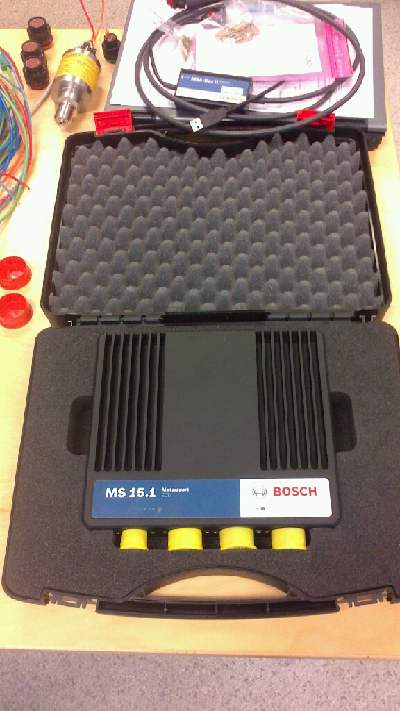

I work at a university in Norway. Here we are planning to build a engine test facility. It is supposed to be used for emission research and student demonstrations.
And therefore i have bought a OM613 engine from a E320cdi -2000.
It's supposed to run against a water brake (without a transmission) and controlled/monitored from a computer.
The problem is to get it to start! I have the electronic key and electronic unit. But when i asked bosch, they said that without the transmission, the engine won't start. So i did a research on ECU flashing, and was told to buy Galletto flasher and send the ECU data to a guy for reprogramming.
Bought the ECU flasher, but it did not communicate with the ECU Sad To be sure the ECU was actually working, i tested with ProScan (which i had experience with from before) and managed to read the throttle position, MAF, MAP and so on.
I got another suggestion that i should open the ECU and then connect a pin on the flash to ground, to force some boot-mode or something. No luck.
Got in contact with a guy that offered to come and watch my setup, but got an e-mail a little later when he had done some research, and told me that the immobilizer is fucking with me since i dont have the instrument cluster.
Does anyone have a solution for this problem? De-solder the flash and buy another flasher tool? Or is an aftermarket ECU the only solution?

11-09-2012, 11:49 AM #12
You just need to either transmit a CAN message with a device like PCAN for Neutral safety or use a shifter and etc module on the can bus. This will get you started. But you will have to transmit vehicle speed also or you will not be able to rev very high or get full power.

11-09-2012, 08:34 PM #16
to start you need to transmit id218 byte 3 hex dd. id 200 and 208 bytes 7/8 veh speed. the divisor is 2.56 so decimal 2560 is 100mph. I do not know which value is required and how much for allowing revs. 7 and 8 are individual wheel speed values so it is id200 7 is lf and 8 is rf wheel.

02-01-2013, 04:58 AM #35
I've got the MS15.1
Bosch Motorsport
A little worried that i dont have enough experience to calibrate it, but luckily a very good guidance is following.
Department of Energy and Process Engineering - OM613 - Bosch Motorsport

Theo Munckhof
02-12-2013, 03:59 PM #38
Hello Steinkr,
If needed I can offer support on the MS15.1 application work and or hardware. Work with it since 2007.
You got a PM
tmunckhof@yahoo.com
Best regards,
Theo v/d Munckhof
[Image: MS151_zpsf881edb3.jpg]
[Image: MS151_bench_zpse35a84a5.jpg]

I need the correct opening time (uS) with fuel delivery (mm3/inj) @ current fuel pressure (MPa).
I have tried to get this information from Bosch, but the are not willing to help. They say this is confedential.
I use the Modas Sport from Bosch and i think its pretty easy to use. I would not hesitate to recomend it. What kind of project do you have?
