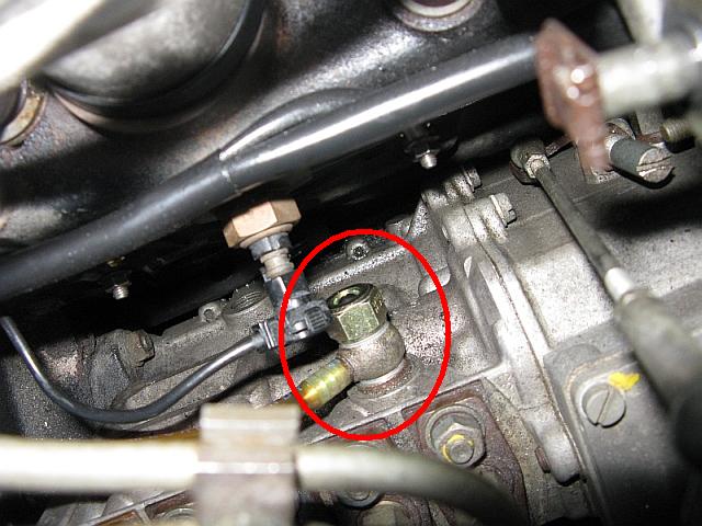

I bought this car 2 weeks ago. 82 300d with 263k. I bought it knowing it had trouble starting and wouldn't idle. Previous owner ran some sort of WVO in it. I plan to swap into my 2000 2wd s10 when I get it running properly.
I've done A LOT of reading on here and other sites. I believe I need to check timing now, but here is a list of things I have done so far.
1. Adjust valves
2. Tested old glow plugs. I replaced all 5 and verified that they are working properly.
3. Replaced hand primer pump with updated black handle pump from junk yard.
4. Removed injection lines and cleaned them out at work in out solvent tank. I also removed injectors and pop tested them. All 5 were just streams of fuel rather than the mist. I found injectors at the junk yard with new looking nozzles. Bought them, took them home and pop tested them. All 5 junk yard injectors were 'like new' with almost perfect mist so I installed them. (After compression test, #6)
5. Removed delivery valves from engine. They were gummed up and pretty nasty. I replaced them with the junk yard delivery valves. These were in very nice shape and very clean so I figured why not.
6. Compression test. Not as high as I would like to have seen them, but high enough for it to run.
7. Before installing the injection lines, I turned over the engine with the starter, WOT. Fuel was obviously coming out of the delivery valves, but #1 was more of a dribble and the others didn't seem to have much pressure. (or as much as I thought they would/should)
So am I to checking timing and/or replacing IP? I've read that it is very rare for an IP to go bad, but with #7 issues, maybe that is where I should be looking?
Thanks for your help!

If the PO ran junky grease and didn't run WVO correctly, you might have that crap causing a stoppage or a problem somewhere. WVO's chemistry is unique and that stuff can rubberize into some of the toughest stuff to get rid of. Personally, I love burning WVO but you will see folks come out of the woodwork to point out that's bad. So ...
I know folks are going to scream bloody murder, but have you thought about giving it the tiniest shot of something flammable. Not ether, but something not as "explosive". That might give it its boost. Caution however with this suggestion. Folks claim one super tiny blast will destroy an engine. I have never seen that, so who knows.

12-03-2012, 09:09 PM #3
(12-03-2012, 08:57 PM)Greazzer I know folks are going to scream bloody murder, but have you thought about giving it the tiniest shot of something flammable. Not ether, but something not as "explosive". That might give it its boost. Caution however with this suggestion. Folks claim one super tiny blast will destroy an engine. I have never seen that, so who knows.
I've had the glow plugs disconnected and the can of ether in my had, but was unsure about it. I read that it was a no no on these engines, but I don't really see what the difference is. I've worked in the fleet dept of the 'red and white label pop company' for years now and we use the stuff to start our semis all the time. I also had an idi ford a few inters back and a sniff of the ether bunny would bring it to life even on thee coldest days.
What other stuff would you suggest? Brake cleaner?
I wounder if Diesel Purge would help out with the clog? I suppose I need to get it running before that though, right?

12-03-2012, 09:19 PM #4
so will it not start at all? Or just runs shitty?
do you have a block heater?
do you have a lot of battery on it?
I have a easier time starting with the block heated and if I hook up 2 of the 12v batteries to the starter.
Gets a lot better cranking speed then Wink
I would pass on the ether.

12-03-2012, 09:27 PM #5
I would try to remove the steel lines (one assembly) and boil them in an old steel pot then blast them with compressed air. Real heat is the only thing that really gets rid of rubberized grease. Gas works too if you soak it long enough. I would set up a temporary tank out of an old juice bottle, 64 ouncer up front so you know your source of fuel. I would try to clean every aspect of the fueling system. I know it's a PITA, but once you get fuel, and you got compression, you should be up and running. I have burned a ton of grease in the past 4 years and I know that crap turns into the world's strongest rubber like goo and it really clings like death to parts if not properly burned and handled.
I have used generic carb cleaner. It's not super volitle but its flammable. I am talking about a micro squirt.
I am not proud to admit it, but I used to own a 1984 Chevy Chevette with a Isuzu Diesel Engine. I used ether every day when I lived up north for years and never an issue. That car got over 200K miles before the old girl just died one day in the summer so I doubt it had anything to do with the ether. BUT, as I suggest, be cautious. People claim that one tiny tiny squirt and all 5 rods will shoot out the block ...

12-03-2012, 09:52 PM #6
NEVER let an engine ingest brake cleaner-the chlorine will kill it. I don't care if it's labeled as chorline free just don't do it.
WD40 is a "safe alternative to ether"
Sounds like the IP is gunked up-can you try running it on lubrimoly diesel purge cleaner stuff from a jar instead of diesel? That should also let it start easier
Heading the engine before starting (torpedo heater does the job real well) will make it spin over 500x
Glad to hear where you've started, those are all very educated places to look.
Have you replaced the spin-on fuel filter?

12-03-2012, 11:11 PM #8
(12-03-2012, 09:19 PM)larsalan so will it not start at all? Or just runs shitty?
Yes, it has a block heater. I have not tried it though. And it doesn't want to start, but it does crank slower than what I think it should. I bet 2 batts make it spin over really quick. Haha
(12-03-2012, 09:27 PM)Greazzer I would try to remove the steel lines (one assembly) and boil them in an old steel pot then blast them with compressed air. Real heat is the only thing that really gets rid of rubberized grease. Gas works too if you soak it long enough. I would set up a temporary tank out of an old juice bottle, 64 ouncer up front so you know your source of fuel. I would try to clean every aspect of the fueling system. I know it's a PITA, but once you get fuel, and you got compression, you should be up and running. I have burned a ton of grease in the past 4 years and I know that crap turns into the world's strongest rubber like goo and it really clings like death to parts if not properly burned and handled.
I took the steal lines off as an assy. Cleaned them out with compressed air at the shop, then used brake cleaner and heated solvent. Dried off using compressed air. Then they sat for a few days before I installed them again. They should be pretty clean inside. Really the only part of the fuel system that I haven't changed or cleaned out in some way is the IP. Also I have a gallon jug that I am running the fuel lines to. Completely bypassing the factory tank and fuel lines.
(12-03-2012, 09:52 PM)Simpler=Better NEVER let an engine ingest brake cleaner-the chlorine will kill it. I don't care if it's labeled as chorline free just don't do it.
Yes I've replaced both filters. Spin on and in line. I don't have a heater big enough to do the job, but ill plug in the block heater when I vet home.
Also thanks for the wd40 tip.

Did you check the overflow valve on the pump?
Gruß

(12-04-2012, 05:06 PM)Volker407 Did you check the overflow valve on the pump?
Gruß
Volker
Elaborate please, I don't know much about these pumps.

The overflow valve on the pump keeps the inside of the pump under feed pressure of ~1,2bar. If it doesn´t work correct the feed pressure is too low and you might have starting issues because the elements do not get filled properly.
Cylinder #1 is the last in the feed line so if you have less fuel there that would fit to a bad overflow valve scenario in theory.
Gruß
Volker

(12-05-2012, 03:07 AM)Volker407 The overflow valve on the pump keeps the inside of the pump under feed pressure of ~1,2bar. If it doesn´t work correct the feed pressure is too low and you might have starting issues because the elements do not get filled properly.
Gruß
Volker
Perfect! Thank you! Ill look into that.

12-05-2012, 07:52 AM #17
[/quote]
[/quote]
Hopefully you have the type that you can take apart and stretch the spring so you can get some more pressure in the ol girl Wink

(12-05-2012, 07:52 AM)MFSuper90 Hopefully you have the type that you can take apart and stretch the spring so you can get some more pressure in the ol girl Wink
That's my plan. I'm going out here in a few to try it.

12-05-2012, 09:03 PM #19
Pulled it off, took it apart and stretched the spring. Cleaned it up (had A LOT of crap inside it) Put it back in and cranked the engine. Seemed to help a little but still not as much flow from #1 as the others. Took the DVs back out just to make sure I installed them correctly and they were. I think I need to adjust the pump linkage. Seems that with my foot off the throttle, it doesn't pump at all and with my foot pressing down on the pedal a little and it squirts.
I think I should put an IP on it. With how gummed up the original DVs were and now seeing how gummed up the overflow valve was, I can only imagine how nasty inside the pump is.
Anyone have a link for IP removal? I read that you have to pull the oil filter housing off, but cant find any info on if I have to remove the nut on the front of the IP shaft or if it just slides out when removing the pump bolts on the outside. Huh
Thanks for your help so far guys! Keep it coming!

You do have air in the lines. Check the crush washers on the spin-on filter connection-they might be leaking.

Pump the primer pump like 50 times after you disconnect any lines! until is almost impossible to pump any more then try and start. I have also pumped while cranking to help push more fuel in there.
