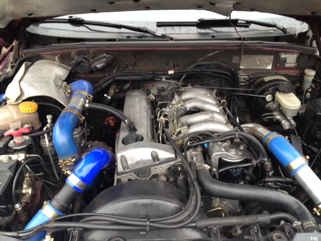

Instad of linear pump of OM602, changed to VE pump
offroaddieselhu
11-01-2013, 07:07 AM #1

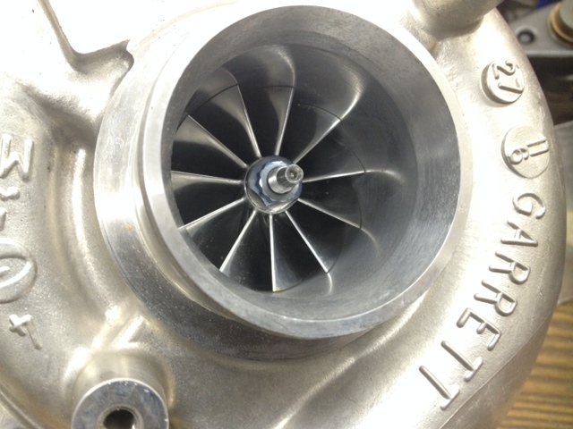

Om602 GTB2260
This is a "fully rev car" (total tunnnin according to the owner of car)
Look the video Big Grin

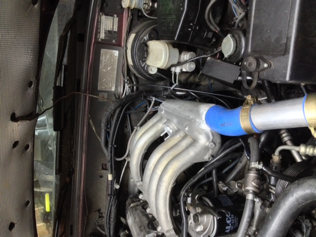

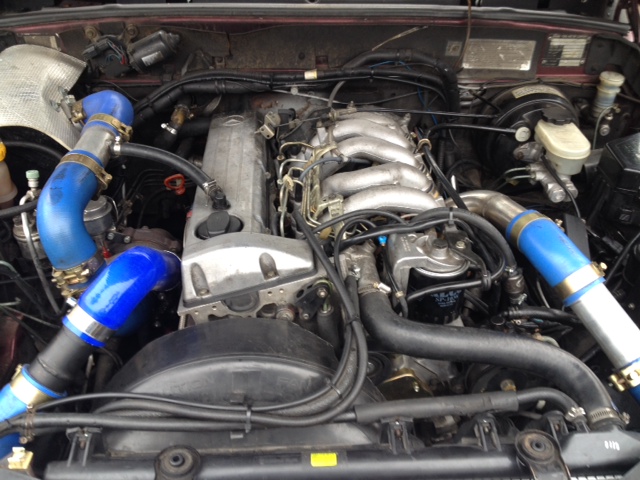

Well first its not a 602 but a 662 2,9 L engine in the SsangYong second the 1 one the picture is a NA model with a aftermarket or homemade turbo/intercooler set on it
my own 2,9 OE turbo intercooler is much faster than the car in the video only with max fuel pump setting and KN filter
but nice project what pump are you using Audi/ VW 2,5 TDI or the older IDI version
what are the power goals and are you getting it on the dyno.

Hi,
The 2.5 audi's pump rotate on the oposite direction as this (original) engine.
I'd like about 200 HP. (without smoke)

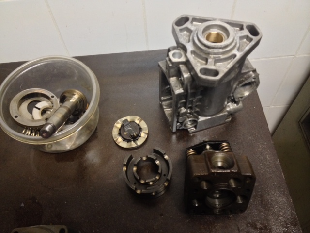

parts
offroaddiesel
parts
offroddieselhu

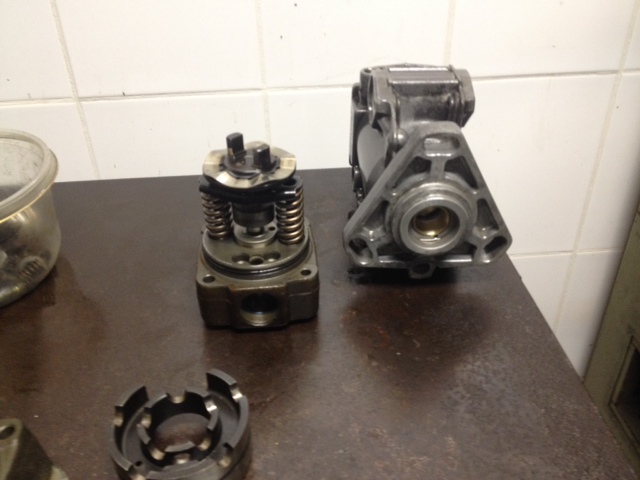

12-14-2013, 01:37 PM #6
parts
offroaddiesel
parts
offroddieselhu

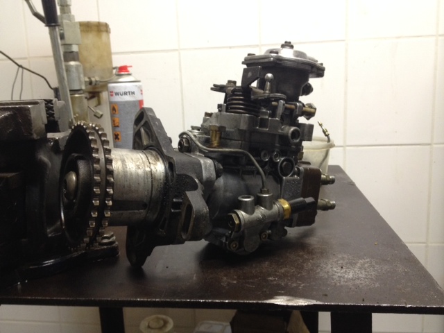

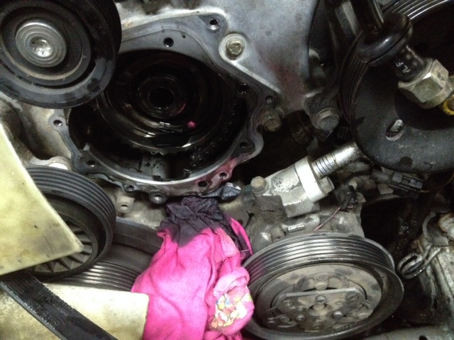

12-18-2013, 02:31 PM #7
repaire
offroaddieselhu
offroaddieselhu
repaire
offroaddieselhu

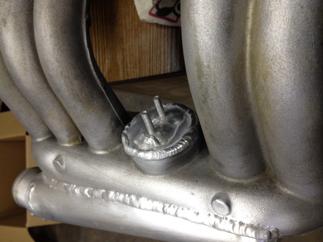

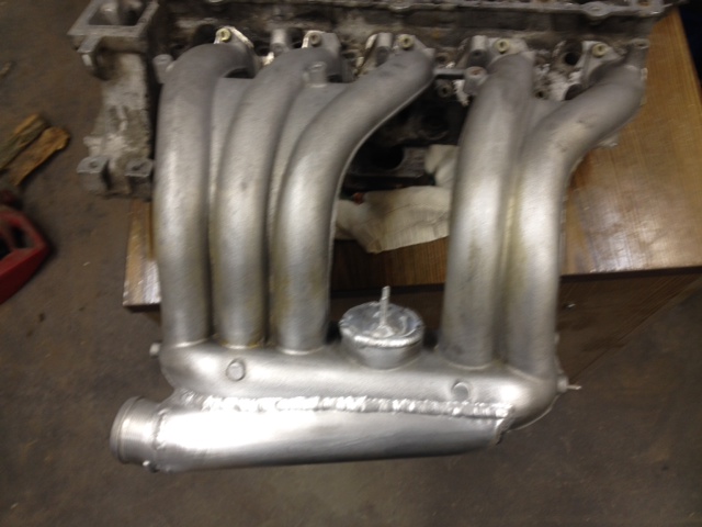

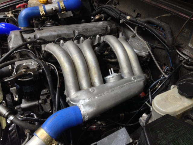

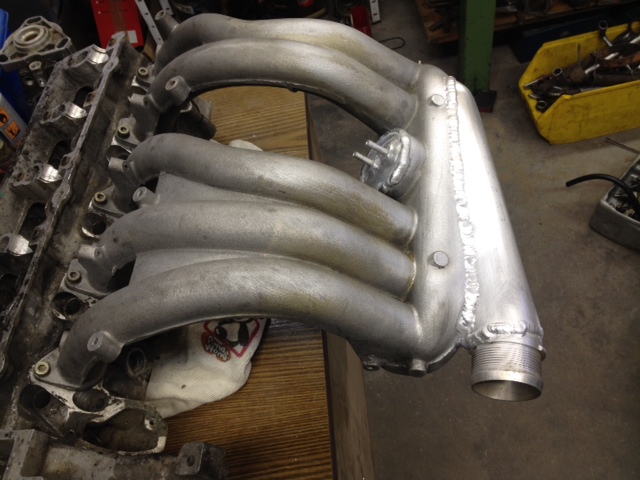

12-30-2013, 10:25 AM #10
in take
offroaddieselhu
in take
offroaddieselhu
This post was last modified: 12-30-2013, 11:09 AM by offroaddieselhu.
offroaddieselhu
in take
offroaddieselhu
in take
offroaddieselhu

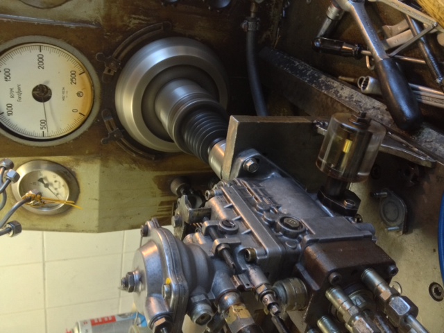

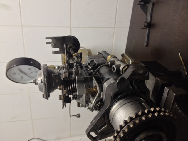

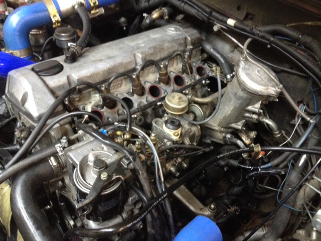

01-06-2014, 12:37 PM #11
ve pump
offroaddieselhu
This post was last modified: 01-06-2014, 12:38 PM by offroaddieselhu.
offroaddieselhu
ve pump
offroaddieselhu

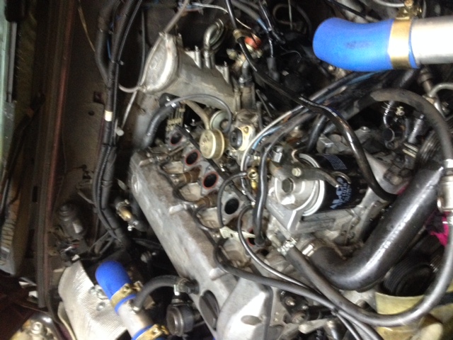

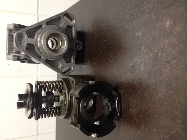

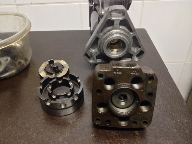

01-06-2014, 03:25 PM #12
VE pump
offroaddieselhu
offroaddieselhu
VE pump
offroaddieselhu

05-29-2014, 04:15 PM #49
it will got a 11 blade billet compressor wheel
offroaddieselhu
05-30-2014, 04:30 PM #50
11 blade
