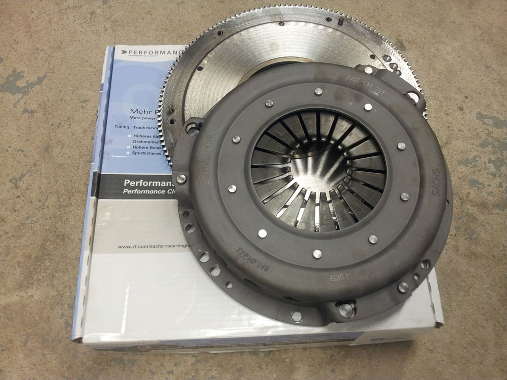

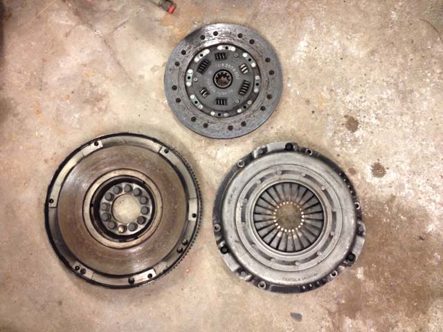

Keino
151
12-29-2014, 01:49 PM #18
(12-29-2014, 09:26 AM)F.R.A.S Pictures please...
It says Sachs on the pressureplate. Did some measuring and it seems it has the same sizes as original clutch, so hopefully it will be bolt on as promised. If you need more precise pictures of some part just say so.
[Image: 1zgt6y0.jpg]
[Image: t5g7de.jpg]
Keino
[Image: t5g7de.jpg]

12-29-2014, 04:28 PM #19
Check the rivets on the PP spring... mine stuck out too far and it didn't allow the PP to be flush with the flywheel so I had to grind them down a bit to clear. There's still enough metal "mushroomed" over the hole to keep it secure but just something I experienced on mine. Hopefully yours is fine and you don't have to modify it.
capflya
[486]
57
12-29-2014, 10:59 PM #20
(12-29-2014, 04:28 PM)capflya Check the rivets on the PP spring... mine stuck out too far and it didn't allow the PP to be flush with the flywheel so I had to grind them down a bit to clear. There's still enough metal "mushroomed" over the hole to keep it secure but just something I experienced on mine. Hopefully yours is fine and you don't have to modify it.
On the fixed cover end of the straps, or the iron movable piece?
The friction disc takes up a lot of space in there, if it is a flat flywheel.
[486]

F.R.A.S
12-30-2014, 08:04 AM #22
What number does it say on the PP???
215mm/228mm/240mm???
Just read the first posts in this thread... TAKE 2-WEEKS TO MAKE THE KIT??? This is damn spraypainted parts that the guy bought. Where is the parts that took two weeks to make??? And then it took like a month for you to get the parts.
I feel bad for you mate.
F.R.A.S
Keino
151
12-30-2014, 10:49 AM #23
(12-30-2014, 08:04 AM)F.R.A.S What number does it say on the PP???
The reason why it would take so long time is because Quote: "One more step to finish the pressure plate is to properly heat treat the diaphragm and after that it's ready to be shipped.
I can not speed up the 3 stage heat treating process"
Anyhow its 215mm
On the pp i can read:
TYPM200X M215
Good/bad?

F.R.A.S
12-31-2014, 08:58 AM #27
I'm sorry that the news where bad Keino. And to be true I don't see the point in dismantling a PP and rebuild it when Sachs have stronger PP available for almost any setup. And 215mm is a super weak setup to start with.
Here is a bigger picture for you...
[Image: 1000x1000.jpg]
I truly hate hustlers!!!
F.R.A.S

Keino
151
12-31-2014, 12:58 PM #29
The differences I can find would be in the center, the splines look different.
He remanufactured an old sachs with new goods?
Also, I cant find the "Germany" anywhere. Maybe he grinded that part out? But cant see any signs of that.
[Image: 2h5r3mw.jpg]
Would like to compare the inside aswell. Anyone got a picture?
[Image: 16hufyo.jpg]

12-31-2014, 05:42 PM #30
Keino that doesn't look like a high spine count on the disk? Should be a 26 spline or something like that, right? I have a 6 puck sinter clutch like the one you have, its pretty horrible to drive on IMO.

Keino
151
12-31-2014, 05:50 PM #31
(12-31-2014, 05:42 PM)winmutt Keino that doesn't look like a high spine count on the disk? Should be a 26 spline or something like that, right? I have a 6 puck sinter clutch like the one you have, its pretty horrible to drive on IMO.
Im using an old 4 speed gearbox. So it should be 10 splines. Wich it is.
Well, I'll see how it is to drive with @ spring. Tongue
