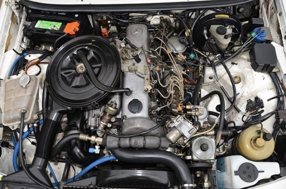

04-05-2015, 02:15 PM #3
The late cali(?) intake takes air from under the arch liner...
[Image: 035.jpg]
'85 shoul have the hole in the inner wing & arch liners allready...

04-05-2015, 02:26 PM #4
(04-05-2015, 02:15 PM)DiseaselWeasel The late cali(?) intake takes air from under the arch liner...
[Image: 035.jpg]
Hmm in mine the filter is just a little to the left of the engine block and it has a U-tube to the turbo and intakes air from just to the left of the grille right about above the right headlight. It is a Euro model but I wouldn't think that would change the intake setup... Similar to the one in the picture I attached.
Thanks

04-05-2015, 03:22 PM #5
It does Smile Euro cars never got the other intake style (hence it's known as "cali setup" IIRC only late california cars got it). We also never got the trap oxidizer, Mercedes over here doesn't even know aboiut them... Big Grin
In fact - Turbodiesels are a rare occurance in the home market... The n/a models are MUCH more common.
