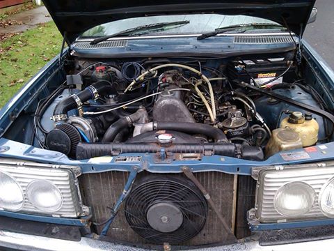

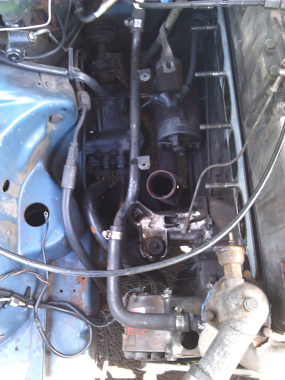

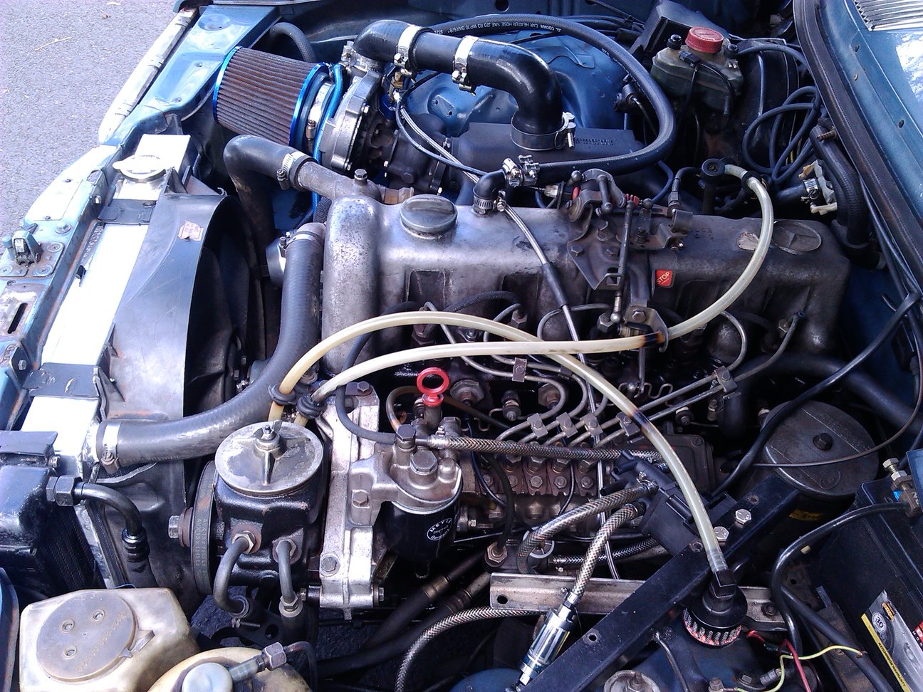

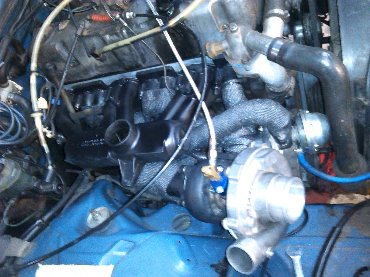

After a few years of owning my 79 300d I have decided to turbo it ........We named the old girl the "Coal grenade" as to how long it will survive who know's
 I began fabricating my own manifold which proved to be tricky due to clearance problems with the automatic gearbox rods ,brackets and the N/a manifold.
  In Australia we don't have factory turbo om617 and all the crap cluttering the righthand side of the car caused a great headache, I  moved the turbo further forward than a factory manifold would have the turbo to allow more room for the new exhaust.
A blown head gasket set the mood for this project,
So I In the last 3 weeks I have ported the head where needed , changed springs and cam to a later model which had 80 thou more lift and some other little modification here and there and replaced the headgasket.
The engine has the stock "mw" pump fitted but later models have "m" pumps which I have as a spare if needed
please feel free to chime in on any advice as I play around with this project and I know this style of project probably has been posted to death but not by me Tongue
Cheers Anthony

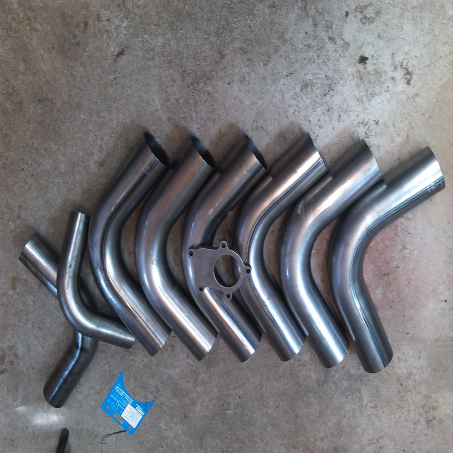

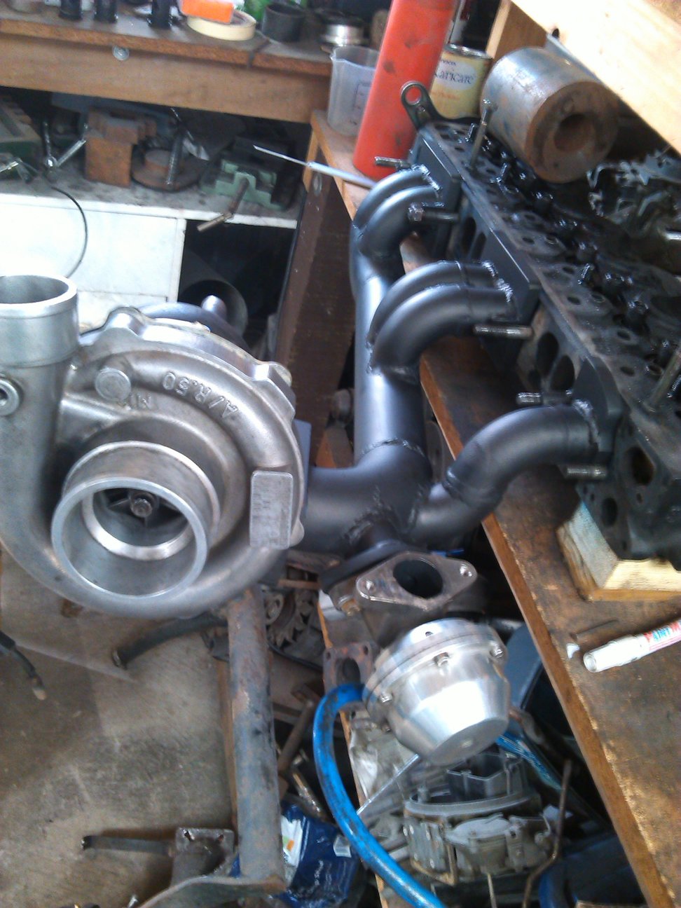

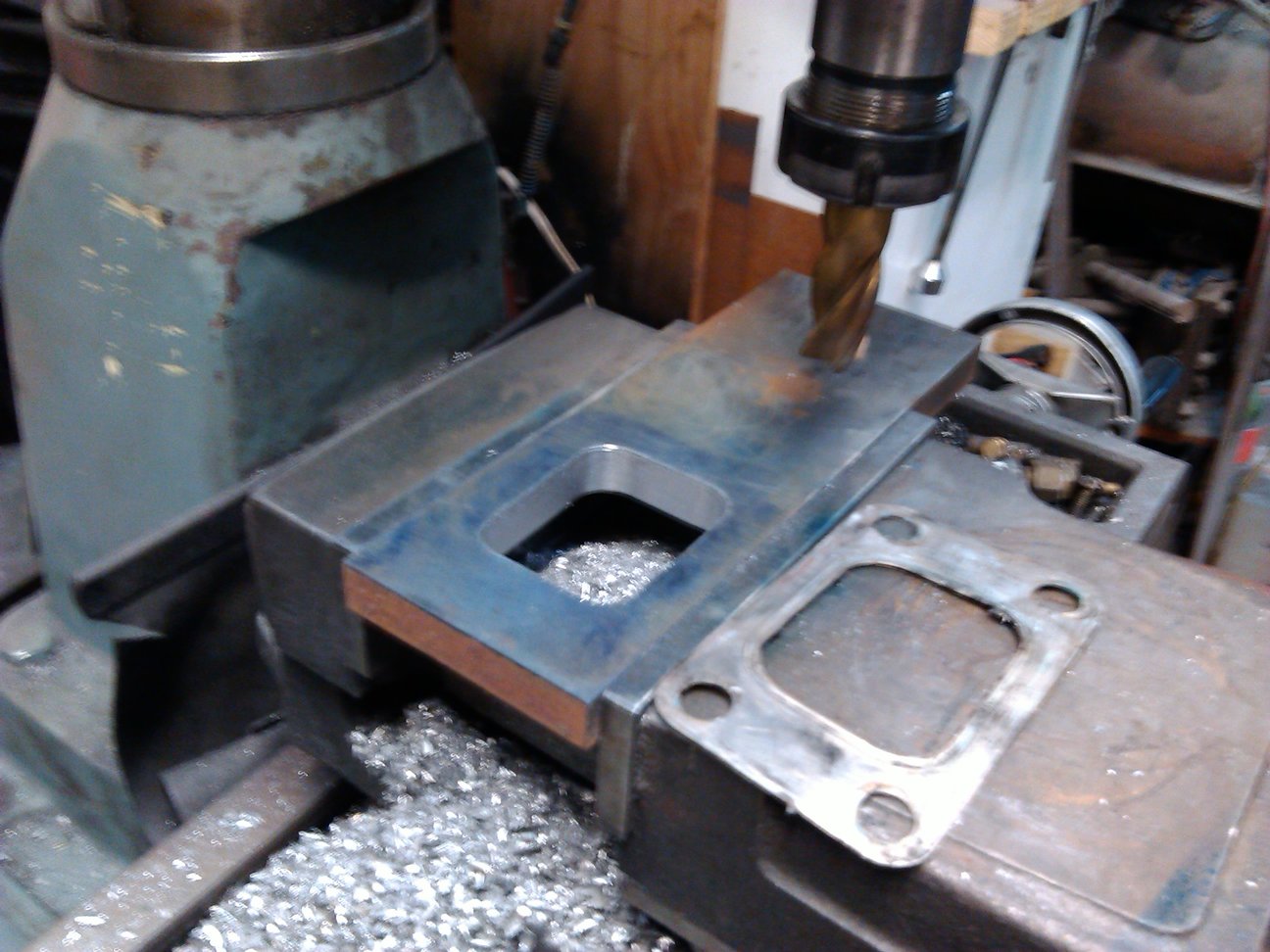

Hello fellow members ,

Check your valve clearence when you bolt it up  Exclamation Exclamation
When the cam was uprated the valve cutouts in the piston were increased in size. Unless you wan't the valves to kiss the pistons....  Rolleyes

Hi there,
             it's a later block with early head , I have set the clearances with no issues so far

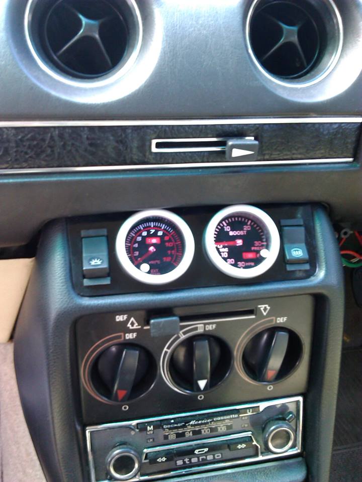

G'day all,
               Installed the gauges there now patiently waiting for the rest of the project Smile

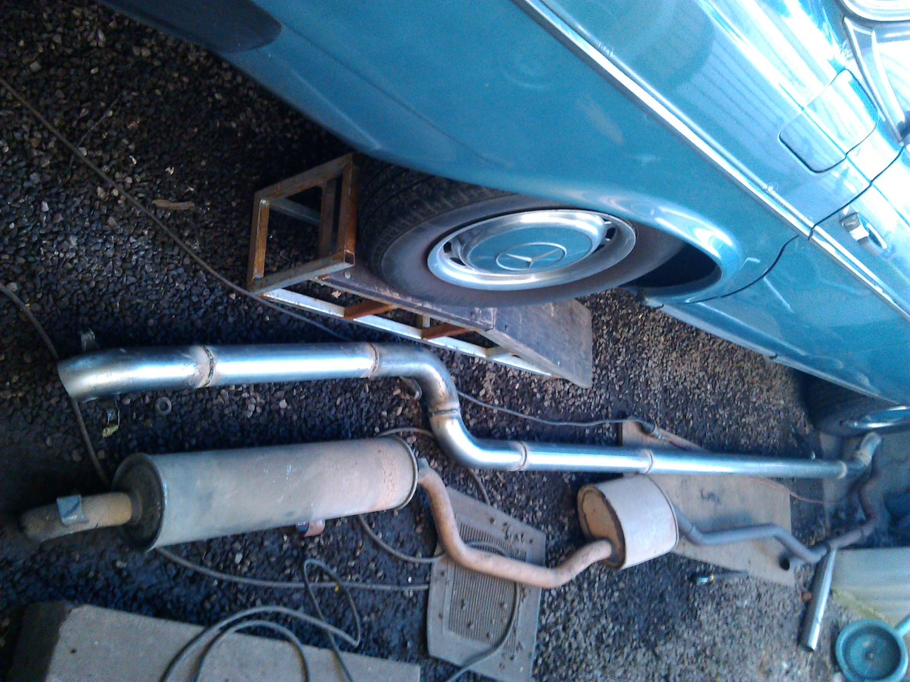

Cheers Cody.......Picked up the 3" bends for the exhaust today so I'm slowly getting my SH*t together !
Cheers Anthony

G'day all, finally I have been able to put some time in on the grenade,instead of working on other peoples cars !

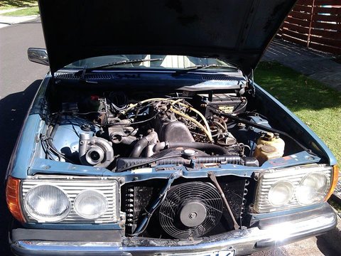

finished the exhaust today so tomorrow I will be able to take the car for it's first test drive ! YAY

Went for my first drive today ,what a improvement, doesn't struggle up hills and is happy cruising around, temp stayed on 80degc ,with the stock pump setting and manual shifting it made 16psi of boost with a slow climb of egt @480 deg C in 2nd gear, it will be interesting to see what it does when I'm able to turn the fuel up
