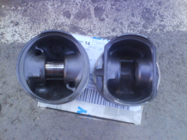

has 300 Diesel 24V 95-96 non-turbo oil spray on the pistons?
can i put a big turbo on this engine? and put 7mm element in ip

No, the engine does not have piston cooling and its built much weaker.

(09-13-2009, 03:14 PM)ForcedInduction No, the engine does not have piston cooling and its built much weaker.
is that from om606? yes its mutch weaker i see. did the 24v top fit on the 12V turbo engine?

There are reports of the oil and water passages of not being the same. I still haven't seen the side-by-side of the two head gaskets though. Could do it Honda style haha.

Are You sure about the oil spray on the pistons, I`ve heard that all OM60X got it from a certaint year, but not sure about.
TNX for the pictures :-)
