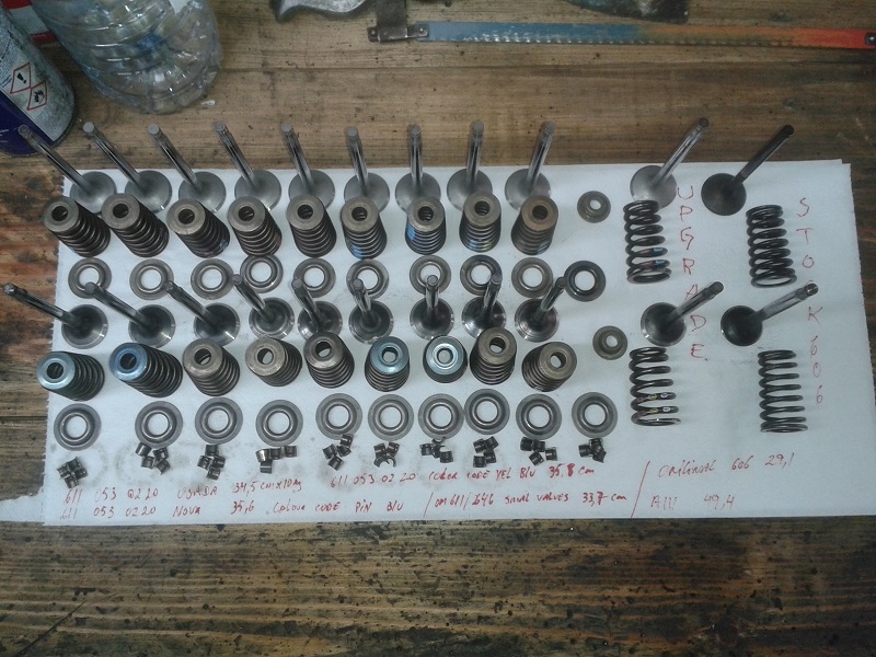

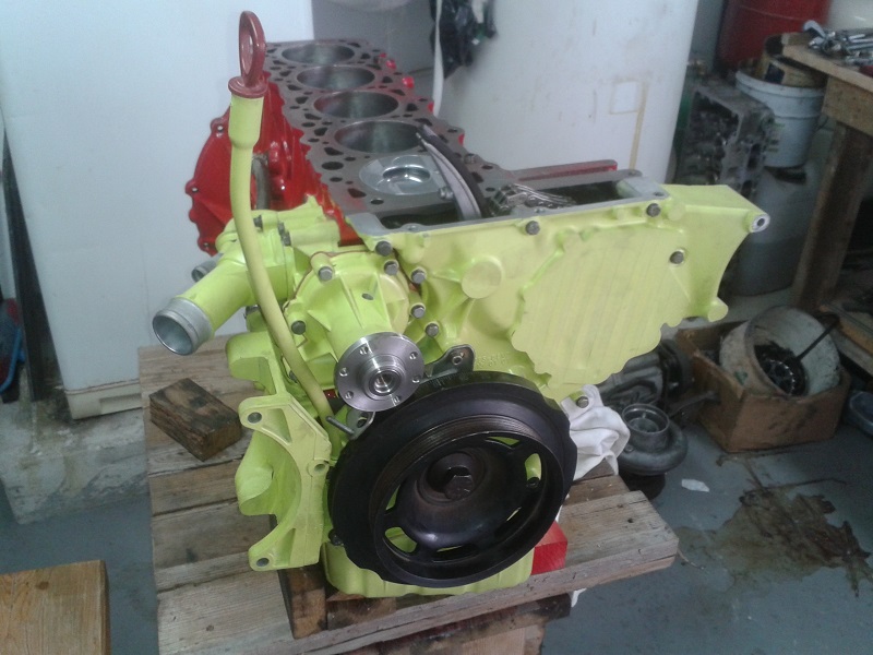

hello fine people,
The monster is taking shape!!!
In the end this will be the MB 2.9 4 valve DI engine!!!
If someone could help me to post pictures i would be glad to do it .... and share!!!!
Ate the moment a few modifications still have to be made , but the core engine is assembled, 602.982 block , with a 605.960 cylinder head, Injection pump will be a PES5M80320CRS201 @ 6k 150cc, a GT30V turbine fitted with a 67mm MSF compressor.

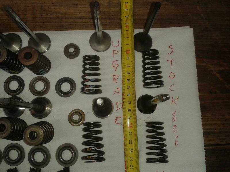

Head will retrofited to use a 1mm wider valve in exaust and a 1.5mm wider in intake, TD cams, valve springs with 800N for intake and 600N for exaust... ported, flow improvements that simple things every engine will benefit.
At first stage , this engine will run IDI for concept trials, DI will come later on, still searching for the right low press DI injector nozzle.
would apreciate help with the pictures.

hello fine people,

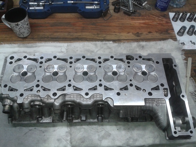

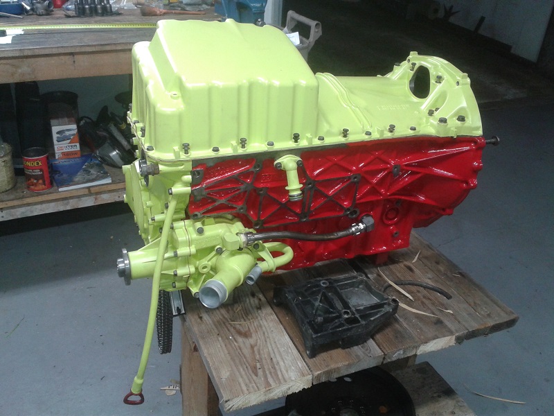

01-29-2016, 06:11 PM #13

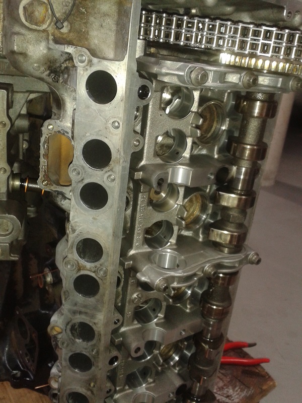

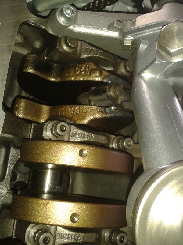

Boys , Boys , Just for Big Boys
A litle Ferrari, colour Wink
And the inspected guts Big Grin
in a few days a litle development ....

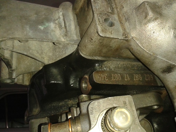

02-24-2016, 04:10 PM #16

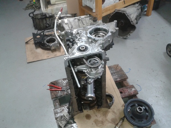

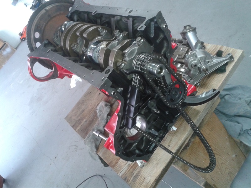

This days the progress is being lazy mater of saying,
Mods done till this point
1-time chain increase lenght to comply with the 4 valve head.
2-conection from water pump housing to rear cylinders (15mm stainless stell plumping pipe Wink ).
FD,

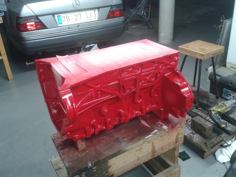

Been busy this days , the subframe is done , or mass block.

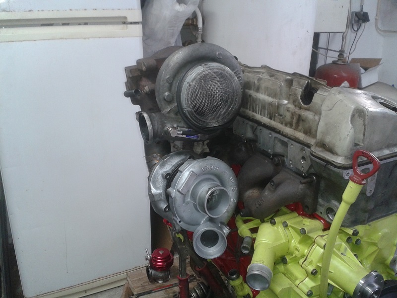

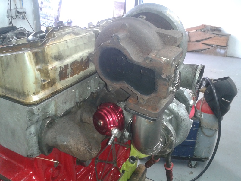

08-08-2016, 08:46 AM #19

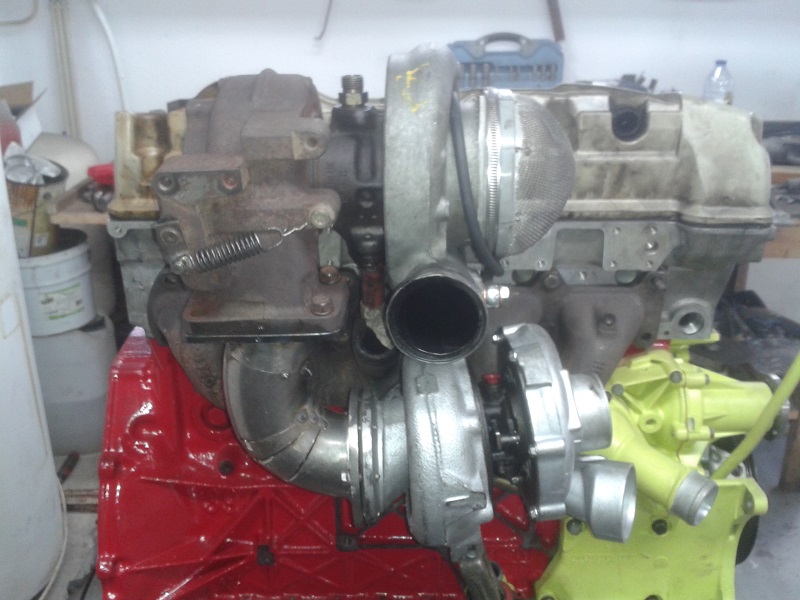

Hello fine people !!!
What about THIS!!!
it should work .... some how .... if it fits the bay

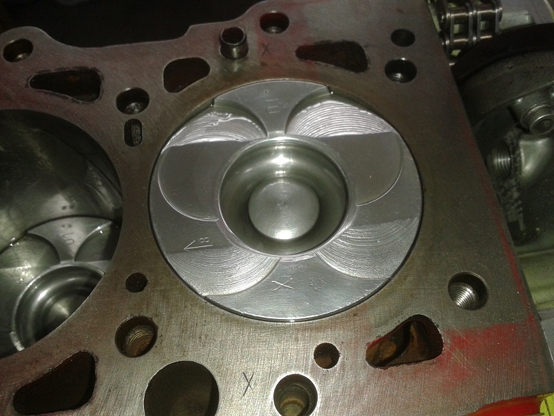

08-10-2016, 12:29 PM #21

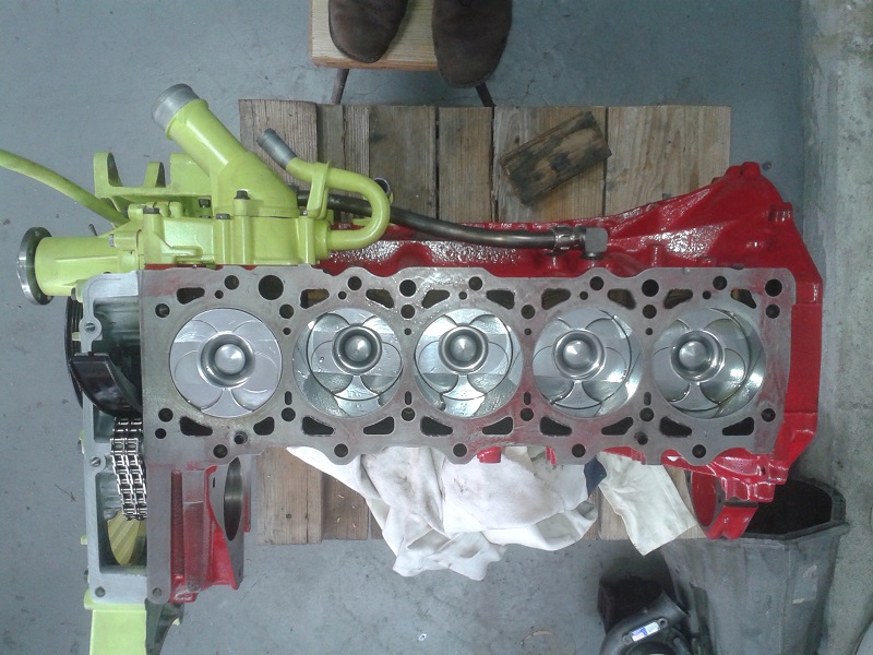

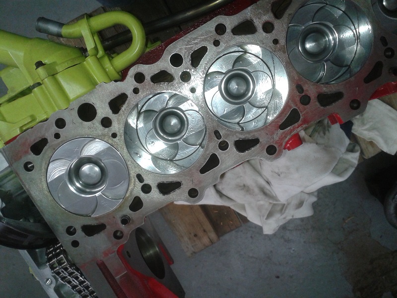

Bores, pistons and rings are original?
Ex: 525tds 130kW, C250TD 160kW, E320CDI 200kW, ML400CDI 230kW, A6 R5TDI 130kW
Now: Q7 V8TDI 240kW, 320d 150kW, 335d 210kW
starynovy
barrote
1,627
08-10-2016, 03:17 PM #22
89mm bore, goetze rings , piston as u can see are modded, but were modded from original´s.... heavily modded Wink
FD,
Powered by tractor fuel

The valve train gear , they will be powered by N/A set of cams
Compare with the stock ones

Finally the head is bolted, sorry no pics hehe. but the head assy is as this... gasket well if it will hold i´ll open a custom made gasket shop Smile
FD,

Pardon my ignorance, what are the divot marks on your valves?
CRD4x4
12-08-2016, 07:48 AM #39
barrote
1,627
12-08-2016, 12:26 PM #40
They were already used before, those are track marks, this is a customized built, sometimes track markings are a very nice way to go....
Wink old style
FD,
