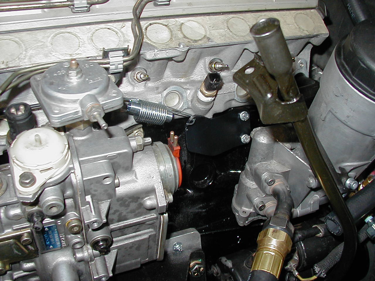

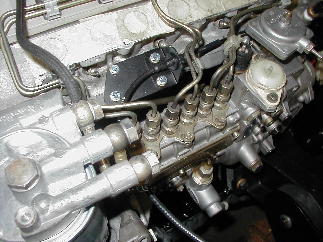

On my Jeep conversions, I make a plate to go were the fuel heater was in the head and make a bracket to hold the cable and then put a carb style ball on the IP linkage. Just snap on the cable. Also made a bracket for a stiffer spring.

Zeeman you could probably sell a few of those brackets and cables. I would buy one. The dieselpumpuk guys have one that they want a lot of money for, and almost as much again for shipping.
