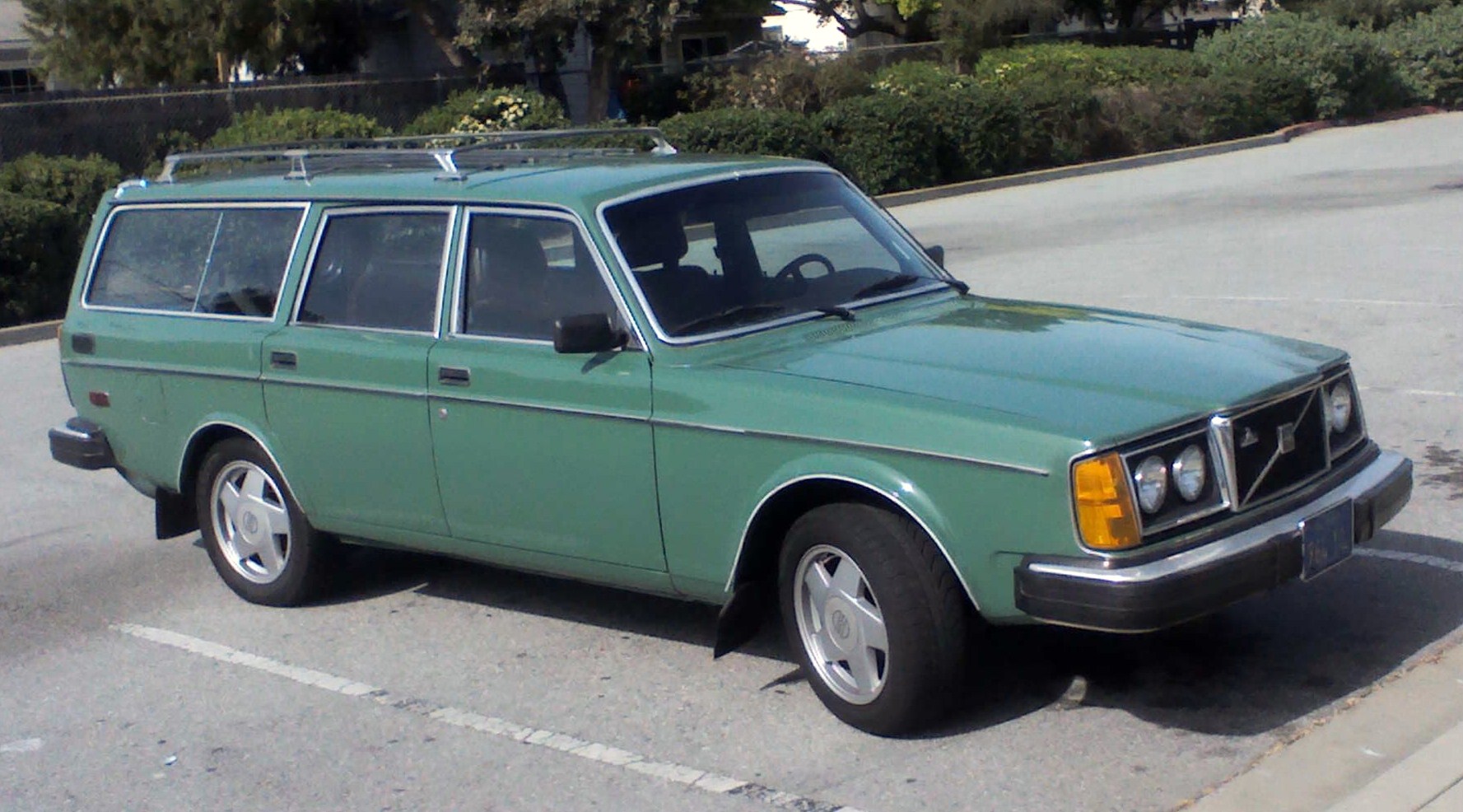

Alec300SD
32
04-27-2016, 08:36 PM #8
(04-27-2016, 05:38 AM)Hario What's a 245?
I believe it is a Volvo wagon. I have a 1979 245DL wagon nicknamed "Grasshopper".
Alec300SD
decl00ne
24
04-29-2016, 04:13 AM #9
(04-26-2016, 01:58 PM)baldur If you don't like smoke, you just need to have tight control over fuelling in relation to turbo boost pressure. This is an area where an electronic injection pump (EDC) excels.
yeah true, but the problem is that a mechanical pump i can do all of the work myself.
if it comes to chipping a pump i suck...
(04-27-2016, 08:36 PM)Alec300SD
yeah its a Volvo wagon, stupidly lumps of metal, but ultimate sleepers haha
