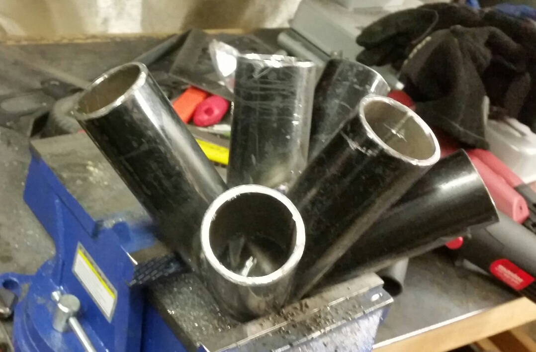

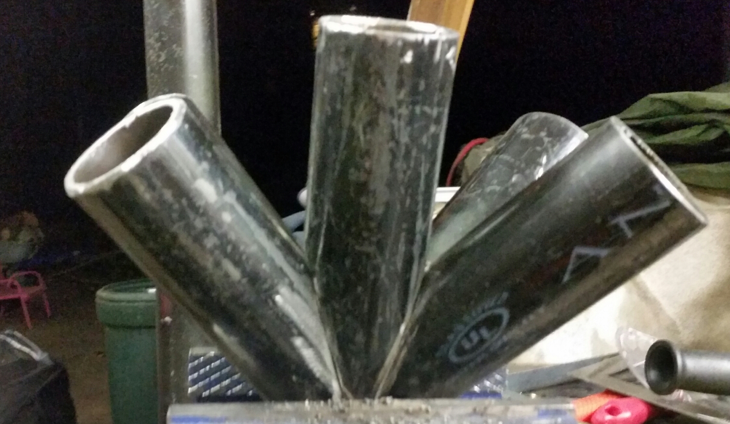

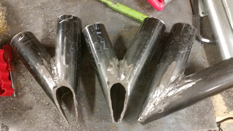

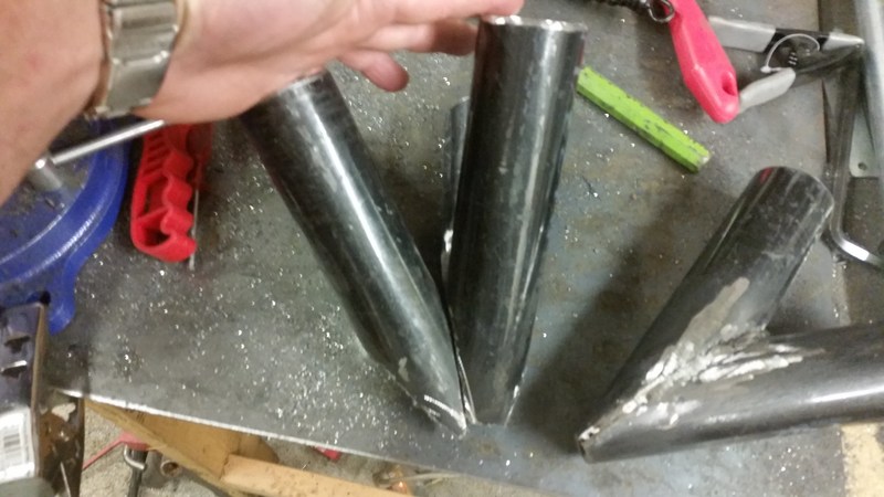

03-05-2018, 04:43 PM #8
Well, I got started.
My welds are terrible and will probably crack but we'll deal with that if and when it happens.
I'll take more pics tonight but I have a collector. Currently the angles are all too wide so I haven't tack'ed it up, but it's looking good. Fitting 6* 1.9" OD pipe in roughly 1.5* the side of one 1.9" pipe is a bit of a challenge but so far so good.
I started with 3x 1' sections of pipe and cut them at a sharp angle (I'll measure it later) in the middle to make my V's. This made the fitment almost 99.9% perfect as my chopsaw rolled a bit at the end.

03-05-2018, 06:32 PM #9
Try "weldingtipsandtricks.com" for some great instructional videos on mig welding everything pipe.
Lots of practice and patience will be useful, too.

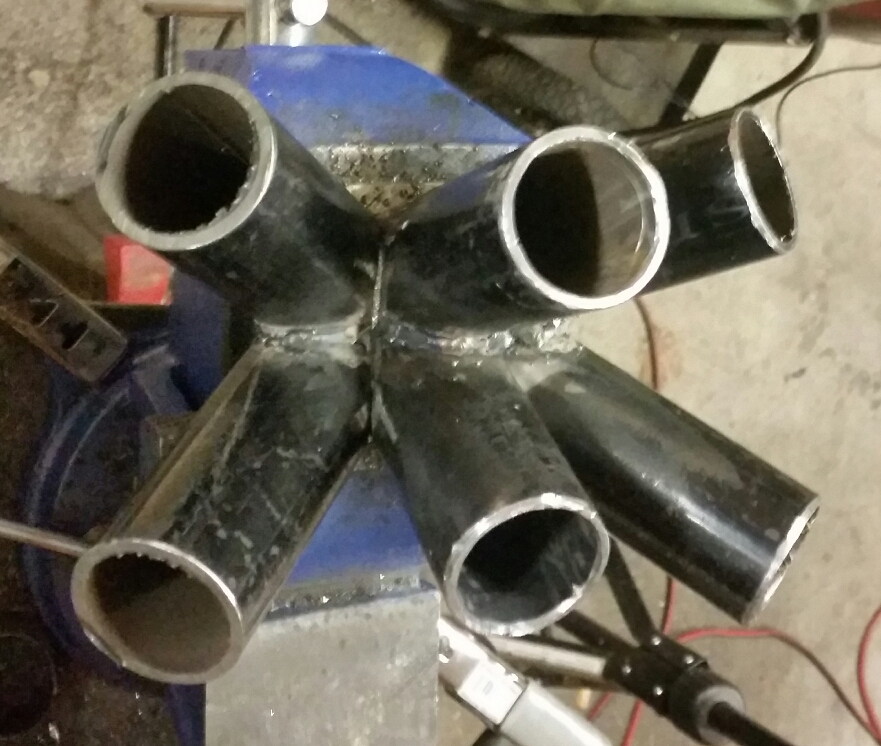

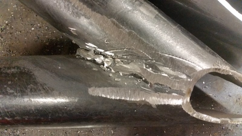

03-05-2018, 08:15 PM #10
Decided I wasn't running hot enough and went up a notch. Way better penetration. I ended up re welding all of the welds from the inside to make up for the outside welds. Stepping up my noob level a notch. Cleaned up most of it with a deburr bit and need to chase it with a brillo bit. Now I'm down to the last bit before the flange goes on.

03-06-2018, 01:36 AM #12
Looking good. Not a bad effort for a first start. Deffo turn the amps up tho. She’s running 2 cold. Also turn your gas up a little and you will be able to run more stick out so you will find it easier getting into the tight joints.

03-06-2018, 07:38 AM #13
(03-06-2018, 01:36 AM)Mallinman Looking good. Not a bad effort for a first start. Deffo turn the amps up tho. She’s running 2 cold. Also turn your gas up a little and you will be able to run more stick out so you will find it easier getting into the tight joints.
I did this with 0.030 FCAW, my regulator is in the mail. I may end up having to do this over again as I'm not sure about fitment of the flange. I think I nailed the narrow width right but am short on the longer width. If nothing else, I've learned a lot so far.

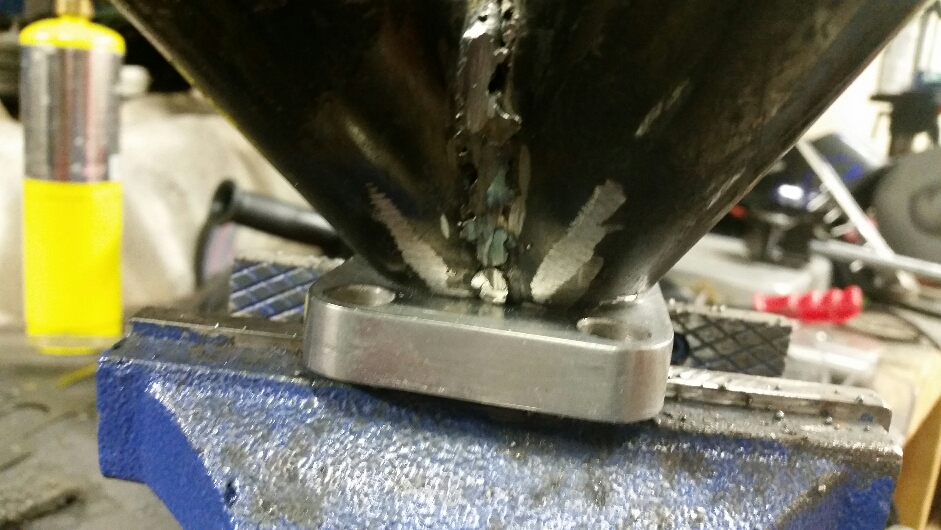

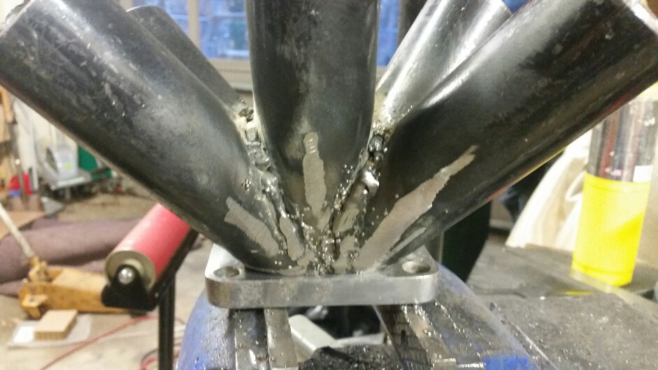

03-16-2018, 09:10 AM #16
Ugly as sin and not done yet but it fits!!! Pretty magical considering I didn't measure anything.

03-19-2018, 12:29 PM #17
Too cold still. Weld should be fused into each tube and even/slightly convex between them. These spits will crack at first start. Wink

03-19-2018, 12:31 PM #18
(03-19-2018, 12:29 PM)starynovy Too cold still. Weld should be fused into each tube and even/slightly convex between them. These spits will crack at first start. Wink
Yeah, needs much more heat. Crank the amps up.

03-20-2018, 02:46 PM #19
Consider slowing down as well to get a bigger weld pool and more fusion. It will also make your welds look better. Also keep the torch as close as possible to the weld.

03-20-2018, 04:23 PM #20
Here's a mild steel manifold I built back in 2004 and it's still in service. TIG welding makes it so much easier to control the weld quality and get welds that
penetrate through the entire thickness of the material.
You can still do it with MIG, it just takes some practice.
A little tip, grind the pipes so that there's a gap between them at the top and you have a little groove that allows the weld metal to get in between them.
That way it'll be easier to get some penetration. Also make sure the wire isn't feeding too fast. You may clog some MIG nozzles if you go too slow but too slow
is better than too fast, as too much wire feed cools the weld down.
[Image: exmani030007.jpg]

(03-20-2018, 04:23 PM)baldur Here's a mild steel manifold I built back in 2004 and it's still in service. TIG welding makes it so much easier to control the weld quality and get welds that
Those are some very nice welds.
