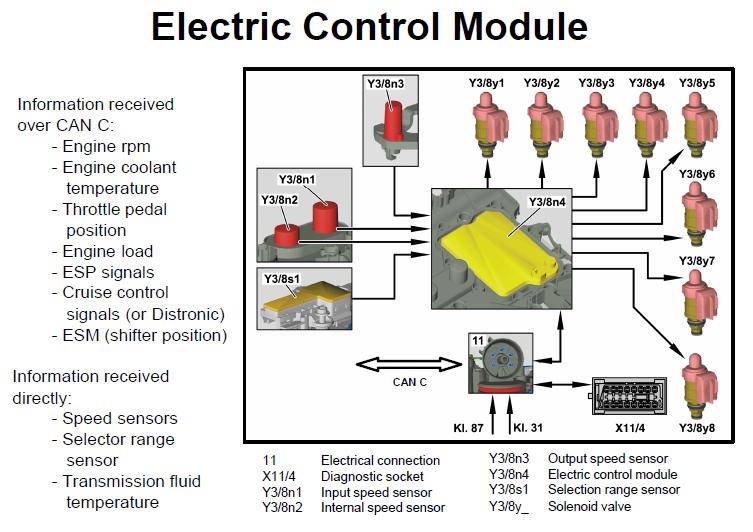

03-09-2018, 07:42 AM #1
Hello Everybody.
I made 722.6 Controller before.
Let's try out 722.9.
Documents:
ATSG - https://www.atsg.us/atsg/skin/frontend/d...0722-9.pdf
Youtube - https://www.youtube.com/user/DeviMauz/videos
Many thanks to Sean

03-09-2018, 09:49 AM #3
The 722.9 has a controller integrated into the valve body.
