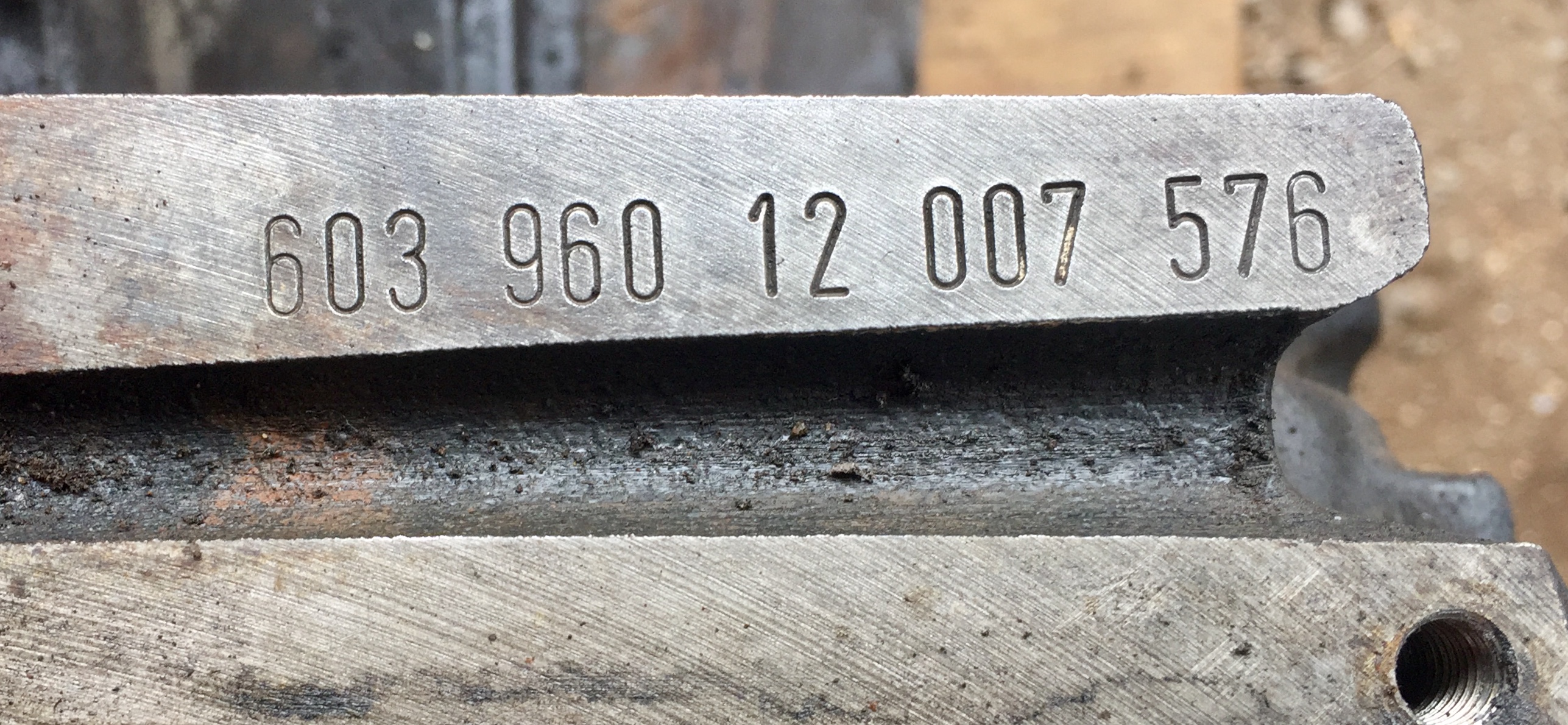

lolMy Om603 out of an 87’ 300D has 603 960 12 007 576 stamped on it. How do I tell what the suffix number is, as in 603.xxx?
Cheers, Allen

07-05-2018, 02:10 AM #2
Well I thought I’d post a pic of it also, but that didn’t work out quite so well! Lol
Cheers, Allen

07-05-2018, 04:21 AM #3
In your case it's 603.960

07-05-2018, 04:22 AM #4
It's the first 6 numbers in the engine number

07-05-2018, 04:01 PM #5
(07-05-2018, 04:22 AM)Petar In your case it's 603.960
Thanks Petar. Are there differences in the 603.960 and 603.xxx versions other than externals like the oxidizer trap and such?

07-06-2018, 08:41 AM #6
As far as I understood the nomenclature it's like this 603.9xx - 603 is the engine type of course, the first number is always 9, the second number means significant internal differences. For instance 91x is naturally aspirated, 96x turbocharged, 97x is 3.5 turbocharged. The last number seems to be small external differences dependent on the chassis it was installed in.
