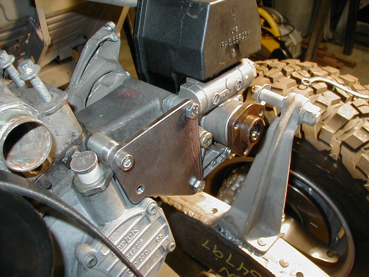

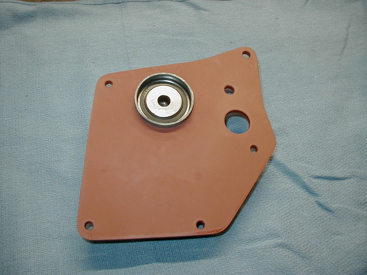

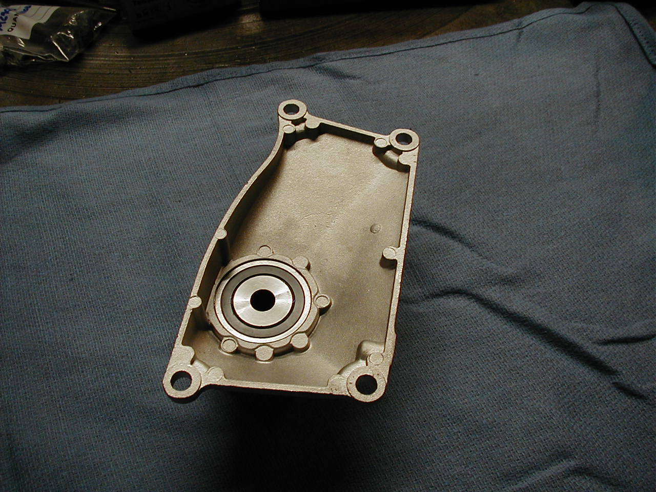

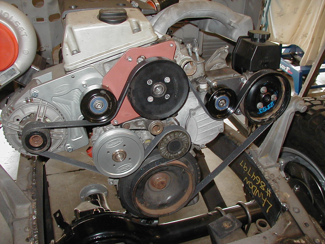

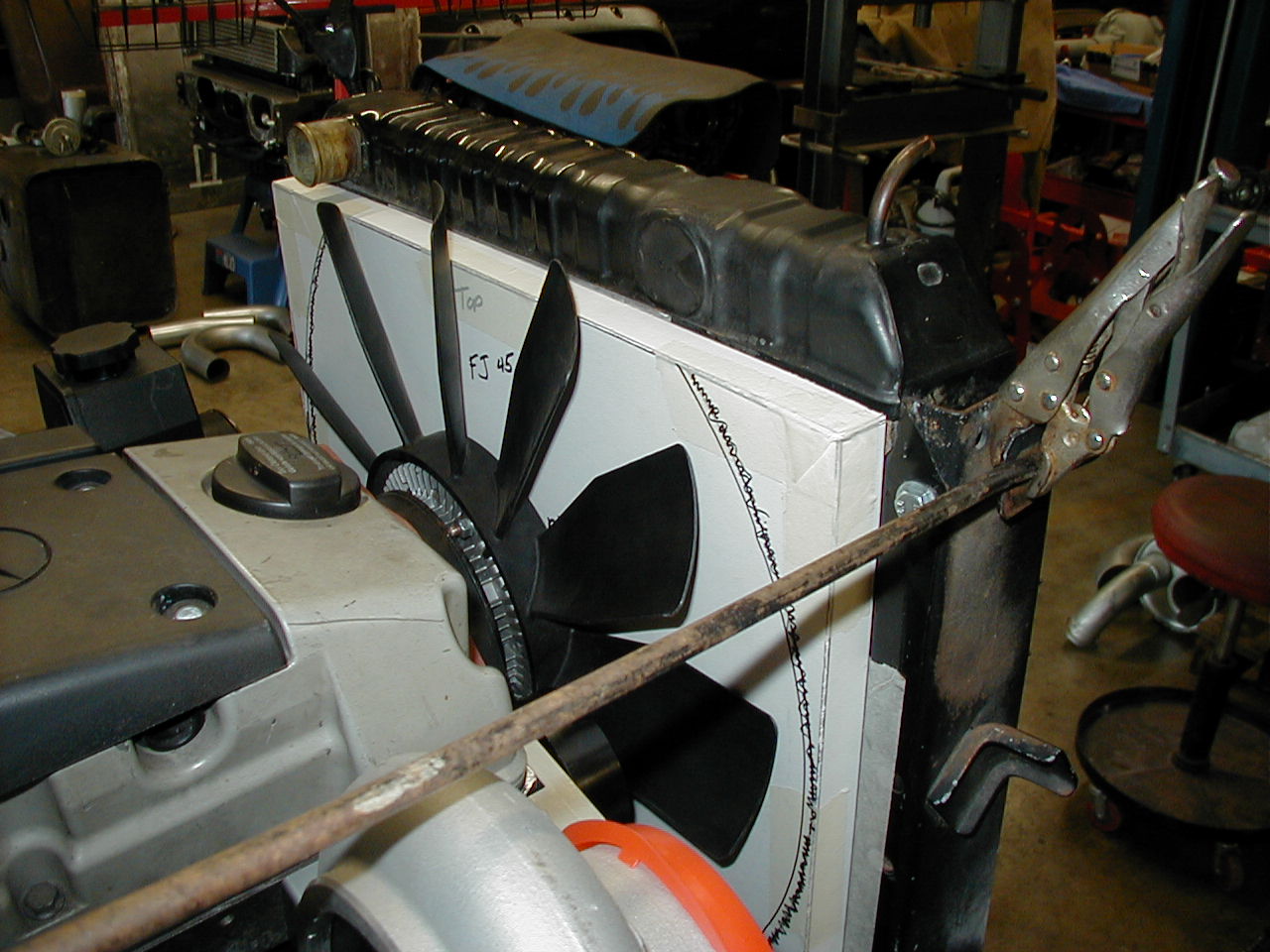

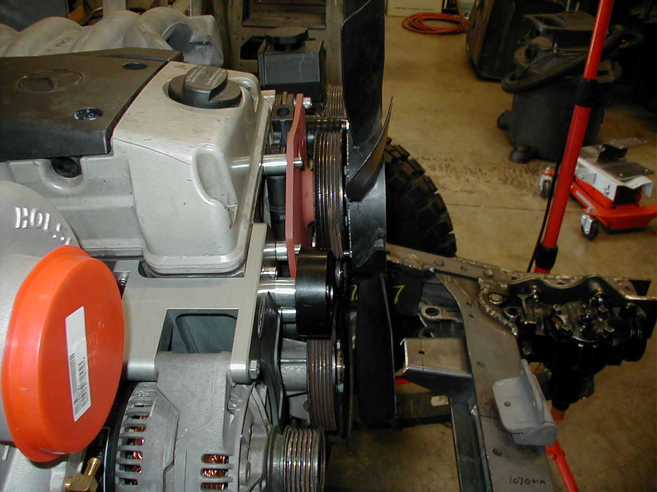

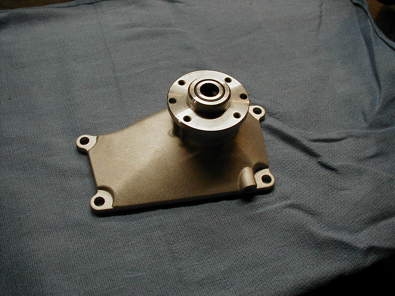

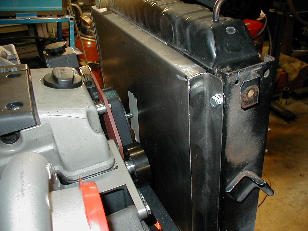

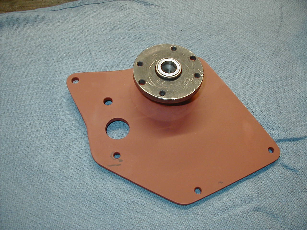

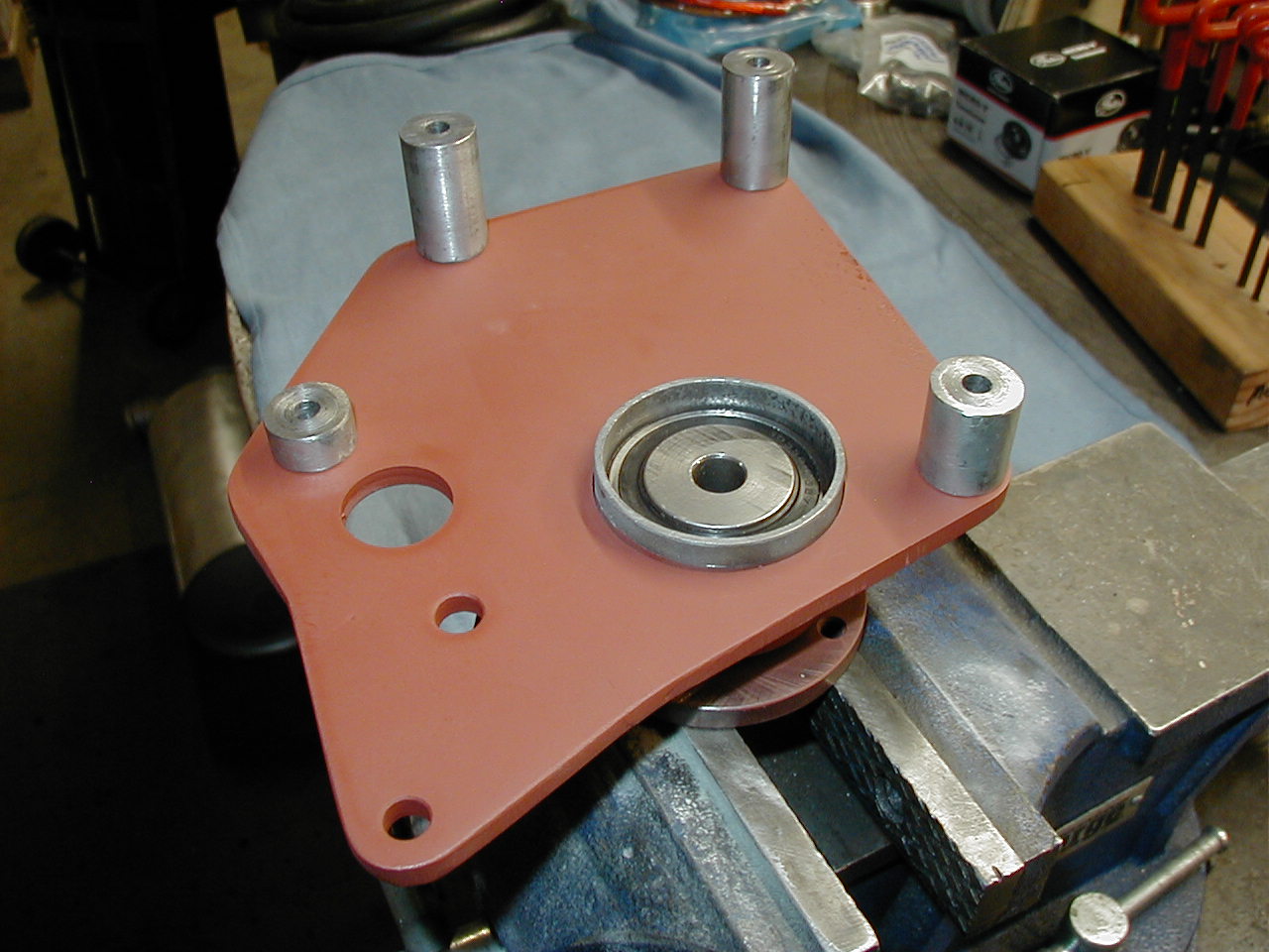

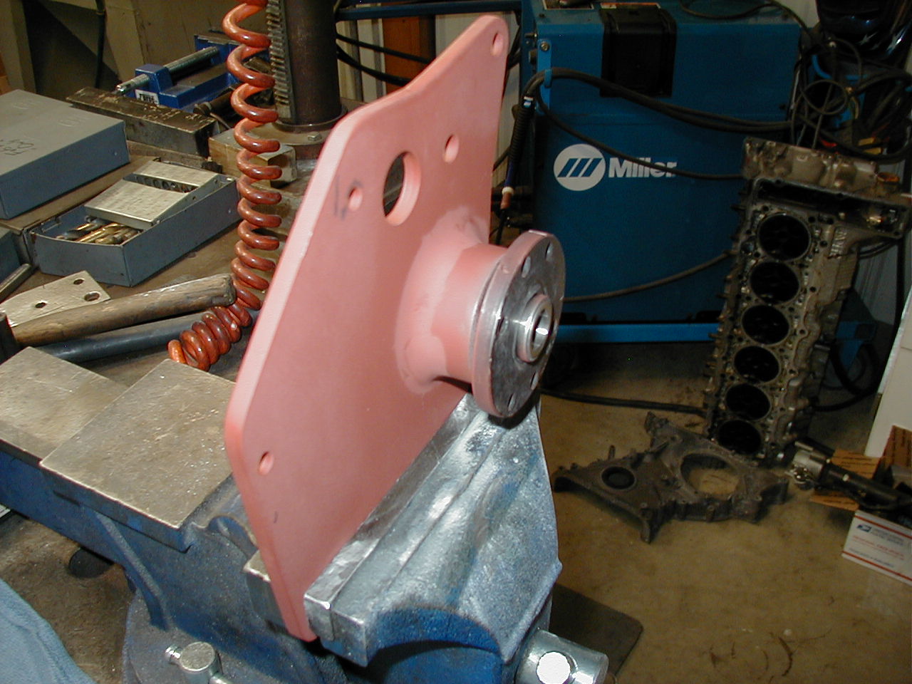

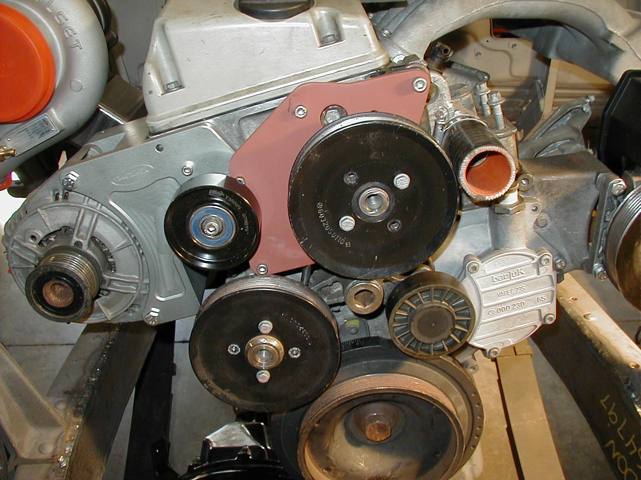

In working on a customers Toyota FJ 45 I found the stock location for the engine fan was to low and offset for the stock radiator.
Just sharing a solution I came up with , may help others with the same issue. I used a Mercedes gas engine fan relocation bracket bearing that has the same fan setup as the OM 606 with the center bolt, as well as DieselpumpUK's alternator relocation bracket and small water pump pulley.

Quite clever. Seems like there will be a problem with routing the top radiator hose though.

AlanMcR Quite clever.  Seems like there will be a problem with routing the top radiator hose though.
I will be running a 90 degree tube out of the head. Already solved that. Obviously this is still in the mock up stage.
