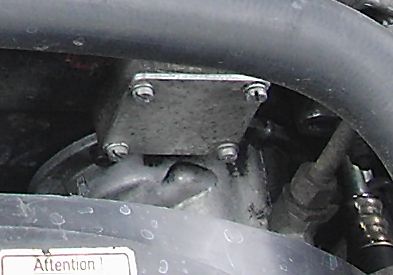

12-04-2009, 06:58 PM #2
(12-04-2009, 06:15 PM)texascadillac42 I have searched several sources, and looked for this part, but obviously have not tried hard enough..
Sorry, this picture is as close as I've got to a part number. You might have to crawl through a pre-80's parts catalog to find it.
Quote:I am also looking for a plate that would cover up the hole where the hydraulic pump on a 300TDT would normally go, on the head.
A square plate with 4 holes works fine. Mine is 1/8" aluminum.
This post was last modified: 12-04-2009, 06:59 PM by ForcedInduction.

12-04-2009, 08:59 PM #3
Thanks for the pics. I figured I might have to make a hydraulic pump block off plate, which is no problem. I am hoping someone will have a PN for the vacuum pump plate. I will try calling Peach Parts Monday to see if they have any info on it.
