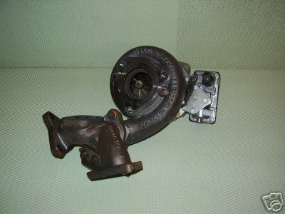

I found a MB 320CDI turbocharger GT2056V, I hope that this is OK
alesbm
12-09-2009, 03:48 AM #6
12-09-2009, 04:21 AM #7
If its a 2008+ model, its got a rear facing turbine inlet.
