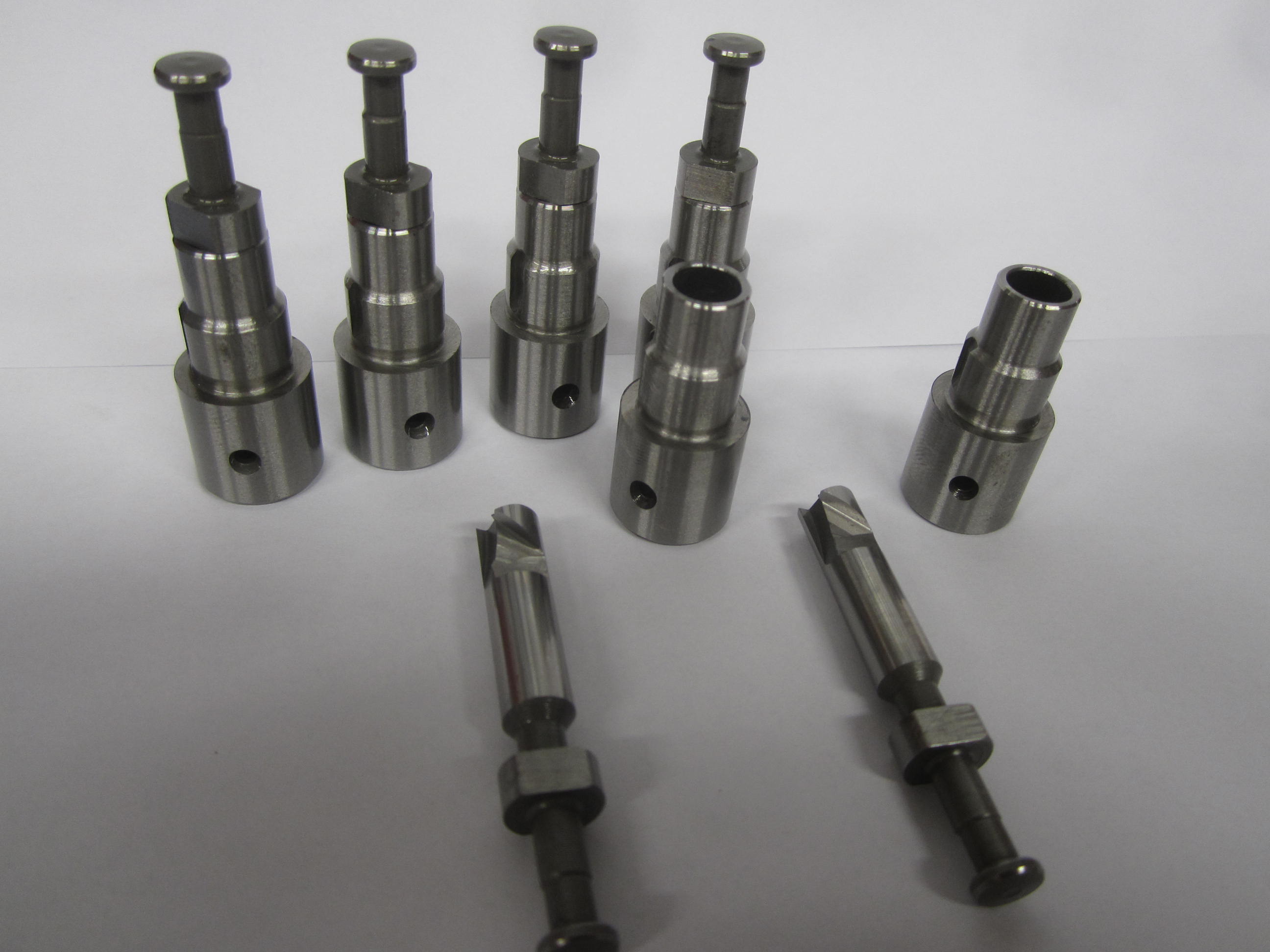

Hi,
You made one 603 pump to Estonia for om606 if you remember.
I have few problems with that...
First of all,pump was leaking oil and diesel but I fix those problems,no big deal.
But big knock at idle,black smoke at idle,if I start the car then the knock is really big and smoking like hell,not all cilinders start at time,idle is 1000rpm and bit rough.
At 220km/h I can switch 4 gear and boost is 2,3bar(never tryed 5 gear yet,its seems bit scary with that old SEC Big Grin),there is no lack of power but its still smoking badly... Last time speed was 250km/h and it has still loads of power....
Pump is 20 degrees right now and max EGT 760-780¨c
Any ideas?

Hi Yes I have a Idea, you are totally wrong in your timing of the pump.
Oil & fuel leak?????
The pump should be timed 15 degrees After TDC, By your explanation I guess that you have timed the pump on the wrong stroke.
N0 1 cyl at TDC, Both inlet & exhaust valve is closed, ( #6 is rocking), sen engine to 15 ATDC, Lock the pump with timing tool in governor and put pump in.
My pumps are all set to 15degrees offset on the timing flange, this is so you can use original timing proceedure.
Check & come back.

(07-17-2012, 08:35 AM)_siim_ idle is 1000rpm and bit rough.
Hi,
why 1000/min idle??
Next: 15 deg A TDC is about 24 deg before TDC physically start of injection.
Why not retarded to physically 15 deg before TDC or even later?
The shorter duration will allow it and it is less stress for the engine, also way more smoother.
Tom

Tom, Obviosly the timing is totally wrong on this engine, that is chrystal clear. Think its your opinion also.
I think he must have at least 1000 rpm on low idle to get it running.
One other theori is that the throttle shaft not goes back to zero in the car, that is quite common as a mounting fault and comes from the adjustment of the governor, I have to back off the throttle stop some turns to get it down safe without afterrewing
My superpumps comes with a low idle at 650-700 rpm
0,5-0,75 degree offset in phasing as max.
Timing should be 15 ATDC when putting pump into engine, I set the timing wing in the governor with a 15 degree offset, and if you do your math then you see that timing is 15 BTDC when running at load.
Also I have a retard notch that gets 3-4 degrees later ignition under 9 mm of racktravel, then at low idle the engine goes at 12-13 BDTC and runs very smooth and nice.
That is if they are mounted properly.

Anyway, now I take my serie 1 to a new level, This week a set of 4 plungers will bee grinded so that the helixangle goes up to 50degrees, that is nearly the same as the stock 6 mm boschplungers.
I have a small project that includes a VW 1,9TDI engine, that for the moment have a Valmet A-serie pump with 9,5mm plungers and a RSV governor with a really light weigt in, it goes really bad under 5000 rpm, but after that it starts to go OK, problem is that the pump is seizing one one cylinder.
http://www.youtube.com/watch?v=0s-EEeZnFes
Listen in the end when it seize.
Therefore I have a OM616pump that are going to get 7,5mm, 50 degree helix plunger in and we will se if it works out well.

I have done some testing today with my serie 2 element, 7,5mm 50 degree helix angle, The result was quite nice to see, for now I keep it for myself, Small filmclip will come soon.
I will have a testpilot that can take the OM606 engine up in a dyno so I have some result on my pumps.
The work proceed, I will try to refine my pumps some moore.
8mm is not going to happen from me, that I leave to the Fins. A bit too expensive according to my customers, dont know what Mynä charge for 8mm pumps €1500 or moore??

Rack /mm Fuel /cc Degrees
10 40 12
13 60 14,5
16 83 18
19 105 19
10 72 11,5
13 95 13,5
16 120 15
19 144 17,5
11 74 13
13 100 15,5
15 121 18
18 150 22
21 182 26
__________________________
As you can see, serie 1 is quicker, at 72cc, it needs 11,5 degree to complete the injection, serie 2 needs 13 degrees for the same amount.
Here is also the answer to why the engine is so difficult to drive, it raise the fuel so fast on so little rack, that makes it sensitive on the throttle.
A small push on the throttle and BAM 100% moore fuel that stock.
Serie 1 is to prefere if you are satisfied with 350-400 bhp, if you need moore fuel, serie 2 or 8 mm is the answer BUT it needs longer time to inject = have to move injectiontime on engine.
Look at 6 mm @105cc, it need 19 degrees compared to no1 that goes on app 14 degrees
