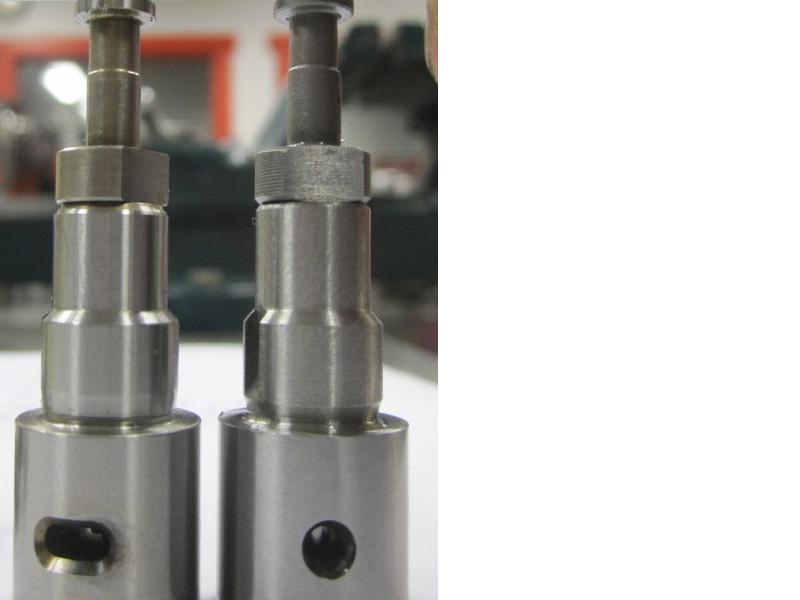

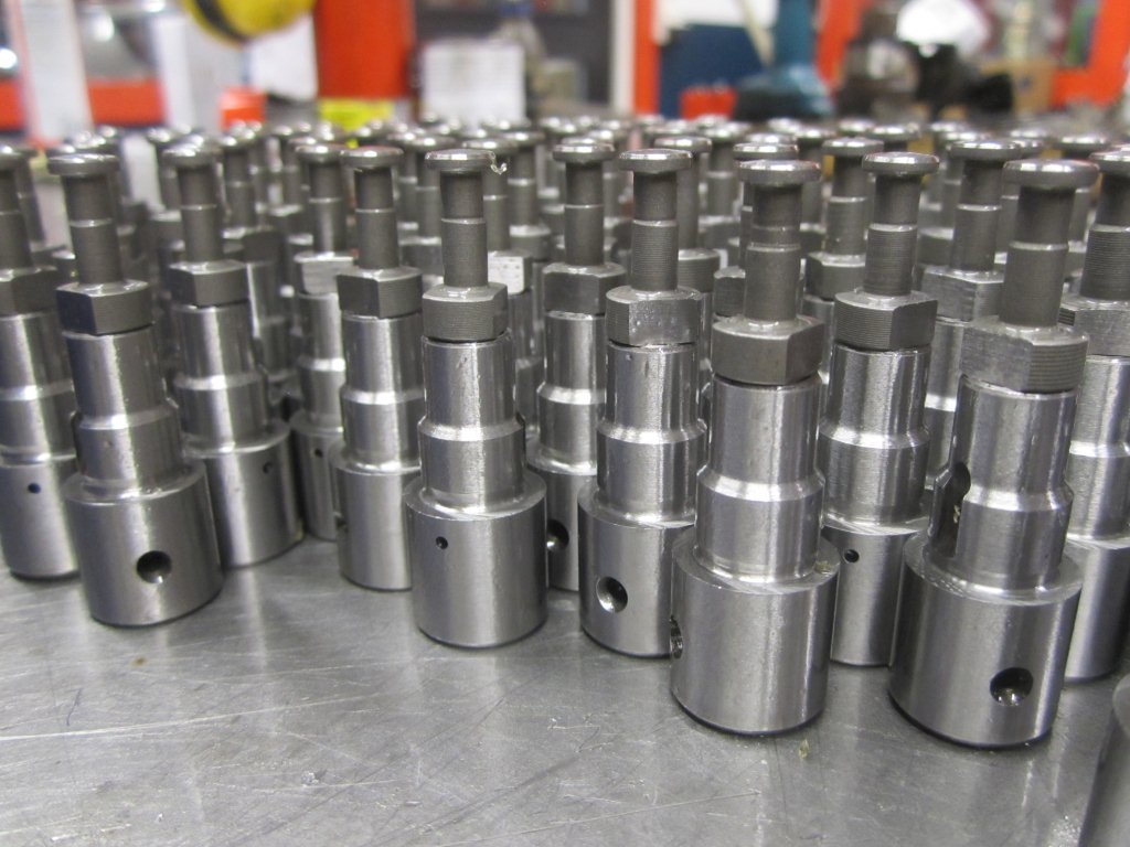

dieselmeken
407
03-21-2012, 04:09 AM #59
(03-18-2012, 10:29 AM)pp d
(03-18-2012, 12:22 AM)W126Lover So how do i get some 7.5 elements for my om603 pump?
You can always send your pump to me, if you don´t want to wait for months Wink
Soon I´m ready. Factory told me end of Mars.
This is serie 1, just to show that I really have them, if anyone doubted
dieselmeken

dieselmeken
407
03-23-2012, 07:03 AM #75
Hi Erling Thanks a lot and thanks to you all for reading my topics and appreciate my work & developing.
I must tell you all that Toms Floyd not have been copyed by me, and that I have also told Tom by e-mail. I have had contact with Tom all the way. Also I have had some of Toms element in my workshop, but for high performance engine, that is 140-150cc++ ( 170-200), they where not enough. I dont know about his superfloyd, havent seen that one IRL.
The size, 7,5 mm is the only thing that we have in common.
Reason was that Myna have 7,0 mm, I wanted something that could beat Mynä, so 7,5mm seems to be the biggest that I can draw. The diameter around the adjustingcap is 9,95mm, inside 7,50 mm, that gives a wall in the element that is just 1,23mm, kind of thin, there is a risk that the element will crack at very high rpm if I did it larger.
If I will go any bigger, I need new adjustingcaps, springs etc and that would bee to much work to develope
Toms floyd is developed to give a short injection time for clean burn, the power comes as a bonus but with a long injection time.
Here is a picture, is it copyed? Dont think so.

dieselmeken
(03-23-2012, 04:09 AM)erling66 Hi Dieselmeken you are doing a great job giving the Finns some serious competitionSmile And imagine if you can build a pump for EDH-performance that will give him 1000NM? that is the same torque as in the new AMG SL65 with a 6.0 liter V12 biturbo.
But why do you go for 7.5mm elements? Did you just copy Tomniks Floyd elements? Or do you agree with him that this is the best all around size for our engines?

tomnik
587
03-23-2012, 02:34 PM #77
(03-23-2012, 07:03 AM)dieselmeken The diameter around the adjustingcap is 9,95mm, inside 7,50 mm, that gives a wall in the element that is just 1,23mm, kind of thin, there is a risk that the element will crack at very high rpm if I did it larger.
Hey, this is exactly the reason for the "Super-" of the SuperFloydAngel
If the element with thin lower wall can make it through the heat treatment for hardening it will most properly not crack in the pump during operation.
This and how such elements fit into the pump is engineering.
Tom
